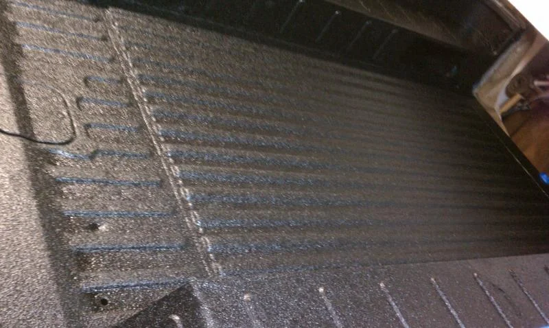

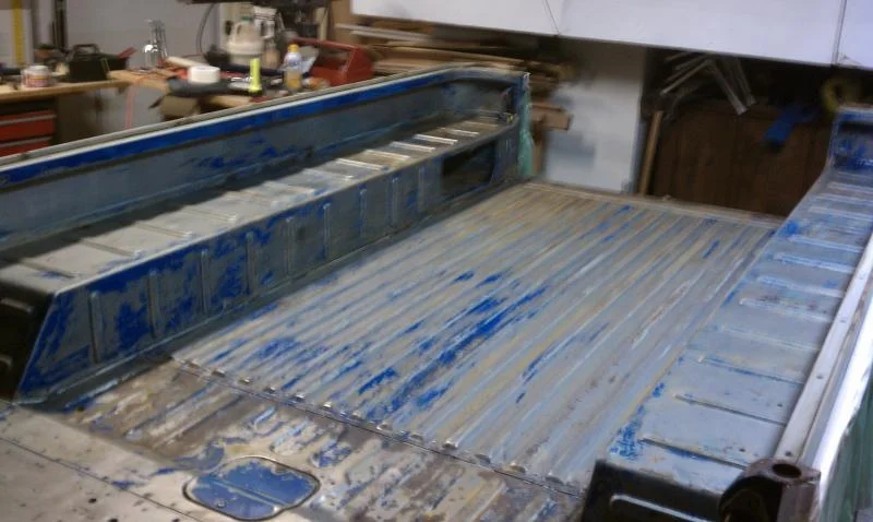

I went the full interior, paint strip, zero-rust coat and durabak. Used the pressure washer to get all the paint bits out after a liberal application of Talstrip (twice).

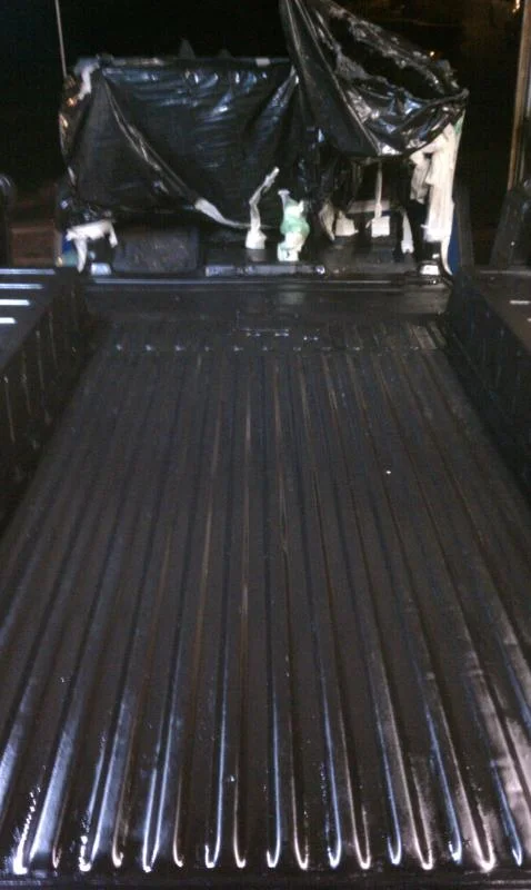

Effed up when I ordered the durabak and only got a quart (brain fart) so I bought a gallon of black herculiner and then did the grey quart over as the final layer. A little bit of black shows through the grey if you look real close, however overall I'm real stoked with the outcome. I also sprayed mine with a cheapo undercoat gun off ebay, real happy with the results and the application. Spraying is very easy. Used plenty of tarps and plastic to cover everything in the garage, over spray was easy to clean up with xylene as long as it was done quick.
stripped, sanded, zero-rust, herc, durabak
final grey layer

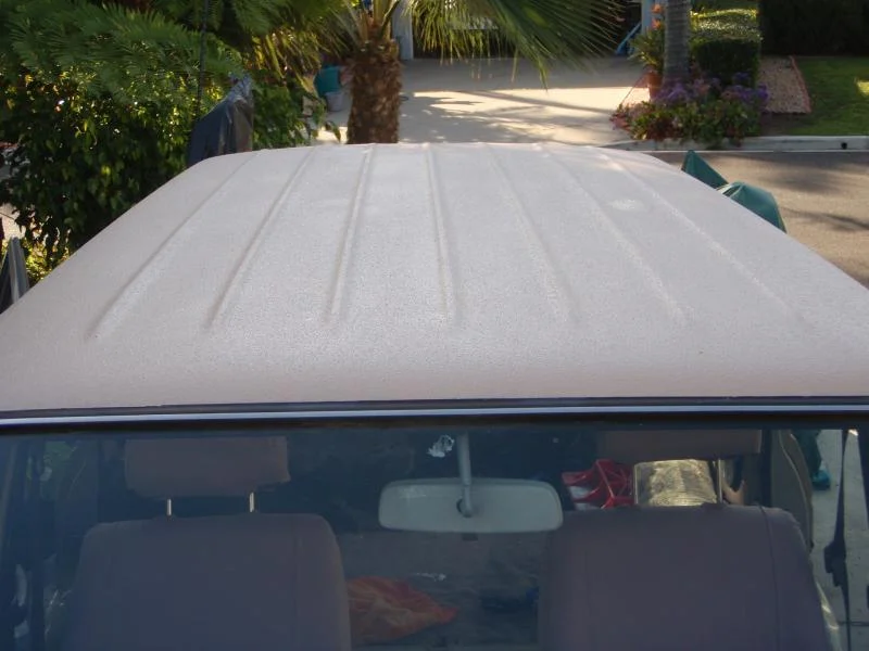

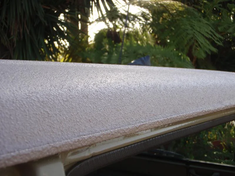

I purchased an INTI roof rack which arrived yesterday and before I install it I wanted to protect my roof and gutters from possible fuel spills from the fuel cans I know I'll be carrying on occasion.
My roof and gutters were/are in perfect condition with ZERO rust so stripping the paint and the original gutter sealant made me a little uneasy. So hopefully with the Durabak I'll never have to worry about rust.
1. Etching Primer
2. 3 sprayed coats of Durabak. Sand, UV, Tectured.
3. Close up.
