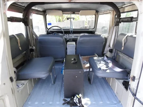

No prep pics but the finished product looks good I think. Matches the colors well with the seats. 3 hours prep and 3 hours for 3 coats of light grey.
Ben...that looks good, you are color coordinated! did you do any rust treatement (Rust bullet, etc.) or simply paint over what was there, or get to bare metal then paint? Looks like you used a roller? any brush work for corners?

Haha, glad you like it. The colors were a dead on match. The rust I had was just on the surface. Id hit it with a wire wheel for 2 seconds and I could see bare metal so I was lucky. Looks like yours is about the same just a bigger area. I went to the auto zone and picked up some brush on rust converter. Got the surface clean and painted that stuff on and let it dry. It turns the metal black as shoe polish and gets hard as a rock. Then i roughed it up with a scotch pad and rolled the durabak over it. It hasnt bubbled or pealed at all. Just amazing stuff. I did use a brush for some tight spots. Im thinking about doing the wheel humps as I have one spot of peeled paint not covered up where the jack holder goes and its driving me nuts. I also did my roof and that really turned out awsome. Missed a few spots but it looks great.
