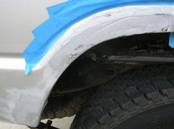

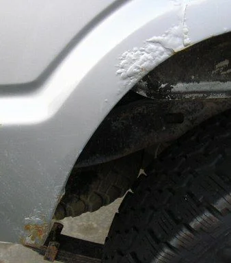

-prep body where paint is bubbled/rusted (see pic)
-fill holes/sand/prep where chrome trim was
-tape
-sand/prime (as needed)
Started raining so I figured it's time for an update...

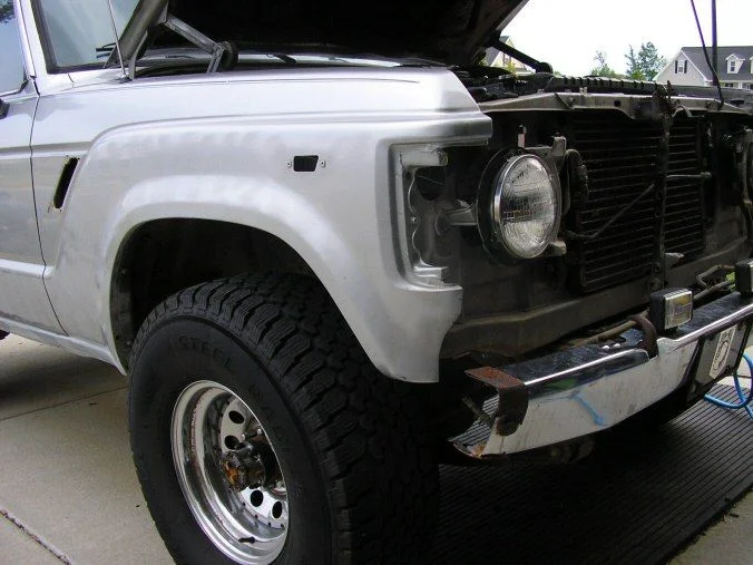

Everything is pulled off. I kept the front bumper on and took off the valence thing under the grille cuz the front bumper wasn't going to come off any time soon, so I will just durabak that valence thing off, then bolt it back on.
Everything is sanded down and all holes have been plugged with metal bondo. All I need to do now is tape, final sand, xylene, then paint.
I will probably black out the "Toyota" on the grille while I have it off.
Here are some pix, more to come...

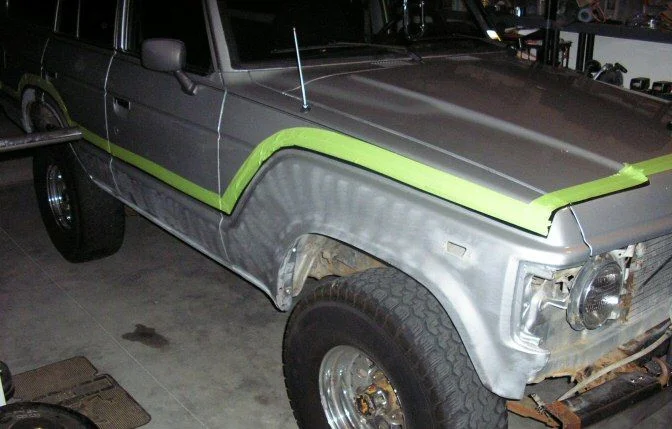

PREP DONE:
First layer of tape is electrical cuz it follows curves much easier. The next 2 layers are green 3M masking tape.
All the areas are sanded with 80. I will xylene tomorrow when I am ready to paint.

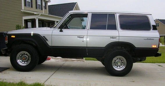

This coat again took me about 25 minutes. So total time is nearly 2 and 1/2 hours of curing time. I immediately went to remove the rest of the tape EXCEPT the last layer of electrical tape.
I was getting nervous that the durabak may have cured too long and that the tape was going to pull it off...it didn't.

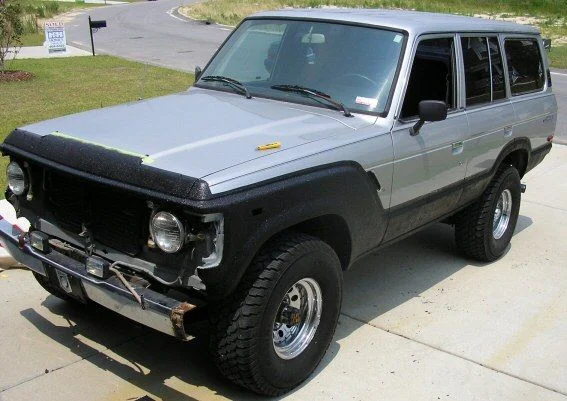

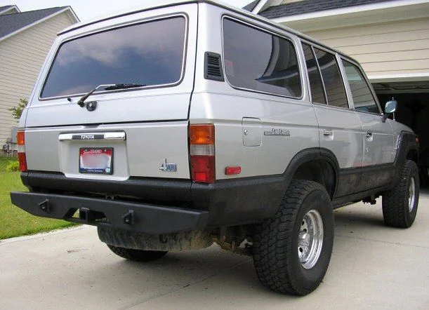

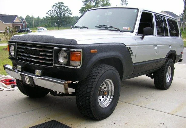

Final coat, all tape but electrical tape pulled:

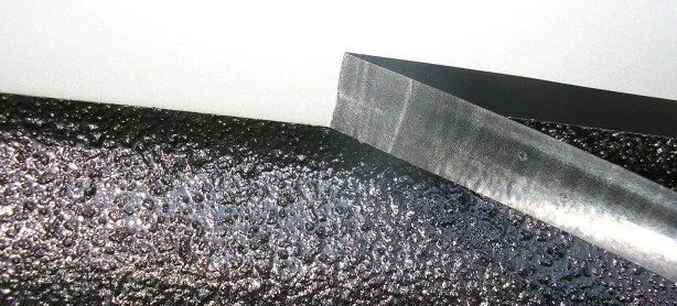

REMOVAL of electrical tape:
By the time I got all but the last layer of tape off, the 3 coats had been curing for about 3 hours in hot, humid NC. I thought for sure the electrical tape would pull all my work off...it didn't.
And the "ledge" people have mentioned is so very small even after 3 coats. Don't worry about it.
Just went slow and smooth.
