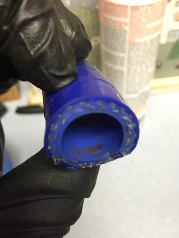

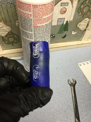

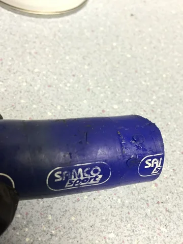

Cool. Is the silicone preferred for this over the Gates Green Stripe. I've heard conflicting opinions.
Everyone weigh in! :)
Here is what my silicon looked like after only 5 years. Some bulging, and deformation. Could be because of the aforementioned breeze clamp being over torqued.

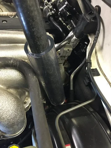

I reinstalled with a gates green stripe bypass and reused a stock spring clamp. I used a section of 1 ¼"inside diameter tubing to act as a conduit where my new bypass hose ran next to the intake to prevent chafing.

You used standard clamps, you need sleeved clamps so the clamps won't cut into soft silicon. As you can see in your picture the inside of the hose looks new. Also don't have to make it super tight.
I used the breeze clamps that came from PHHkit.com. At any rate, there was a small gouge inside of the samco hose. I think it was pinched when I was placing the hose back on the hard bypass tube and bent it into place when reinstalling onto the block. Just my experience.
