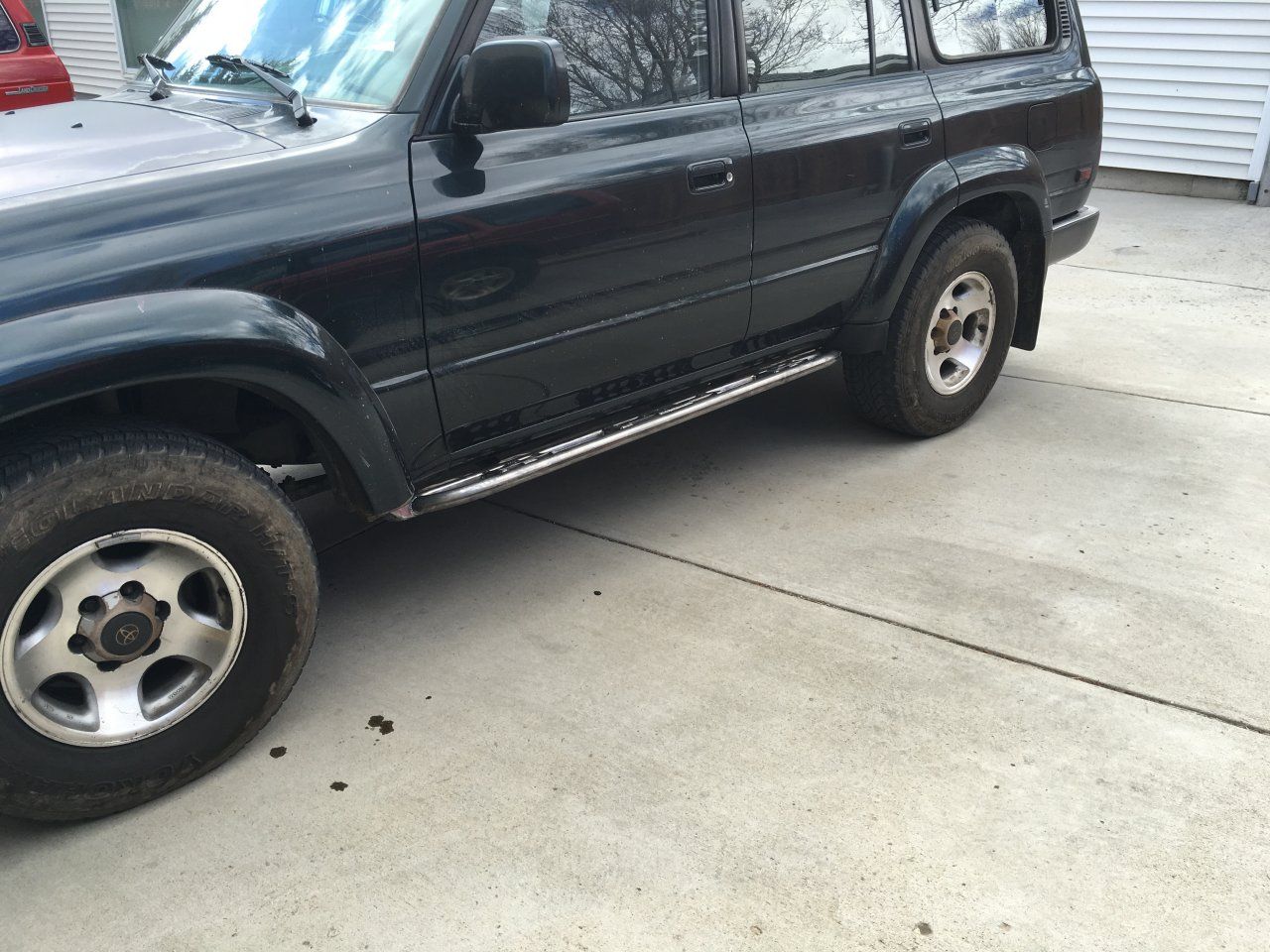

Before
After
Shout out to Trail Tailor aka Jason aka @reevesci for the sliders!
More pics if that mounted slider! I want to see the angle compared to the step. How much foot can you get on it when you climb in?
Plenty. About 2.5" is my guess. (Insert joke here).

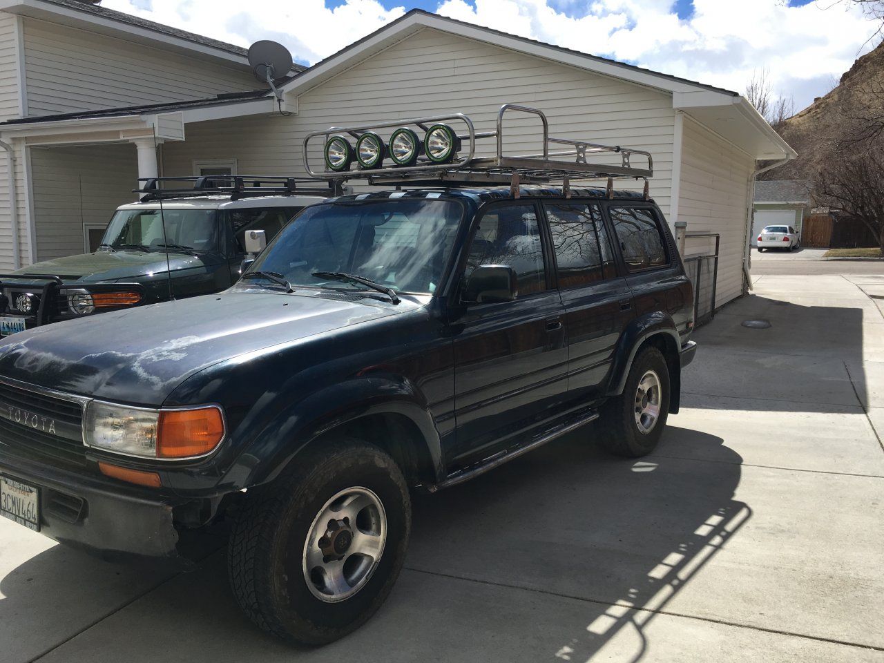

New hat for Mollie. Inti clone. With removable crossbar for kayaks.
Forgot to take a pic of the slide out with the rack on the roof. Locking solar panel slide out. Pretty boss move if I do say so myself.
3.25". Jason said he can make them however you want though.

How did you take care of the roof after removing the factory rack?
Tell me about the considerations that went into the design of that rack. I'm specifically curious about:
-high sides at the front. Edit: Inti clone?
-bar welded at 3/4...maybe farther back? Edit: cross bar for kayaks?
