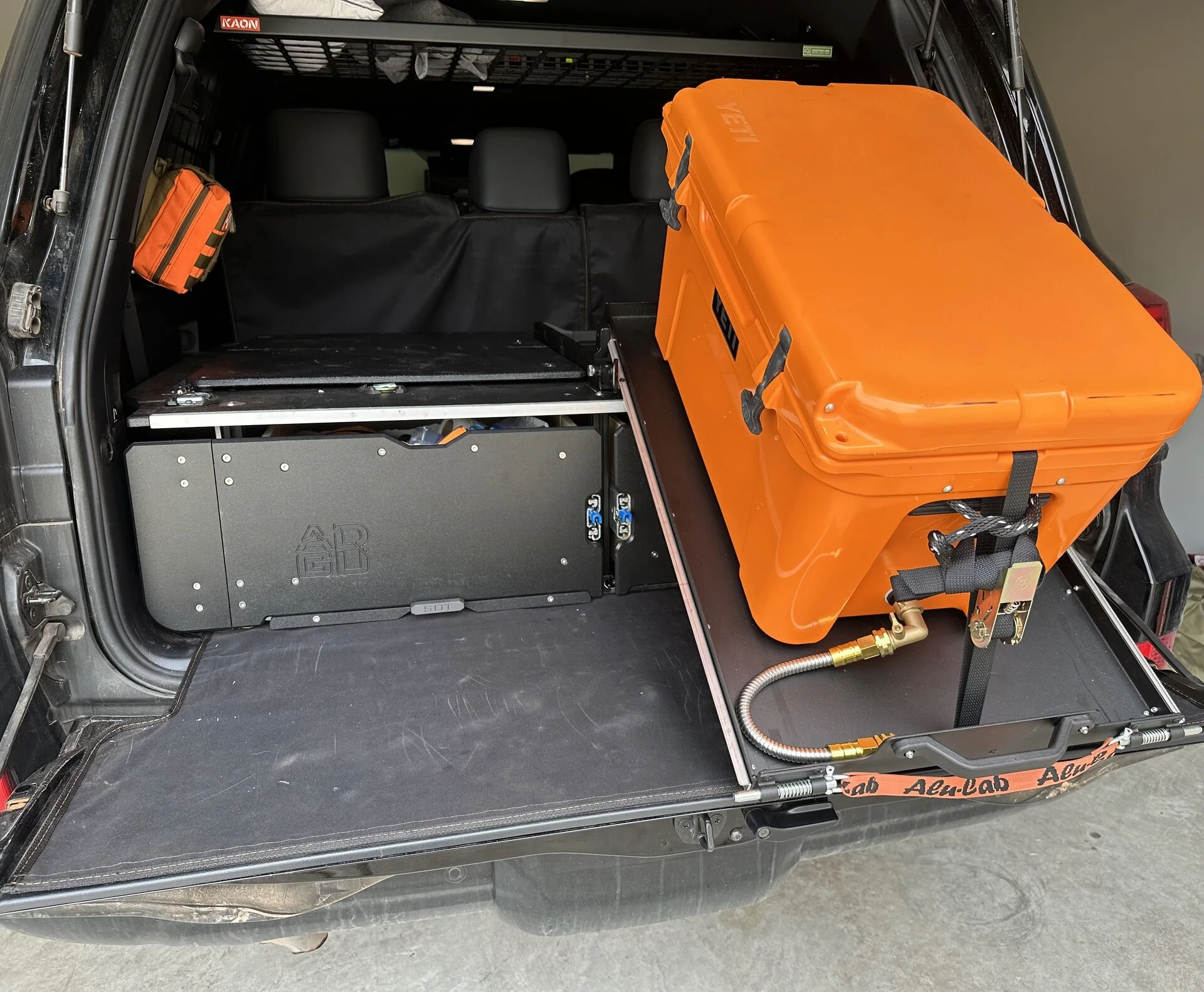

A recent trip has reaffirmed my desire to figure out a better cooler setup until I bite the bullet on a fridge. When I take a big trip I typically will bring my 65qt Yeti and loaded down with food, drinks, and ice it can easily weigh 70-80lbs. My Kaon shelf gives me minimal clearance (~4-6" opening) to try to put things in and pull out, the elevated position on top of the drawers means lifting higher, and the absolute pain it's become to drain the excess water when topping off ice. I figured if I was going to do something now, it needed to be future proof and work with a fridge once I go that route. I looked at a number of slides: Clearview, MSA, Alu-Cab, DFG; I ended up deciding that while a drop slide would be super cool, as someone who isn't terrible tall I get a much better view and access with a tilting slide. I really liked how the Alu-Cab had a solid tray vs. something like the DFG which only has a platform for the feet in the front and back sections with nothing in the middle. The Alu-Cab lets me put any cooler that fits within the boundaries inside and is properly sized for the fridge I will likely get in the future. Luckily my ADGU drawer/sleeper system came ready for a 50% setup, so a handful of bolts to remove and I converted it to a driver side only sleeper so that the slide could be mounted on the passenger side.
To further increase the ease of use I got on Amazon and grabbed a few parts: Yeti drain plug hose adapter, a 90 degree adapter with shut off valve, 1ft flexible hose, and a hose cap. I thought the cap might be overkill, but after testing it for a couple nights I discovered either the hose will hold just a bit of water after draining or the valve isn't 100% perfect. Either way the cap keeps things tidy. This will now allow me to tilt the cooler down, dump the hose over the tailgate and drain any excess water without needing to remove the cooler. I think this is probably about as good as it will get for me until I go for a fridge and stop messing with ice entirely.

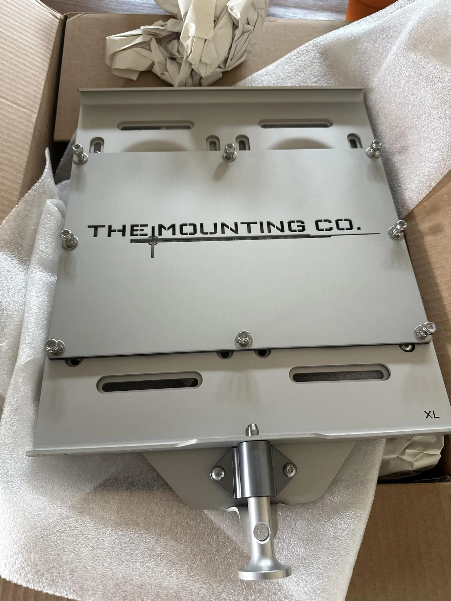

I stumbled across The Mounting Company who makes some pretty slick and super high quality quick release mounts of all sizes. I sent them a message to determine what size mount I needed and received a call back from the owner of the company himself and we discussed my setup and got the appropriately sized mount ordered. It will require new holes to be drilled, but comes with a much nicer gasket to ensure waterproofness. If you aren't familiar with their mounts you put a plate with pin bolted onto whatever you'd like (my rack in this case). Then you install an outer plate to the bottom of case, drill holes and install a plate on the inside so that the case is sandwiched between--those will stay on the case permanently. I have a bunch of orange accents around my car so I decided to drop it off at powder coat yesterday to get it in a matching signal orange powder. Should have it in hand next week so I can get it all mounted.

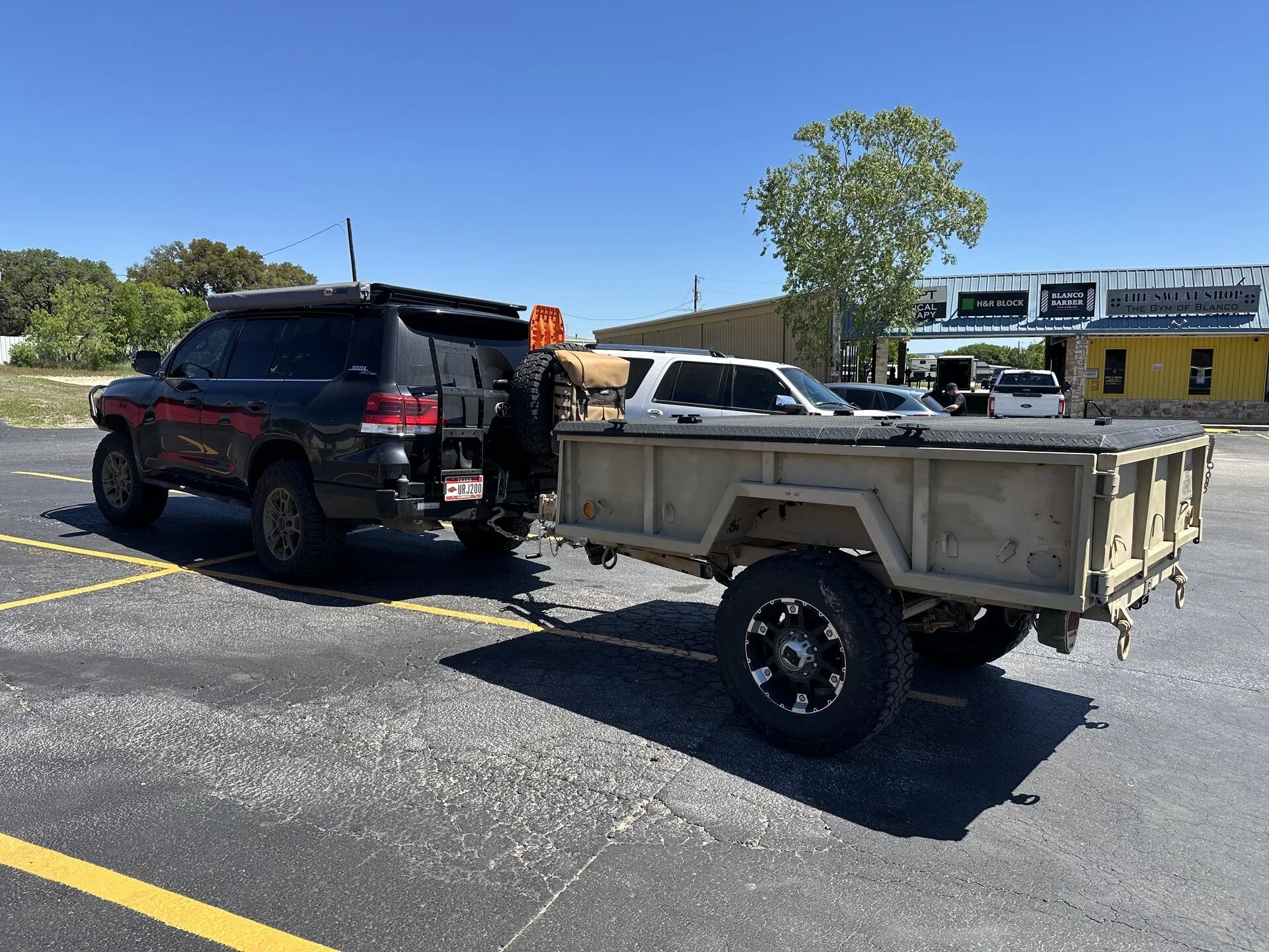

The trailer has been picked up; I had found this M101A2 on Facebook marketplace pretty far south of me. As luck would have it my wife and I had a quick anniversary trip planned to the Texas wine country and this was almost directly on the way home. I wanted a lockable trailer to take hunting and not worry about in hotel parking lots along the way. This is perfectly setup for it. Won’t get to in depth as I’ll do a build thread in the trailer section, but hoping this will solve quite a few storage and camping problems for me as well. Yes the wheels are absolutely at the top of the list for fixing

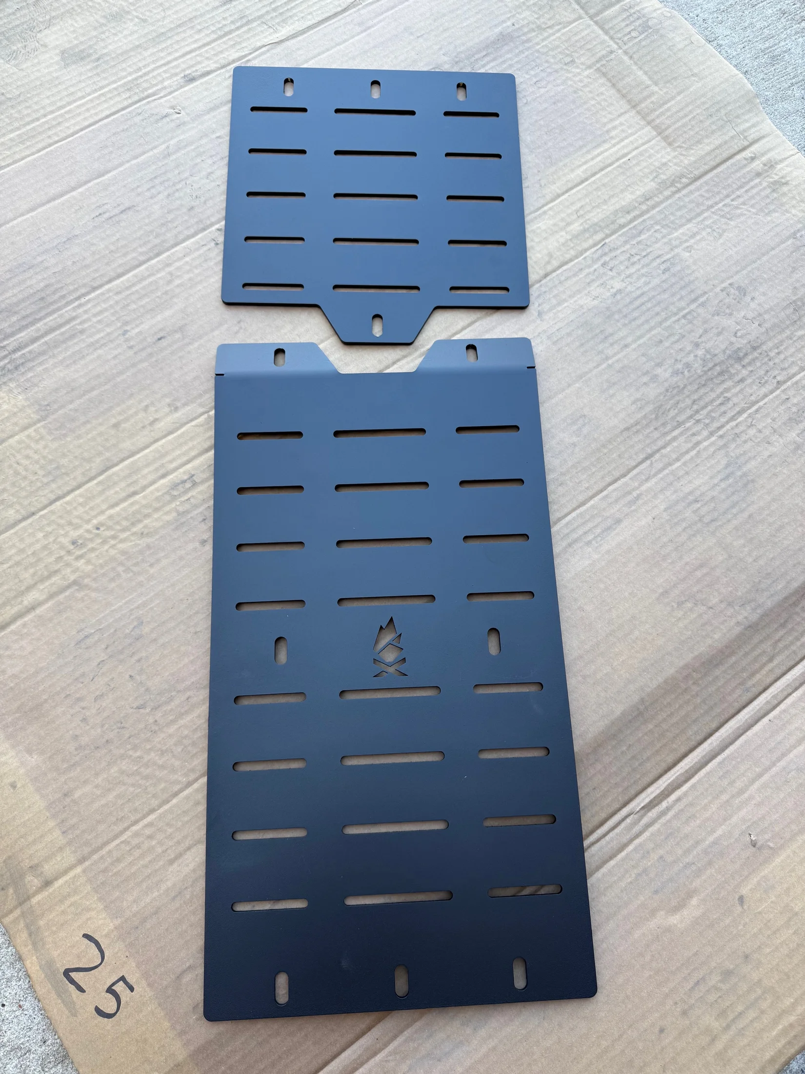

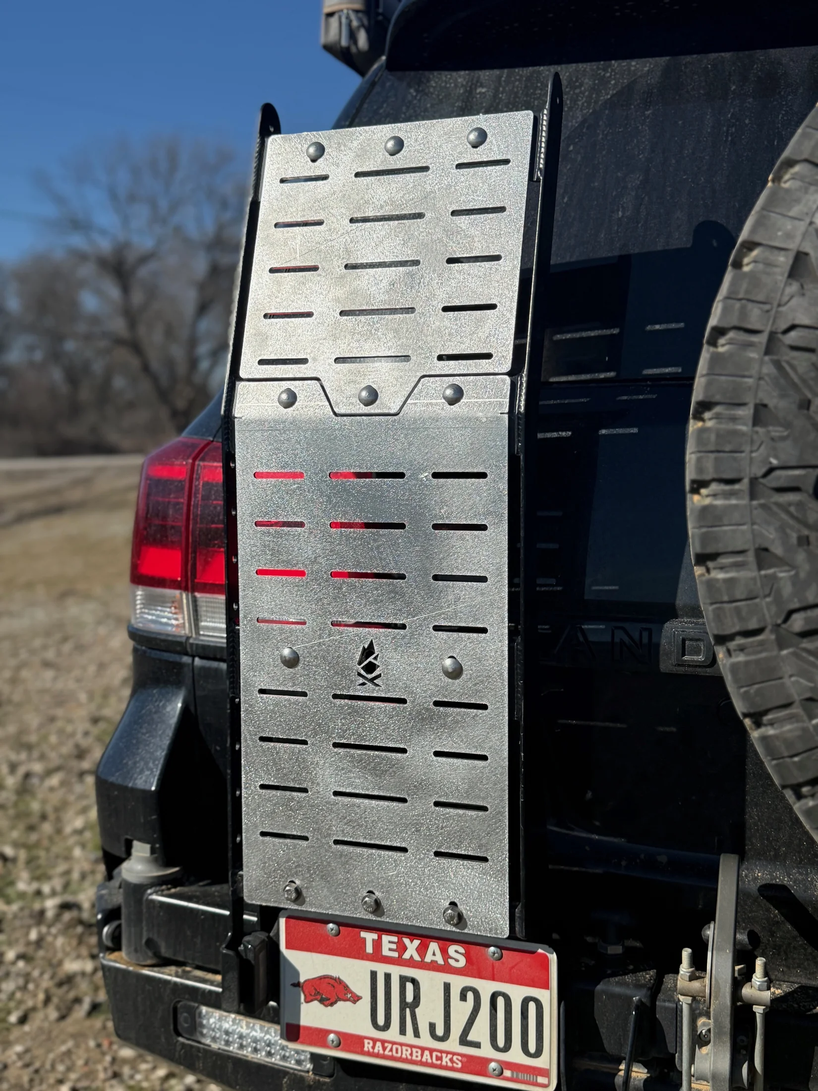

My friend and I finalized the design of the ladder panel I had wanted. It drew some interest here and across some Facebook groups so I had a run of 25 made locally here in Texas and they are for available: here or in the link in my signature below

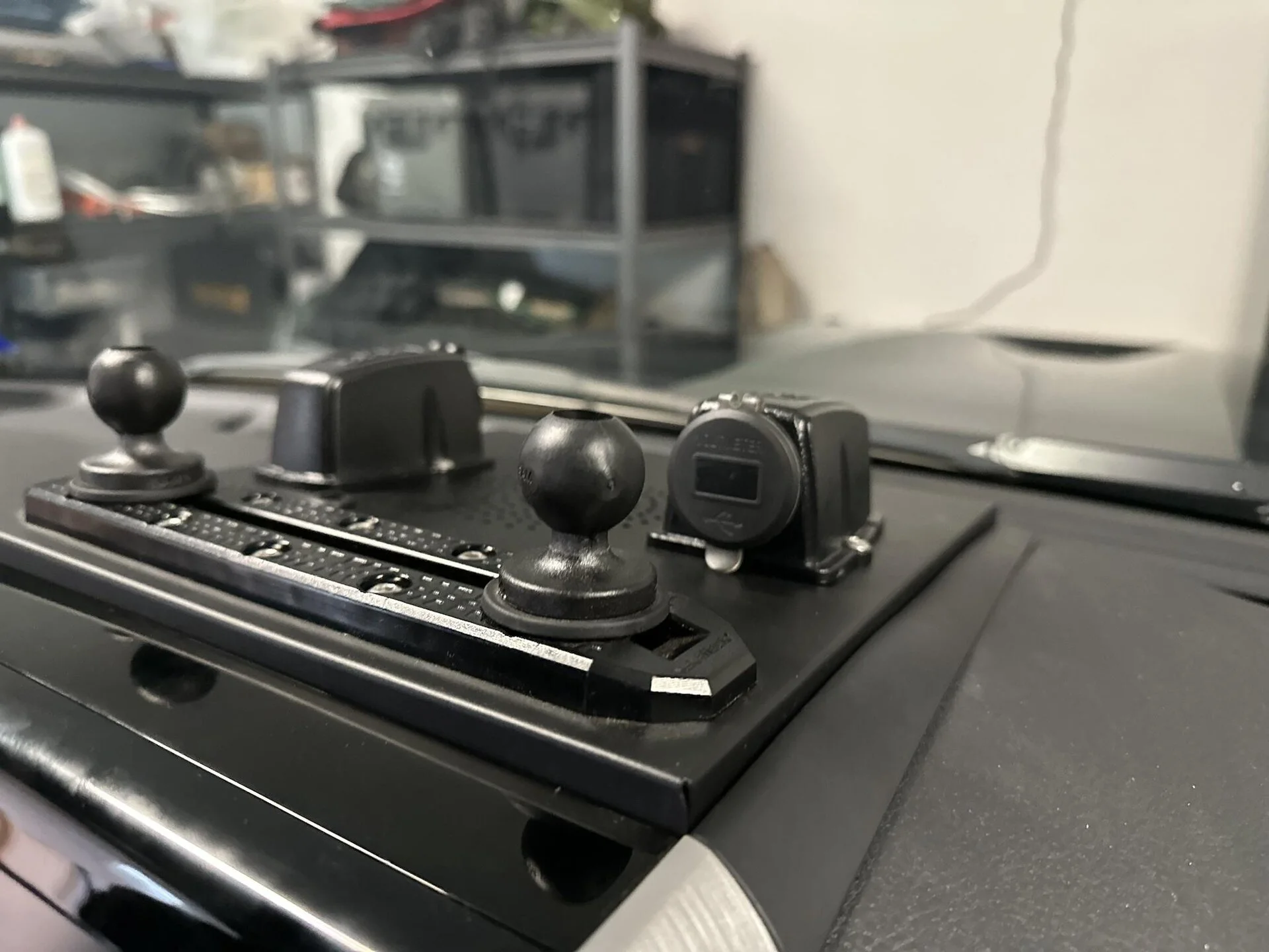

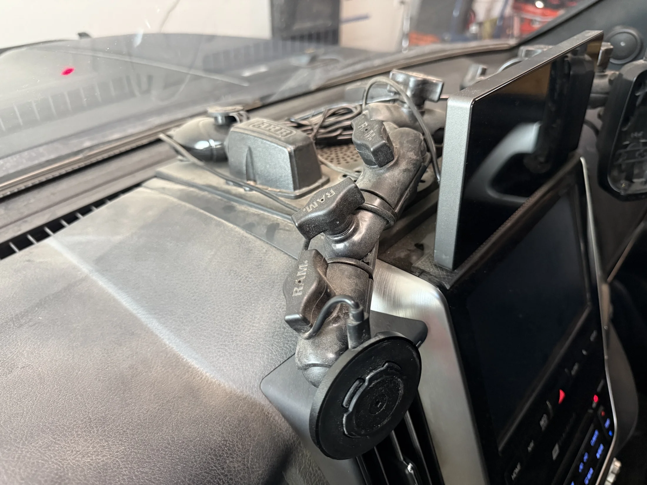

what mount are you using for your phone? Is it attached to the gamiviti plate?
Quad lock charging mount on a Ram arm attached to a Ram ball fitted into a track made by Yakattack
Please forgive the dirt and dust
Perfect! I was already looking at the quad lock and have the ram mount. Very helpful. Thank you.
