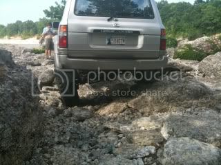

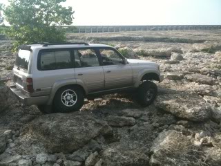

So I knew I needed to take off running boards but for daughters sake i left them for now. Well trails made decision for me! After these pics I got some questions for folks but enjoy minor carnage first. As I mentioned the trail was pretty rough and tough in spots and we didnt get good pics at all of the good stuff!:crybaby:
Some more, I had to pop out panel beside door in order to open my door! wasnt planning on destroying side steps but it happened!
Last group of photos, Hannah my beautiful yet offroad numb girlie decided to run into tree clearly 2 feet of the trail and give truck her first scar, not bad, but enough to make me think bumper in order! Sliders are also most definitely in order also.
All in all I love the truck and so does the woman! She even supports the build up. The tires didnt lose grip much at all, I wasnt aired down either! Things in the must do list are rear storage and sliders. Now a couple questions?? These 2 weeks have given me good idea how I want to go with build!
?1. I compressed shocks, didn't take any effort to compress, that mean they are worn out? I didn't install them so running stock for now?
?2. The trim above the doors on the rain gutter thing. Is it neccasary? I bent it up in branch, just wondering if I can remove it.
I will be romoving door panels and fixing and checking on all windows when I get back again figuring as how i knocked both rear ones of track somehow. Finishing fluids and tune up. Here in next couple days I am going to compile more detailed list of what I will be doing figuring I have some more perspective? Looking forward to more building and more wheeling!
