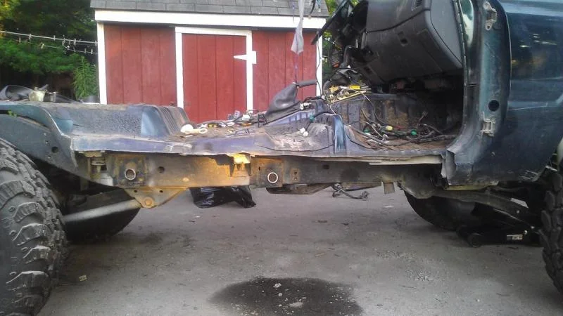

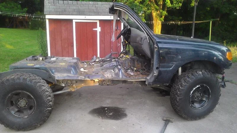

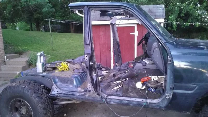

so i was gonna keep the cab part then decided not too. Got one side of the rockers chopped off. Not final cut but close, still pondering on front fenders, probably take them off tmrw and see what im working with.
Im toying with idea of sliders that work theyre way to front bumper. Probably not, i want to keep her light.
