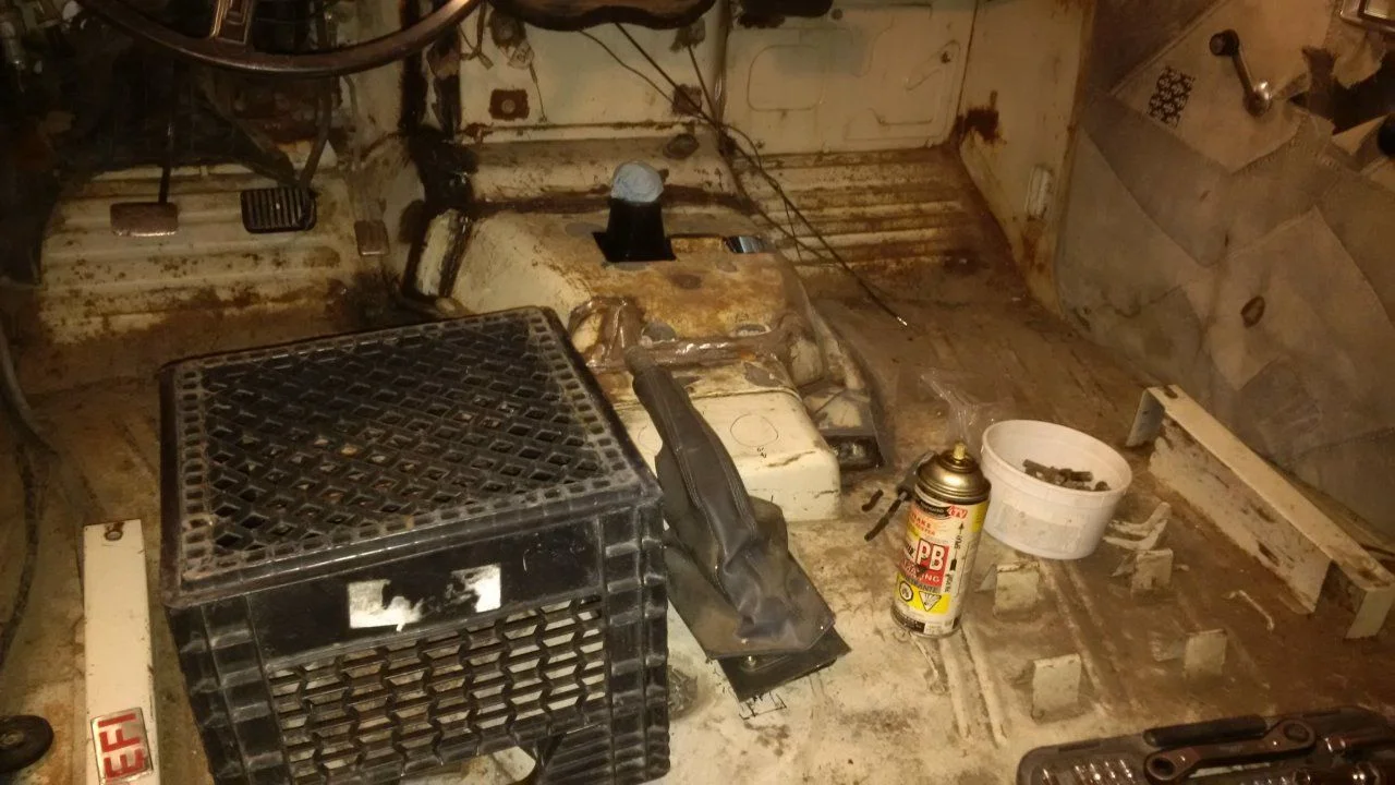

Photo evidence of more slow progress. Engine and transmission out to allow access for "sheet metal quilting" around the firewall and tranny hump.
Piecing finally done. Should be nice enough weather tomorrow to open up the shop and burn all the seams in with some ventilation. Next up (I think) will be to work over a spare head and manifolds to swap on the engine. May as well make this one ss grunty as the one in the 62.
