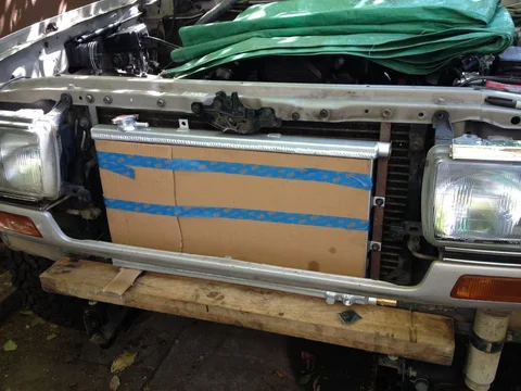

The picture above sure makes it look like the air flow is blocked and restricted?
Thermostat, the big "secret" with these from what I am reading is to get the largest amount of water volume as possible. There is now a huge water tank in my friends passenger side rocker/frame space. Run the biggest lines possible (1")

Did you go with the ebay setup and source your own rad?
Probably reinventing the wheel a little but I'm going to experiment. The rad is from eBay 24x12x1.25 or so. From reading a bit it seems the heat exchanger is more of an issue for w2a than the size of the intercooler. I'm starting with a smaller rectangular intercooler also from eBay.
This is all part of a 1hd-t/manual conversion so results will be slow to come. I'm also adding in the turbo parts that @ForealBoreal came up with
