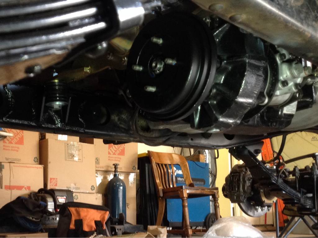

Well, the drivetrain is in. Only significant interference problem is I can't get the oil filter out with the parking brake cable the way it is. It will be fine for the time being, but I may relocate the oil filter housing.

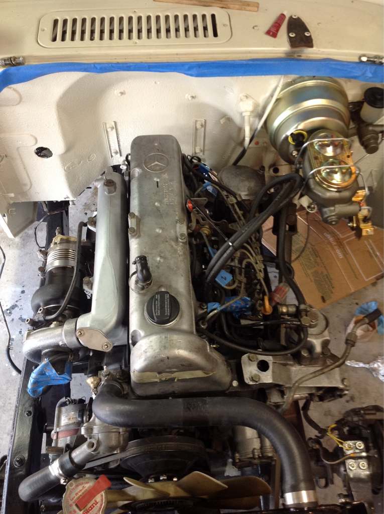

Also got the brake master bench bled and installed along with the clutch master and slave.

that engine looks sweet. what injection pump do you have on it? mine was a north american td300 that it came out of but my emergency shut off "stop" button had all sorts of links and was sitting on top of my valve cover. yours seems to be sitting off to the drivers side which is where the euro non turbo pumps sit. less linkages and a cleaner look for that pump.
My oil canister hit the firewall quite a bit in the stock location, I think you went with firmer mounts which may help (stock allow a lot of movement). Looking good -

Oil canister has plenty of room, just can't lift the top off since there's that rod inside that centers the oil filter. I hadn't cracked it open for a long time so I forgot that it existed...whoops
I'll have to check for the pump numbers. It's definitely not a non-turbo pump... All the linkages that we're sitting on top of your valve cover were for the cruise control, etc. I just removed all that stuff, but I'll use the linkages to rig up my throttle cable.

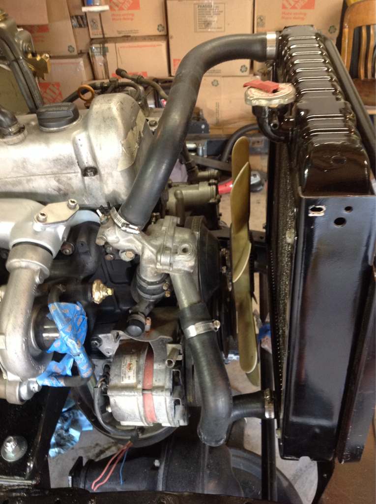

Made some progress this afternoon. I bought a bunch of aftermarket flexible coolant hoses, but didn't like it. Turns out the MBZ OEM stuff fits like it was made for a Land Cruiser. JACKPOT! When my dad was out to visit, we noticed the fan was pretty close to the radiator outlet, so we made a jig and shortened it by 1/2", which shouldn't hurt any cooling effect.

The fan isn't as close as it looks, I've got a little more than an 1" clearance, I hope it's enough.

The fan does not look exactly parallel to the rad--don't know if that is a prob or not
