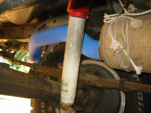

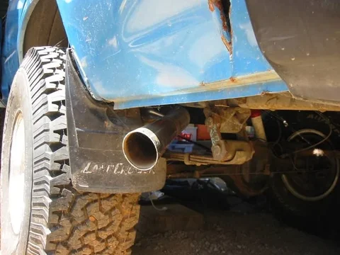

.... there maybe issues with articulation, um ... LOL.... but ..... must...keep...movin'... ON.... Trade-offs. Bottom line objective is to drive off and get RastaRig in my driveway, not located in a town that is 40 minutes each way ... to just drive out to. And, I still have to do something with these springs---they're all flat with no additional leafs and nothing ever been done to put some arc back into them so I'll probably be needing to modify the tailpiece down the road.

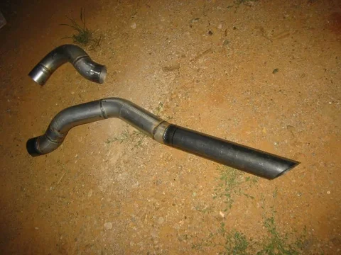

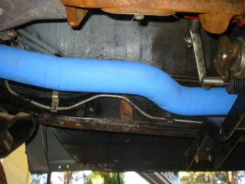

Man, that exhaust was a bunch of work and welding!

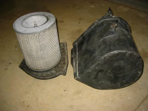

dont' know what kind of radiator fan you have...but do you tihnk you will have a problem with the fan slinging dirt and mud all over the air filter? When off-road?
