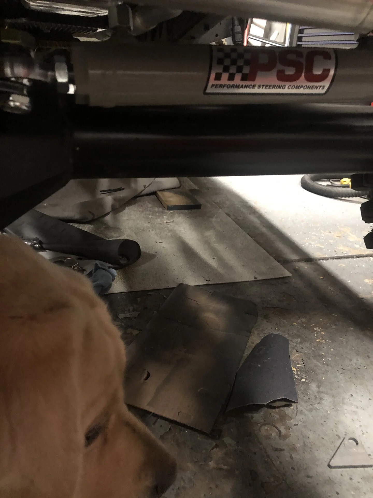

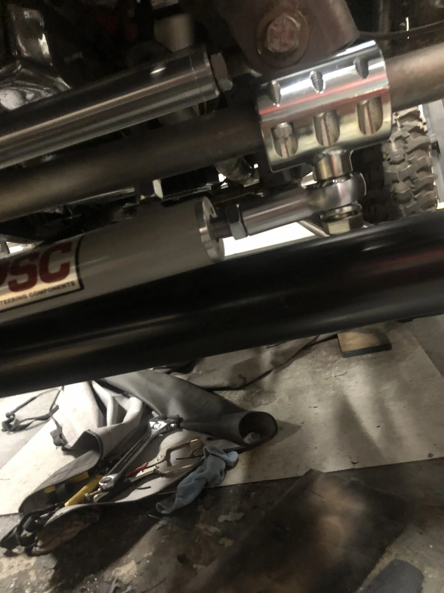

Ok enough crying it time to get back to work 😃. Somewhere in the very back of my mind I would like to maybe try KOH with this Just a dream but not impossible 🤷‍♂️. With that said and what others have said Hydro assist it is 👍. Question does it matter if I go to the tie rod 🤔. Or do I have to go to the drag link 🤔. Also I received the correct switch panel. It’s for the ash tray but I am going to use it on the tuffy box. I can’t reach the ash tray when I am strapped in .

I ordered a RedHead steering box That is ported for hydro assist so that is coming .
