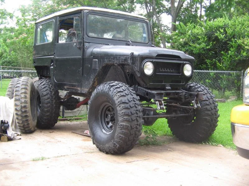

I am building a 1971 FJ40. This project has gone from being a frame off restore to a rockwelled rock crawler that my wife hates with a passion! Let me tell you what I am going to do with my cruiser and let the input come forth.
Powertrain
-stock f-type soon to be 472 with 620 hp
-stock 3 speed tranny soon to be th400
-stock t-case soon to be np205
Drivetrain
-front and rear axles are steering rockwells
-Ouverson mini spools in both
-Full Hydaulic steer (front and rear) same set up as Jeremiah Proffits Lizard, minus the auto centering
-Pinnon Brakes from DIY
-2" DOM .375" wall tie rod with 1 1/4" Heims
Suspension
-4 link front with all 2" DOM .250" wall links (uppers and lowers)
-4 link rear same as front
-front - 2.5" FOA remote resevoir coil overs 16" travel
-rear - 2.0" FOA remote resevoir coil overs 18" travel
-all brackets from Ballistic Fab..(top hats, link mounts, coilover mounts)
Protection
-Metal tech full family cage with extra braces
-metal tech bull gaurd and stinger welded to frame
-Boat siding with 1.75" hrew and running fender exo.
Wheels and Tires
-Michelin XL 14.00 x 20 ( 49" tires)
-5 ton military double beadlocks with inserts, recentered to rock pattern. (20" diameter)
This is my first project, besides the build up that I have already done on my cruiser, which was a soa with flipped springs and 39" Irocks. I am not the best welder in the world and I have had most of the welding done by a friend that has welded in a plant for the last 36 years, but the rest I am going to do so hopefully I dont get made fun of too much! This probably wont be the last thread that I do seeing as next year when the new powertrain goes in I am also going to back halve the cruiser.
here is a pic before I get started, more to come.
