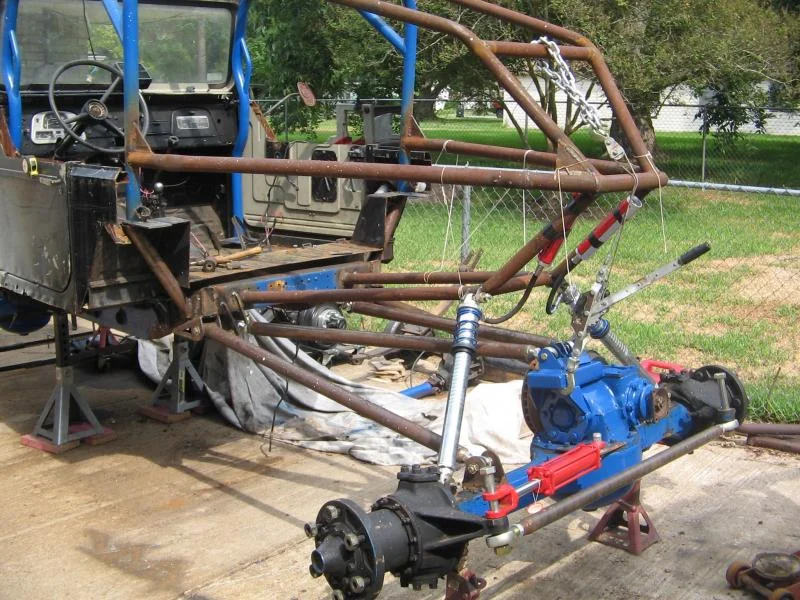

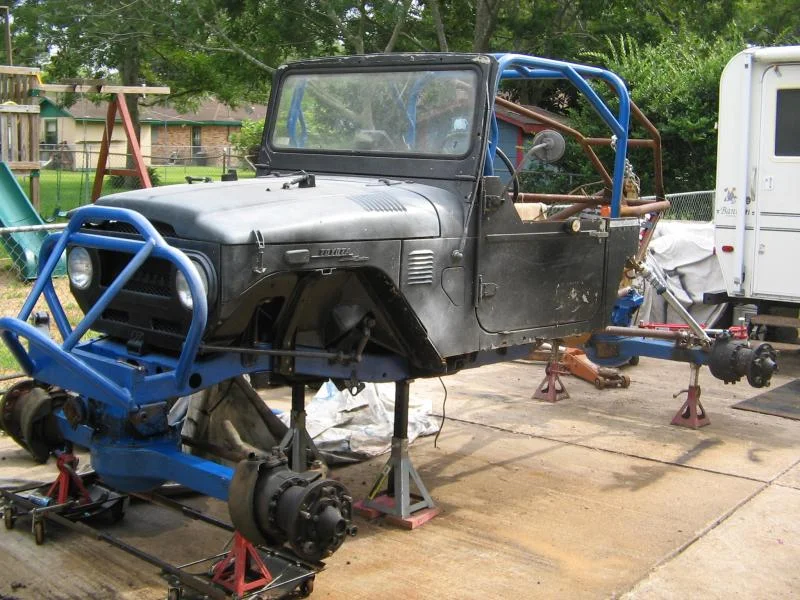

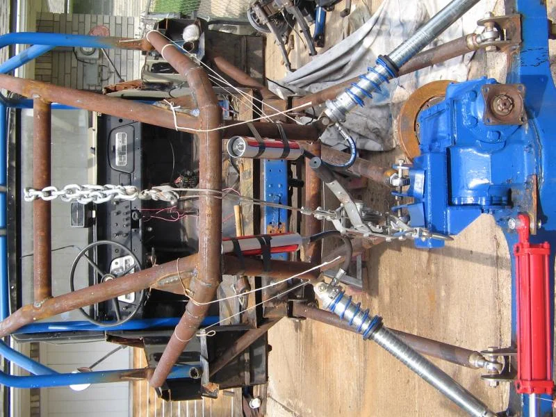

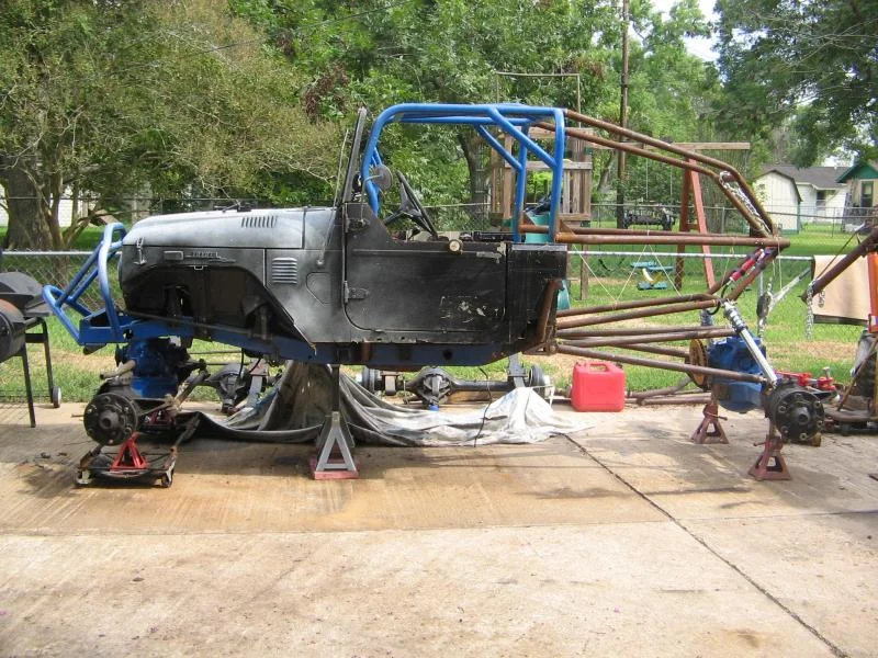

I finally finished backhalving my cruiser today and linking it up to the rockwell. It only took me 3 different configurations of link set ups to get it right. the hardest part was trying to get the links to converge in the middle of the axle without getting in the way of the drive line. I took some pics today so I will get them up in a day or two.
i have alot more pics on my other camera but they wont load up. so i took these with another camera. this is of the vehicle in full compression, with a wheel base of 145 1/2". havent linked up the front yet, just mocked it up.

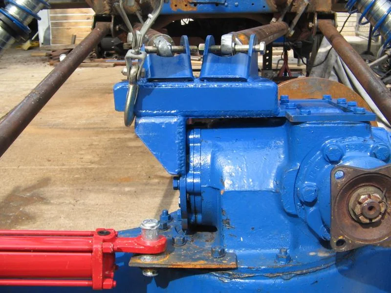

here are a couple more, and i know that my ram is broke on my rear axle, tried to put the pin through and the clevis ear broke off, hopefully tractor supply will take it back!

have you run the #'s on your link setup? it looks in the last pic like the upper and lower links converge at the frame? in other words the link brackets are on or very close to the same horizontal plane? i'm no expert but i think that might give you some pretty bad anti-squat problems
yup! i am gonna have about 1 deg. squat but my front end will be 3 inches lower than my rear, it will also have 2 less inches of travel in the front.
You planning on those shocks doing anything in the rear??
Just like Mookie, I am curious about your suspension numbers. 1 deg squat????
