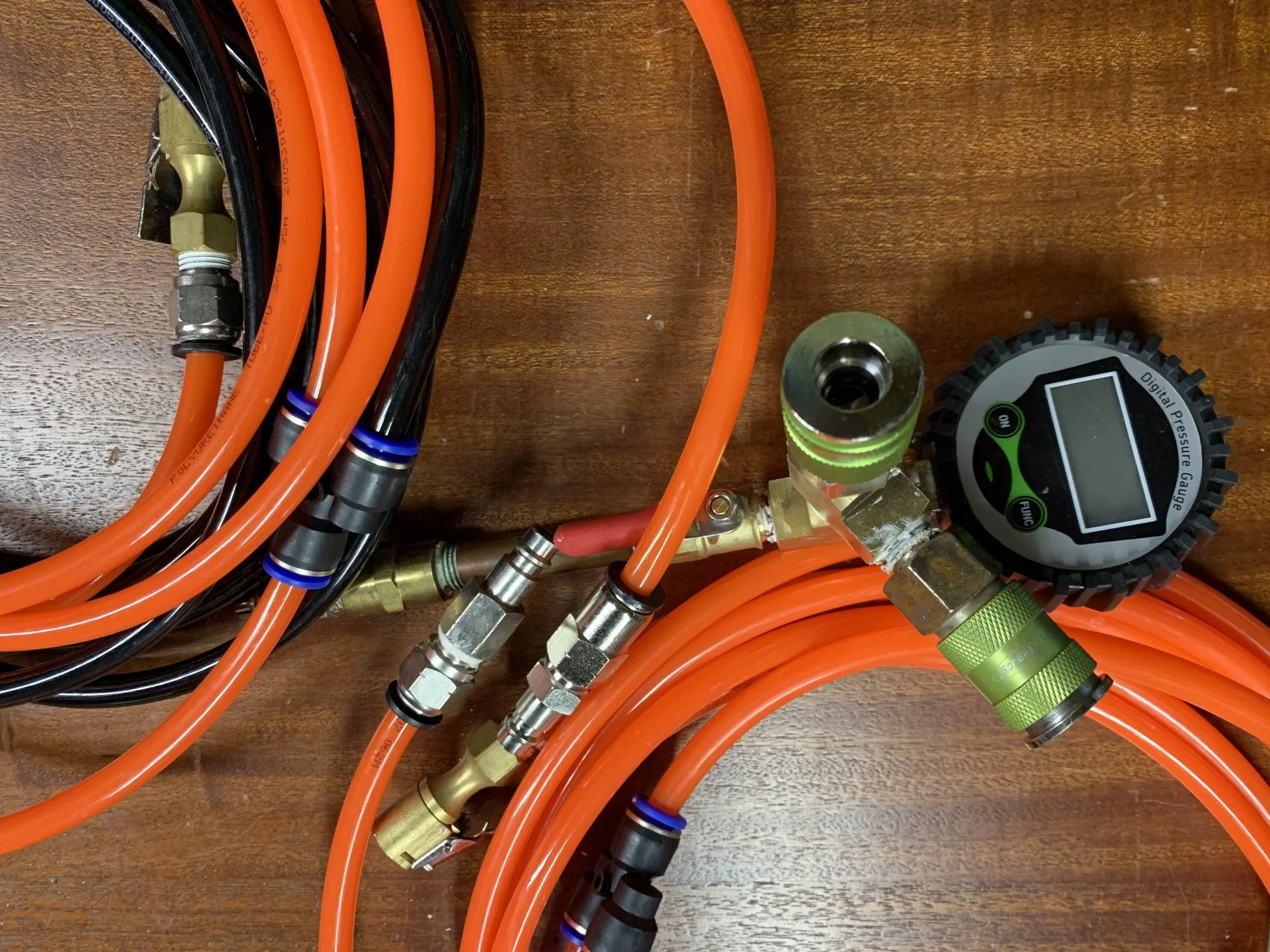

After much deep thought realized that a 'tee' was the same as a 'manifold'. Had to buy one more flexzilla quick disconnect, repurposed some fittings from the fitting bag and found a tee in there too.
It's a $14 mani-foldy.
Now I’m definitely big-time.

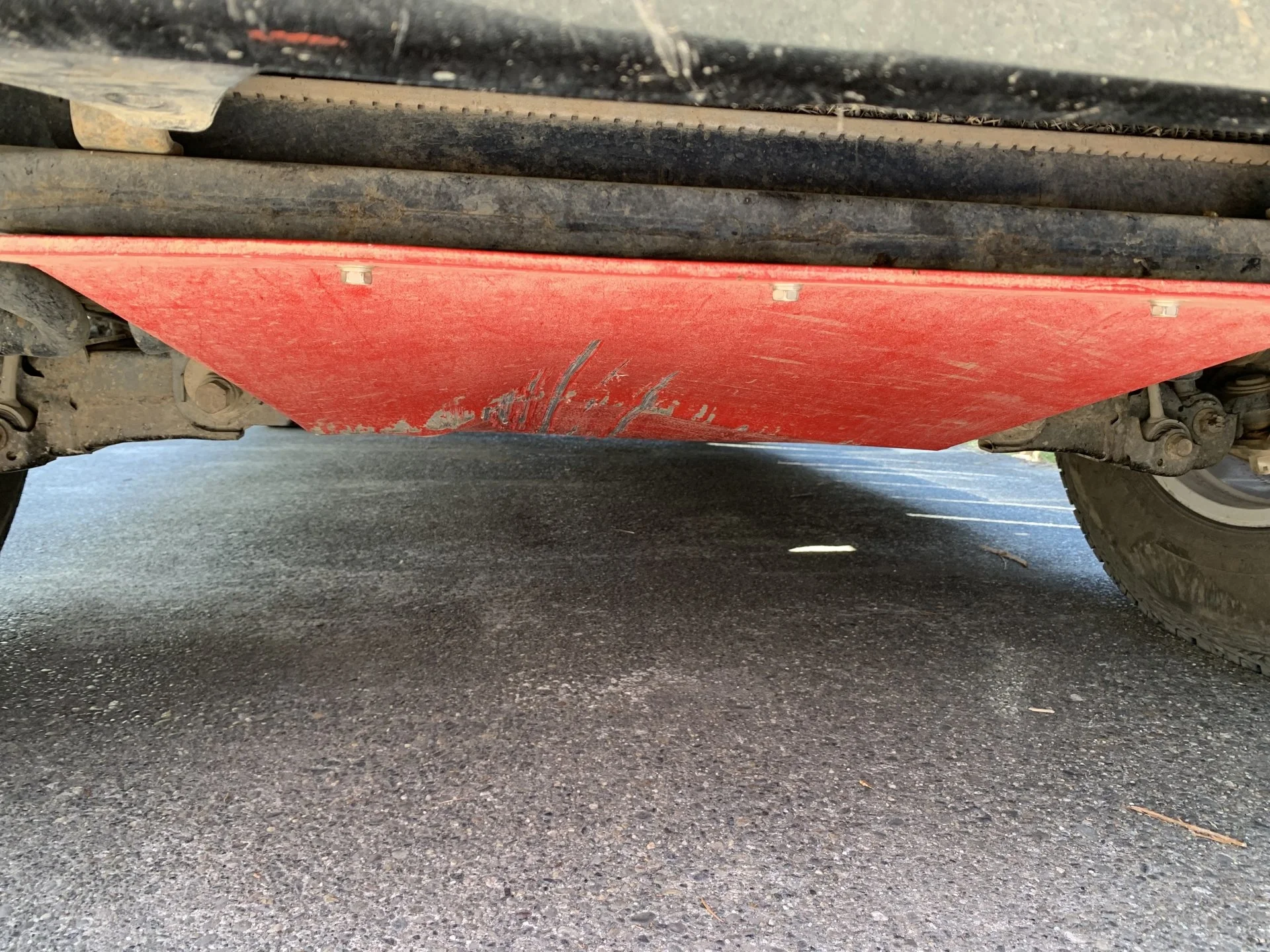

removed my skids

removed my skids

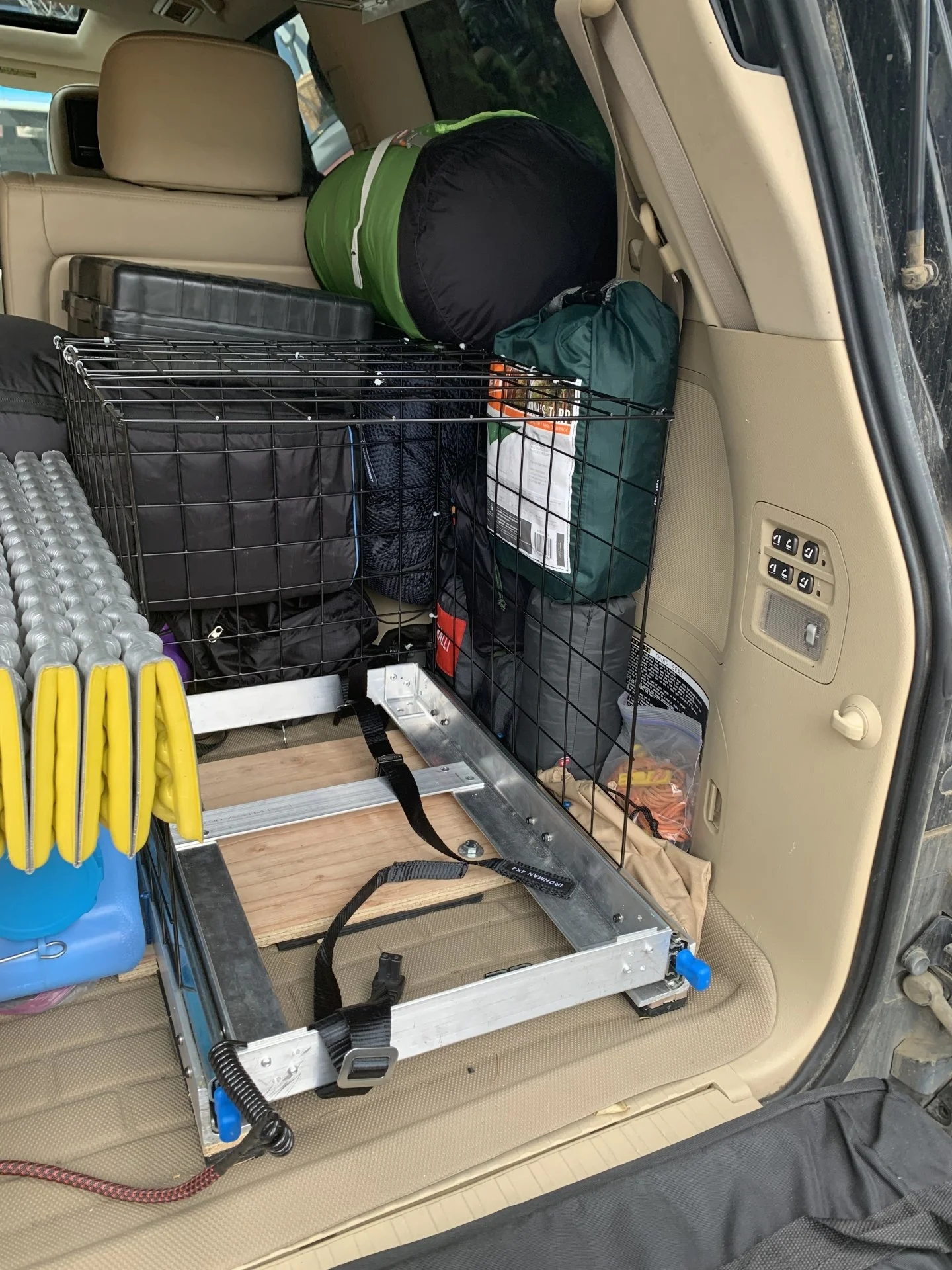

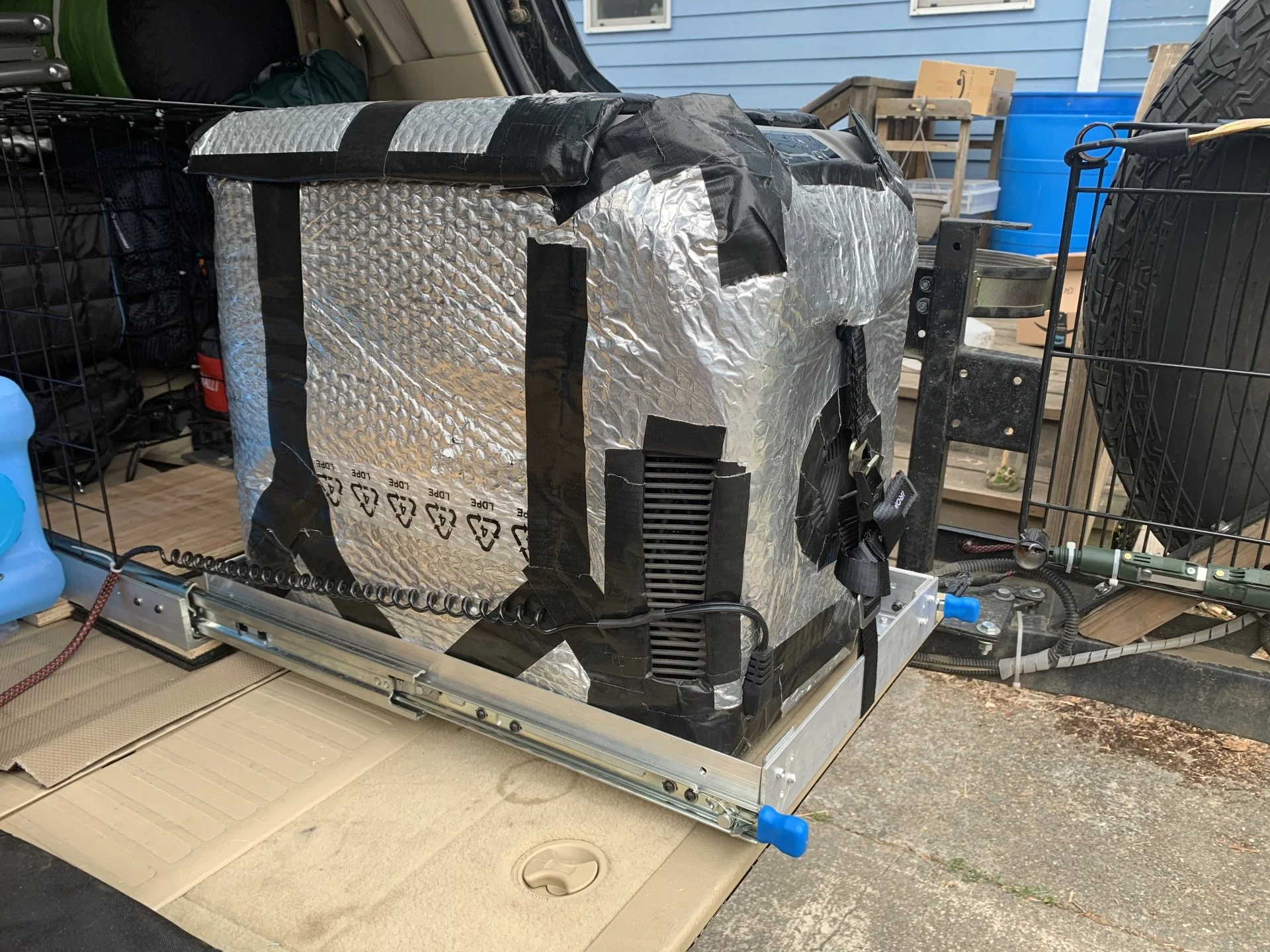

Pardon my ignorance. Is the cage just to keep the lid closed? I guess it allows you to stack stuff on top of it the cooler as well and then pull it out to get into it.
Keeps stuff from falling into the fridge area when you pull in out using the slide.

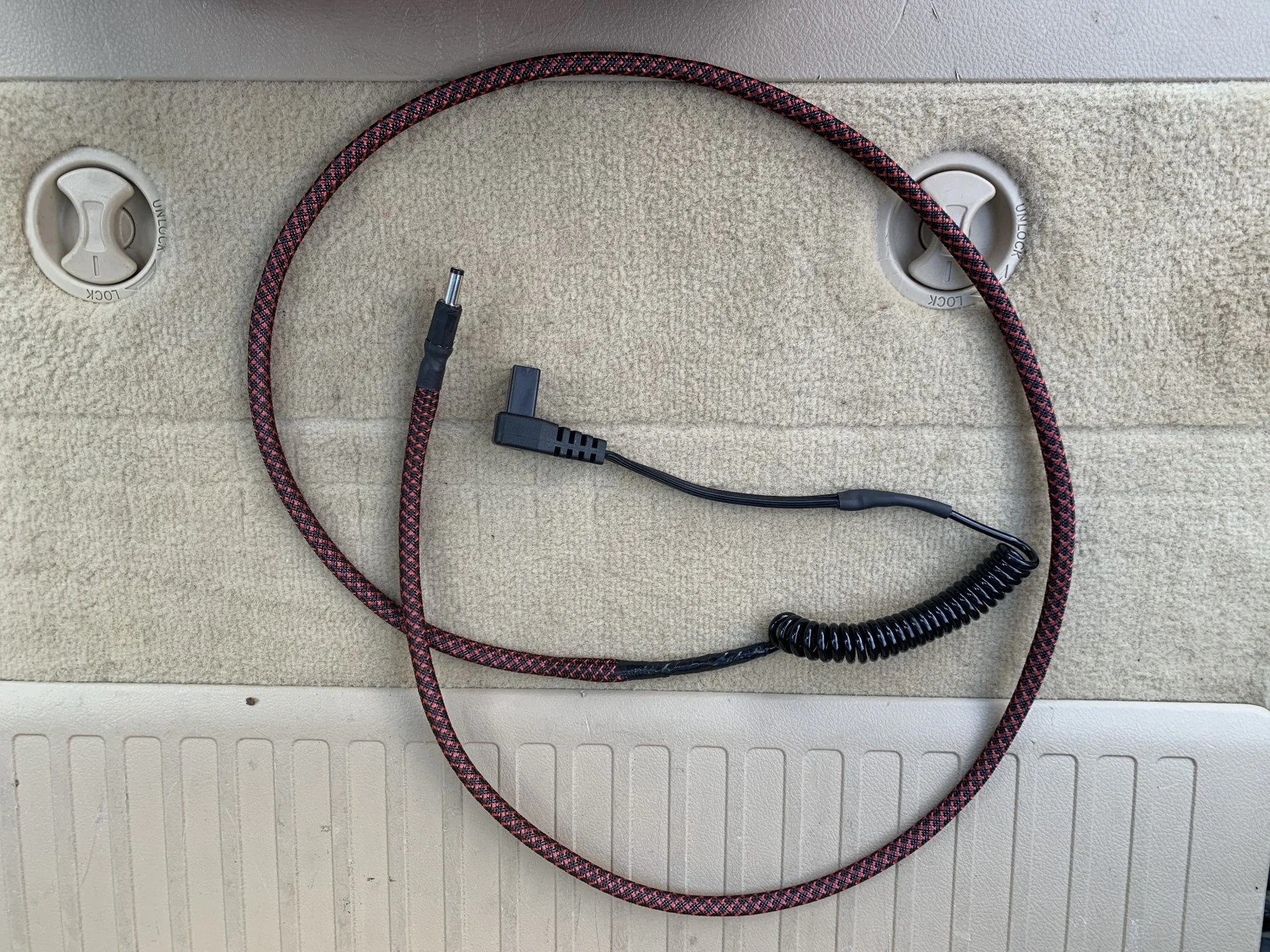

This 8mm to fridge cord you made up... was it originally a cig lighter adapter.
I need to source something before lcdc.
thx
It had four parts. The special female end that fits into a 12v out on my battery /solar generator. Then some 14ga speaker cable. Then that coiled cable which stretches to 2 ft which I cut off a cigarette lighter plug, then the special end from my fridge 12vdc cigarette lighter cable. Soldered and shrink wrapped and then some cable wrap.
Nicely done.

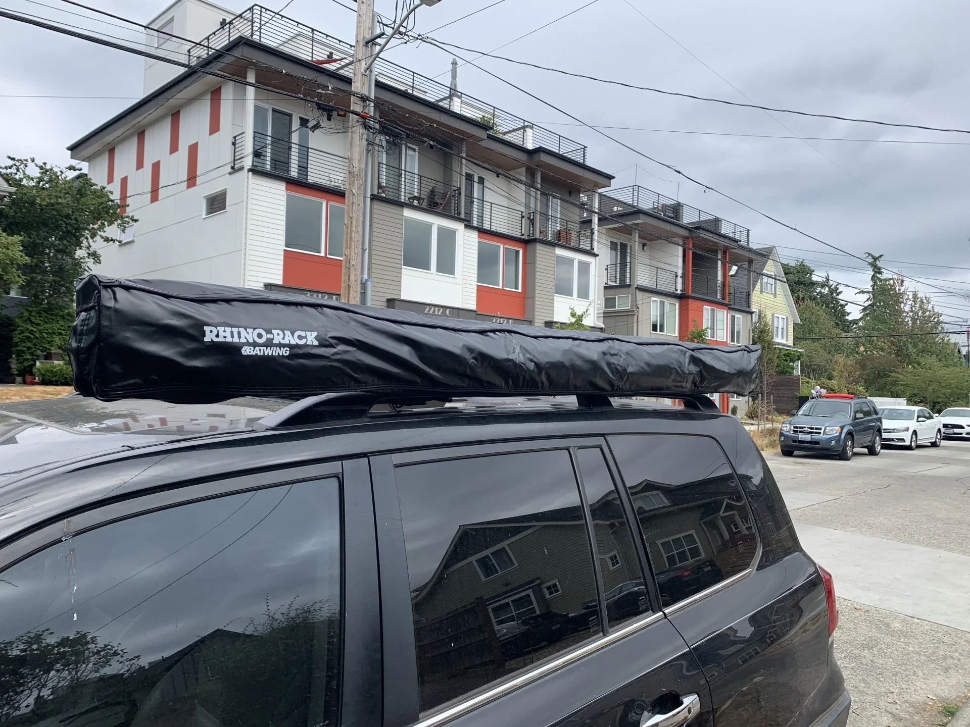

Back your awning into an overhanging tree and destroy the bag? Rhino rack has you covered for $50 + shipping. This is one of the benefits of buying from a big, global, outfitter. On the downside, still waiting for spare sacrificial hinges. So win some lose some.
it comes with a set of the plastic pins for the front, no need to buy additional.
