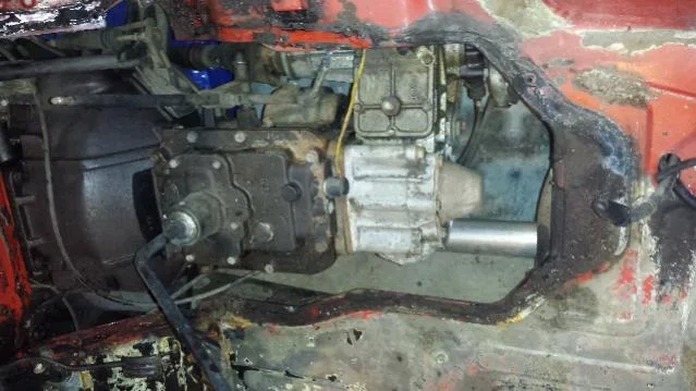

Pulled the transmission cover. No rust around the tub at all.
