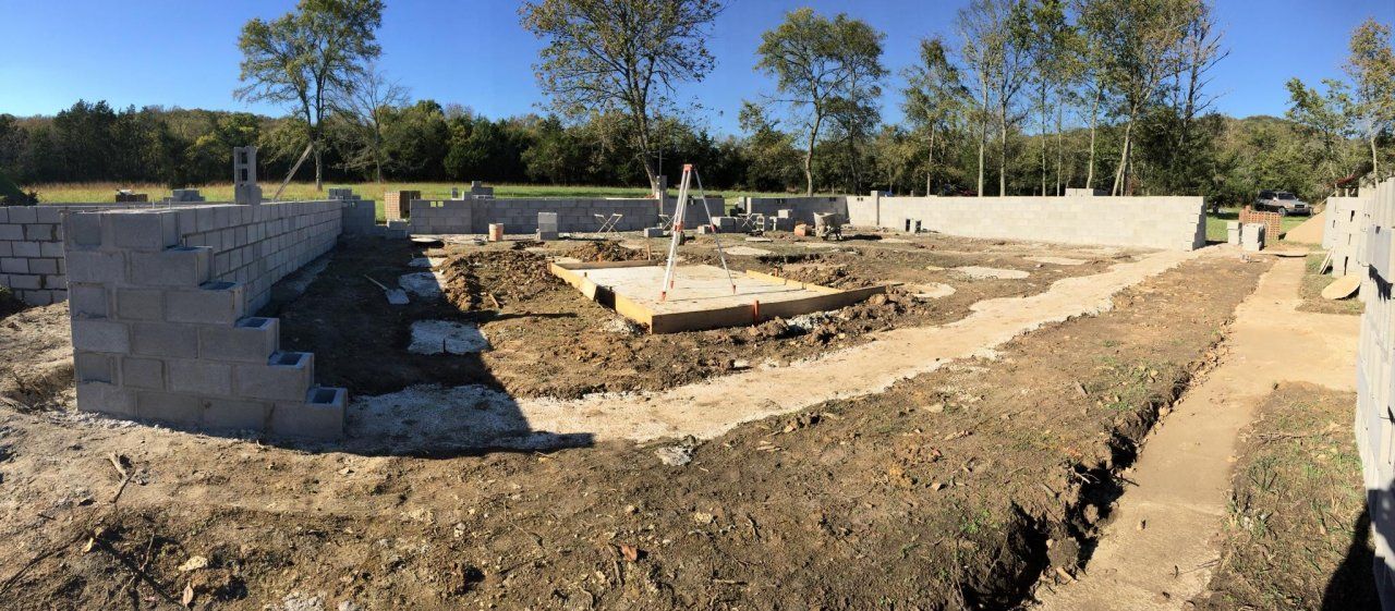

Thanks guys. Our builder says he is tired of waiting on his first mason and has another guy lined up. If all goes to plan they will be laying block tomorrow (10.6.15), at this point I will believe it when I see it. Of course the only bad part is that we will be headed out to SCC on Thursday so will just see where things are at the end of the week, that is if they actually get started.
So I should have put money on when the mason would start, cause I could have cleaned up. Tuesday came and went and no start, as did the next 5 days. Finally on Saturday we got a picture of a mixer sitting on site. So Sunday we ran out after we got in from SCC and low and behold.....
Corners!! 3 to be exact. So that was promising, but they didn't show back up until after lunch on Monday, but we were promised they were here til they were done. So Erin has been checking on them over the last few days and as of today they are making steady progress. Head guy said they should finish the block by Friday and should finish up the brick Tuesday or Wednesday next week. I hope they are right.
Looks like they have left the front open to do the piers and then they should button up the front and the porch.
So according to our GC the framers should start week after next if all goes well. Even though we are moving, I remain skeptical, bit optimistic at this point.

Yeah, took a while to get them here, but they seem to be doing a good job and as far as we can tell have been making steady progress. They ran out of water a little before noon today so it doesn't look like near as much progress today.
Erin sent me today's progress pictures.
Mostly looks like they ran out the front wall, leaving that little gap to get in and out of and then stacked block inside for the piers. Guessing piers and wrap-around porch tomorrow. We shall see.
Seems like all masons are slow to start and take forever to finish. At least your seeing some progress
The masons came out and worked for about 4 hours today while we were there. I worked on finishing up trimming in the back corners of the barn, Erin spent most of the day grading out where the swingset will be and the masons finished the safe room and another line of piers. 3 lines of piers to go and then finish up the front walls and foundation will be done. Framing package is to be delivered next week and the framers are set to start a week from Monday.

what style of foundation is that referred to? vs a solid continuous slab type? I understand the cement slab "style" and what I've heard is a crawl-space type style...but not sure I'm expressing that correctly. Are the floor joists..etc run across those coloumns of cinder blocks there in the center of the space...I assume so. Just wondering how things progress.
@Elbert That is what is commonly referred to as a crawl-space. That means there is a space to crawl around under the finished floor above. This is what my builder keeps calling a dropped floor system. I'm not sure if that is the technical term, but basically a series of beams (triple 2x10s in our case) will run front to back sitting on those piers in the middle. Then a series of 2x10 floor joists will span across the beams from end to end. Then that will get decking and they will start up with the walls. The box in the middle that looks out of place is constructed of concrete filled block that is a little over 3' tall, when the beams are added it will be right around 4' clear from the bottom to the top and will have some additional anchoring and reinforcing and will be our storm shelter. It is located under the stairwell that will go up to the bonus room, which I intend to reinforce as well. With some of the weather that we have around here, momma insisted on having a safe place for those "just in case" moments.
