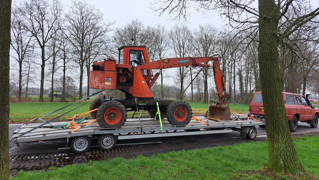

So now, the mother of all tows, I don't think this was legal but drove 180 km to get a machine that helps when stuck.
Not fast but managed between 65 to 95 km/h on highway, no problem at all with the rear lokka.
Trailer is 1000kg, 3500 is legal plus 10%.

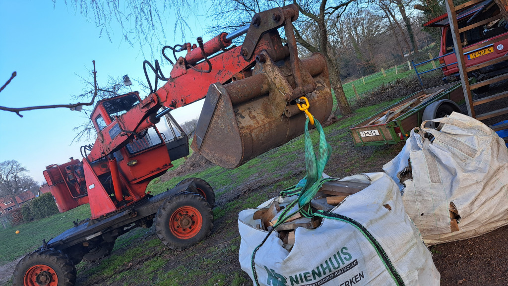

Type of crane is:
1970 Argenterio SM700
2 Cylinder Diesel: Motori VM Model 295
also know as Sun 2105 = SUN2105E2.MTP
No info online!, ordered diesel, oil, Hydraulic filter to start maintenance, some stuff from Italy and workshop manual from Canada :rofl:
Needs one head gasket and Hydraulic pressure is a bit low but filter was collapsed with rubber particle so needs a clean, and oil bath airfilter refilled with 500ml oil.
lot to do but it works:

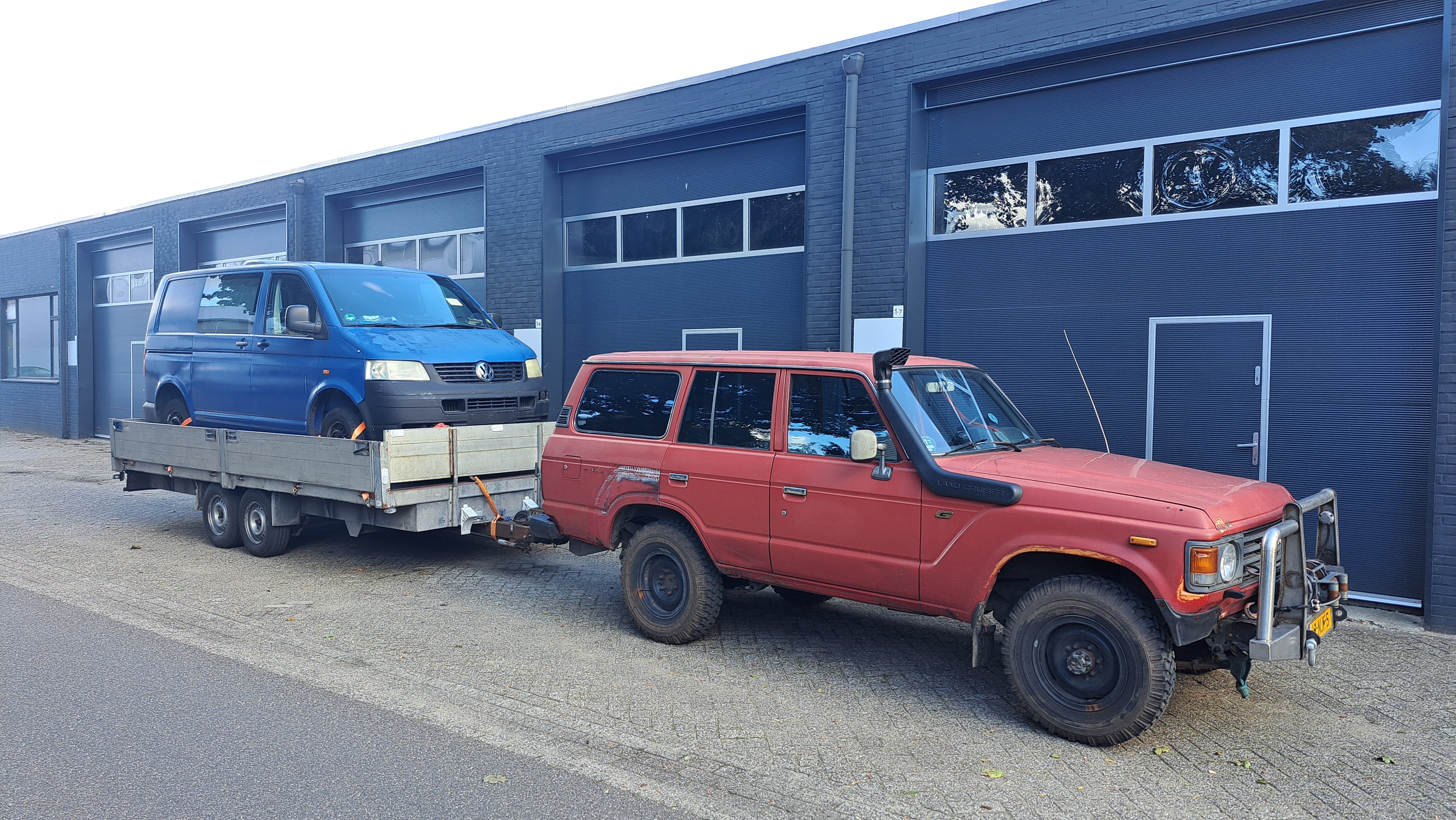

Getting a 500 euro VW transporter from Germany to scrap for the engine:
