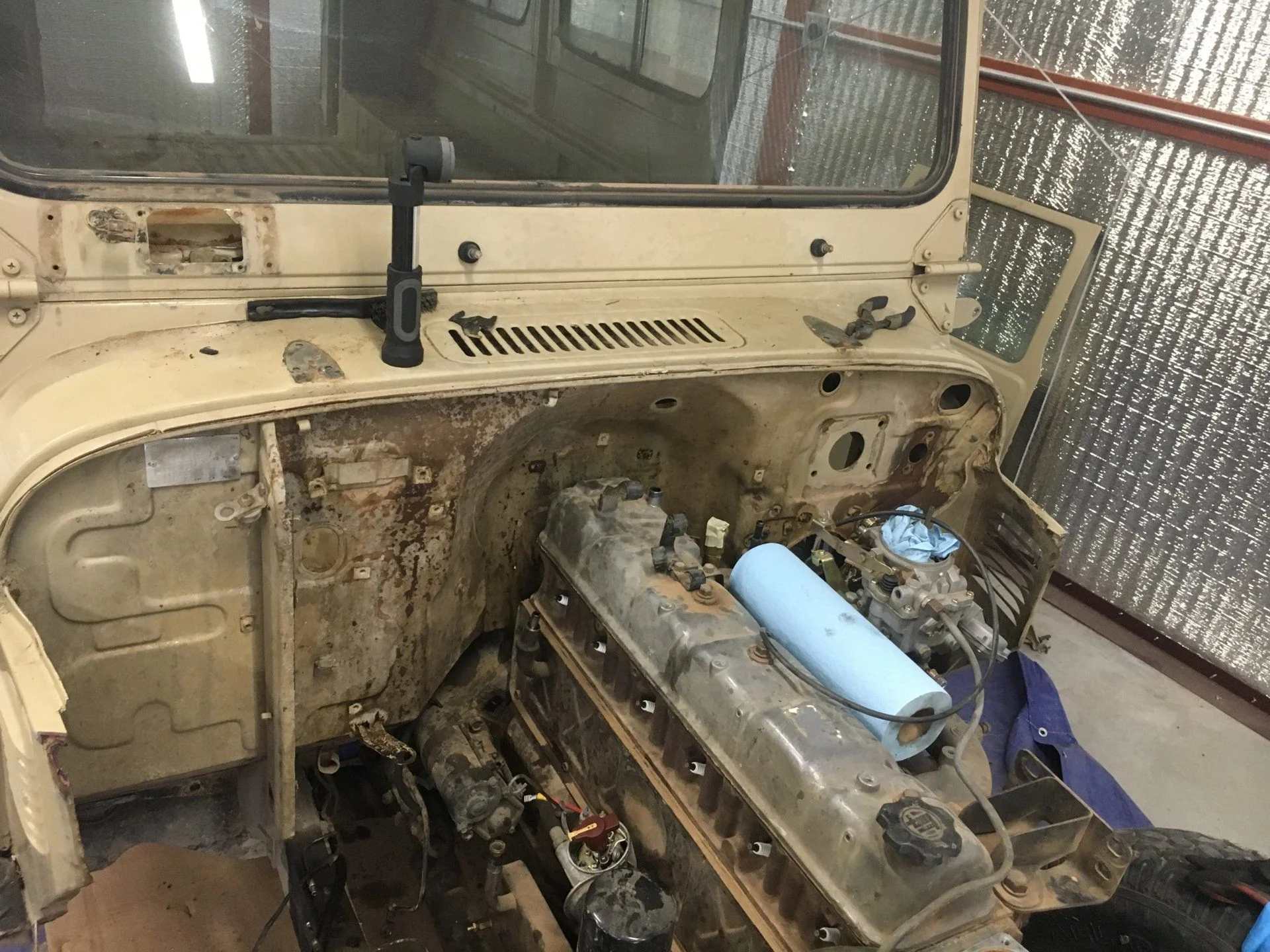

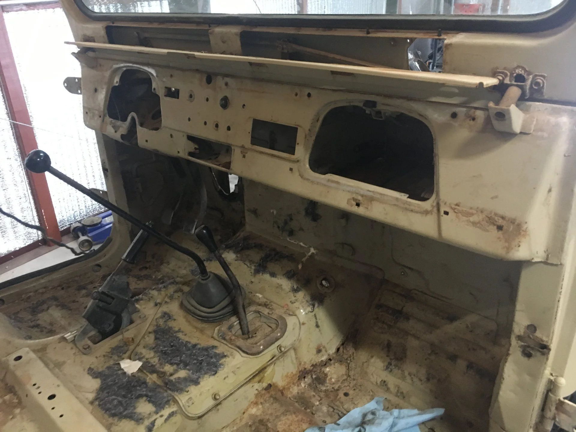

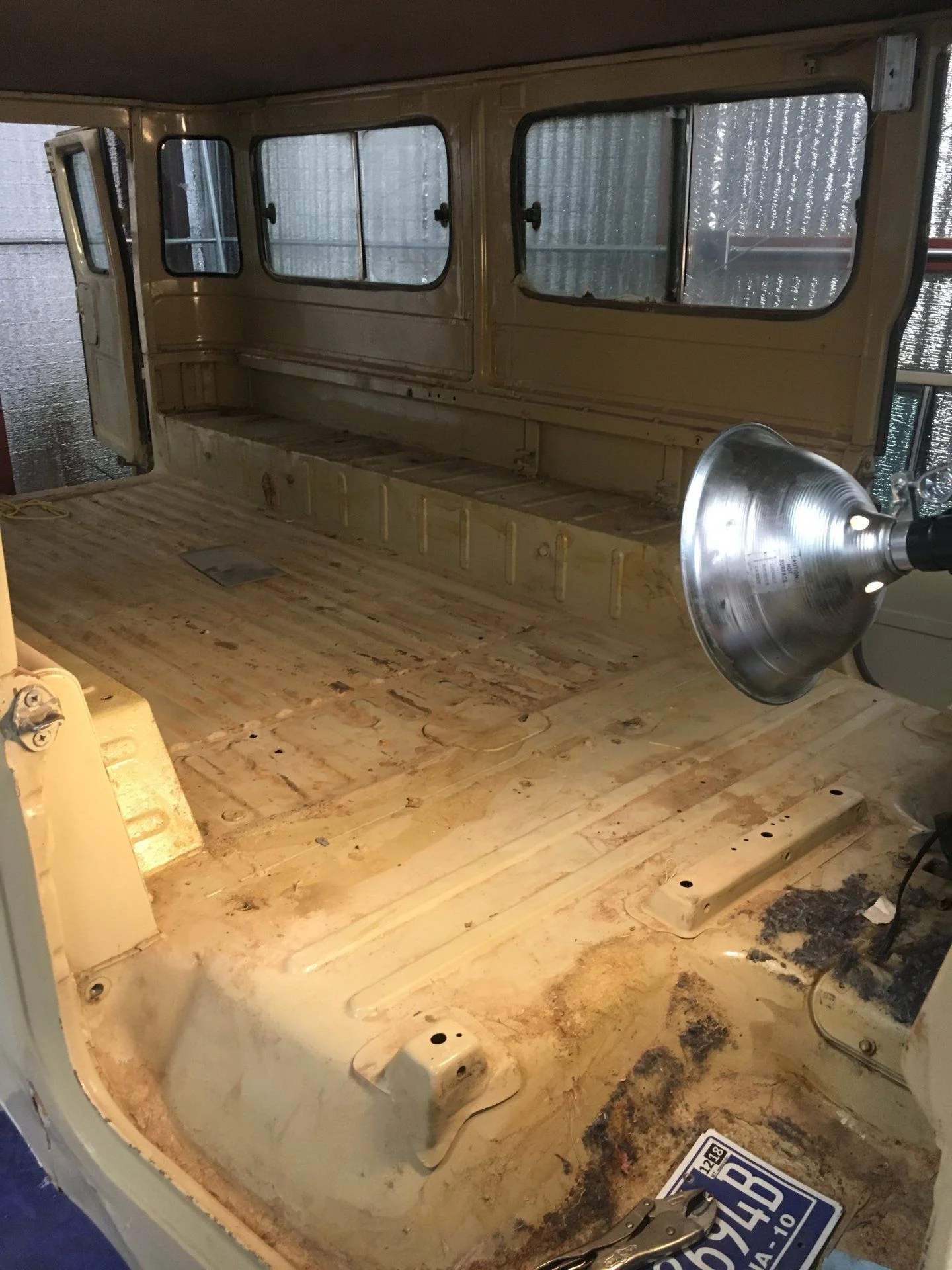

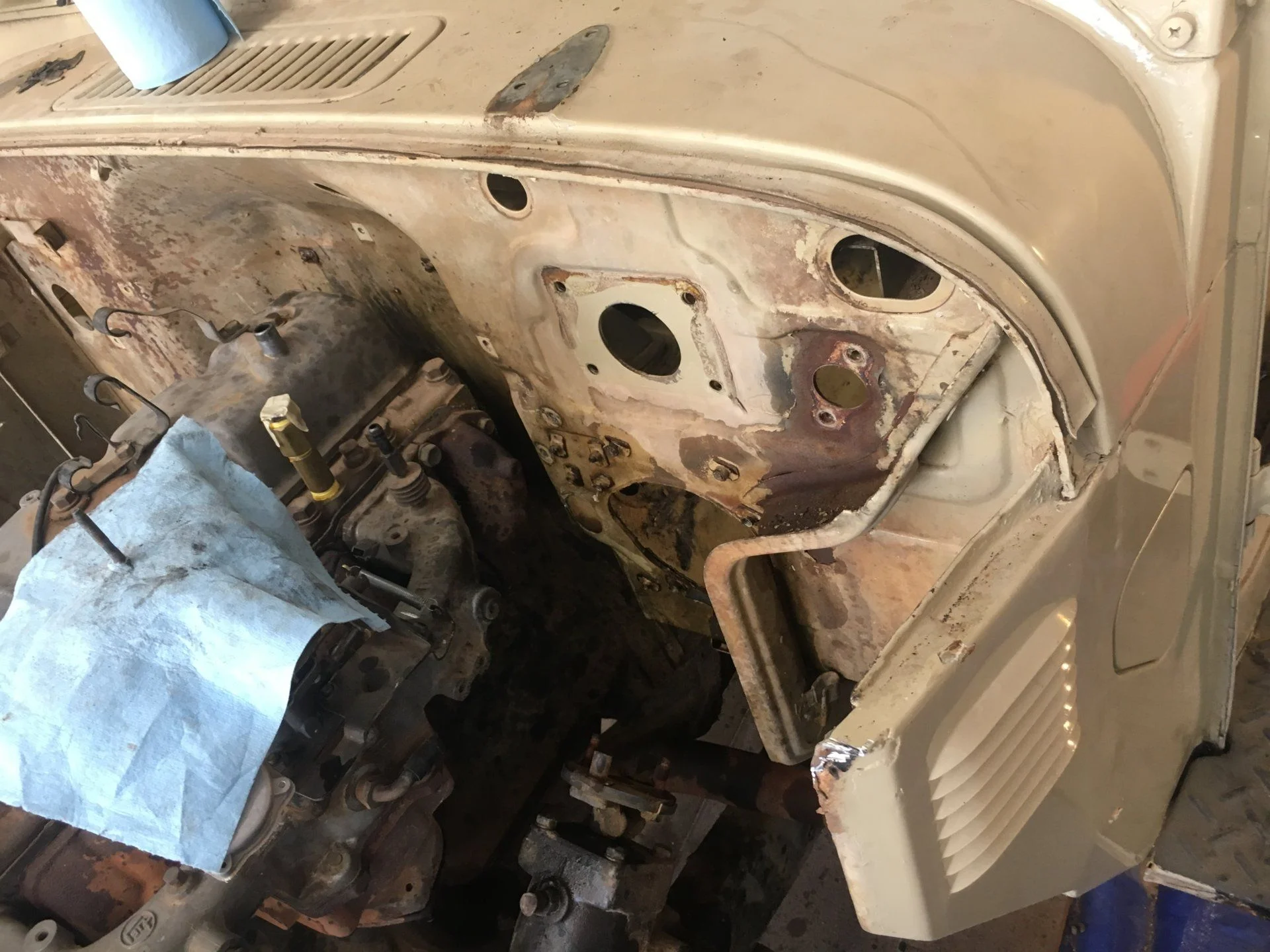

Today lacked the immediate gratification like removing fenders and bumpers but it was still very productive. Got both sides of the firewall stripped all the interior and All of the brake lines and wire harness out of the engine bay.
