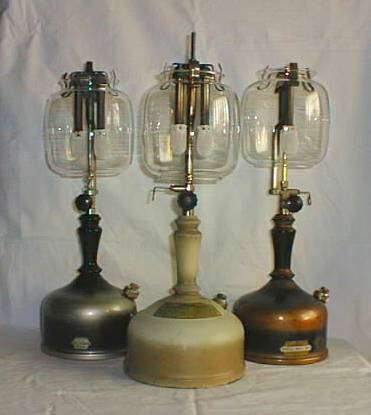

I was cleaning around the garage last night and checked one my lamps and found out there is still fuel left in it, should I dump it or is it ok to just leave it till next use?
You have Coleman lamps? Please post a picture. They are a cool sidelight of Coleman that I never got into, but lamps are cool in their own right.
But to answer you question, I always try to fire up old fuel. If it lights, it's bonus, and if not, it needs a thorough cleaning anyway.
