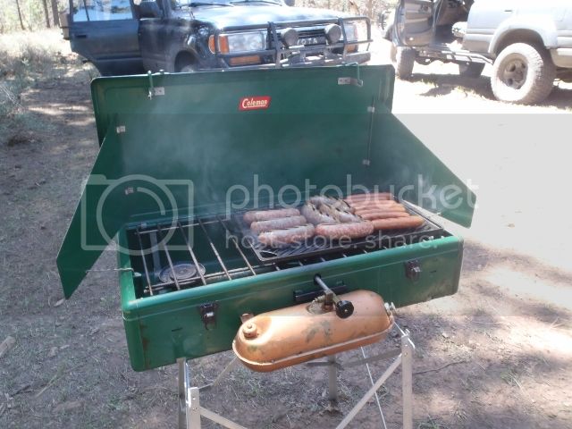

Here is an old pic of my 426B, since replaced by a 426C:
And here is a pic of a lantern and stove stand inside the case of the stove-this is why the 426B and 426C are so desirable. Lantern, stove, and stand all stored and safe with no extra stuff to pack.

Otherwise, trust me, it isn't worth shipping. You will find one locally. I shipped a 426C to FJ60Cam and just finding a huge box, sufficient packing, and shipping was a huge PIA. I felt so bad about the shipping cost I didn't even charge him the $10 I paid for it. But the stories that one could tell-straight out of the meth lab to Graceland.
If you pick it up at my house it's free.
It was totally worth the extra 15 years I had to add to my mortgage to finance the shipping!
I just used it last night as a matter of fact.
