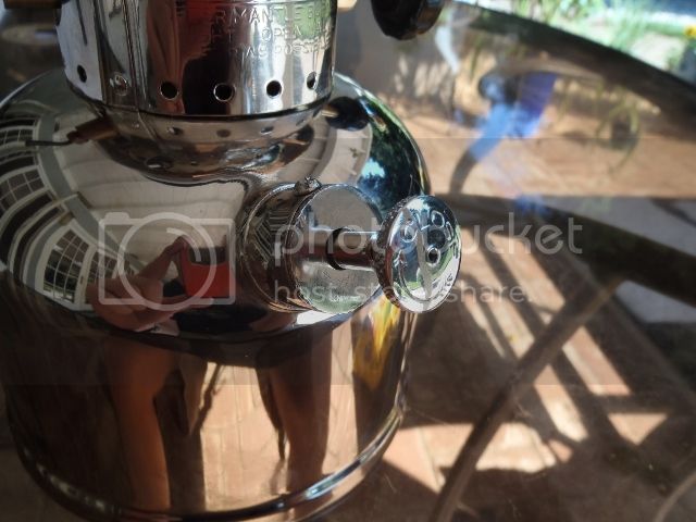

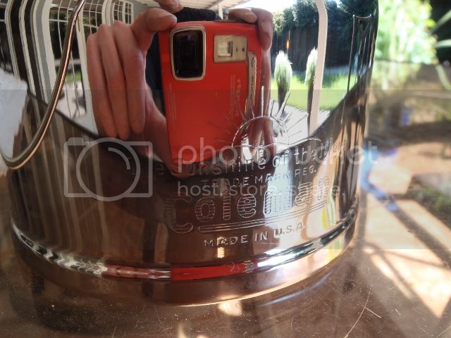

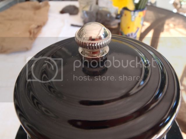

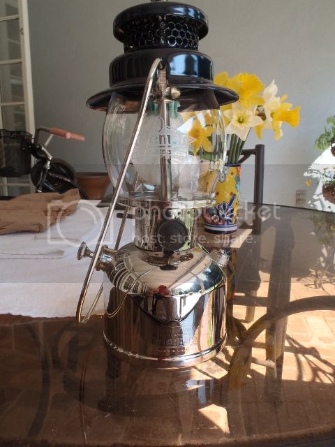

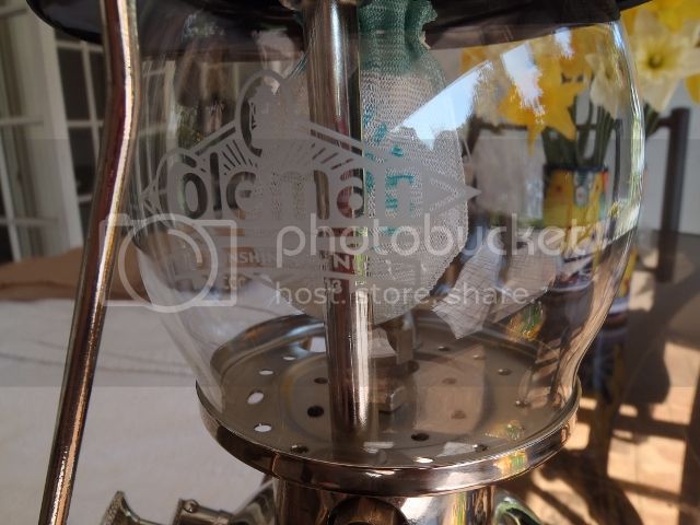

I've mentioned before how much I like 242s, especially the 242B, and 242C (which are basically the same). They came painted and plated with nickle. Some Canadian ones were even painted "sea foam" green. What makes them great is that they are basically all brass. The upper burner is especially nice being heavy cast brass. They don't leak and they run very quietly. They have other advantages as well. They are very small and compact, fit perfectly inside stoves for transport and most importantly use globes and generators also used by 200As, so that spares will be available basically forever.
Anyway, on another forum I was given a membership to the ICCC (International Coleman Collectors Club) and as their yearly project they had a 242RP (restoration project), where they had arranged with a plater to re-plate all the nickle, a porcelain shop to re-porcelain the vents, and a glass guy to make custom globes for the lantern. I thought I'd show the results. I had basically all the metal but the valve plated, and just re-assembled the lantern a couple of days ago.
True vent color-
This lantern is now basically new. The valve was taken apart and re-done, the valve packing was replaced with new, the pump leather is new as well. I'm waiting for the numbered decal and then I'll update the pictures with better ones.
That is outstanding!
