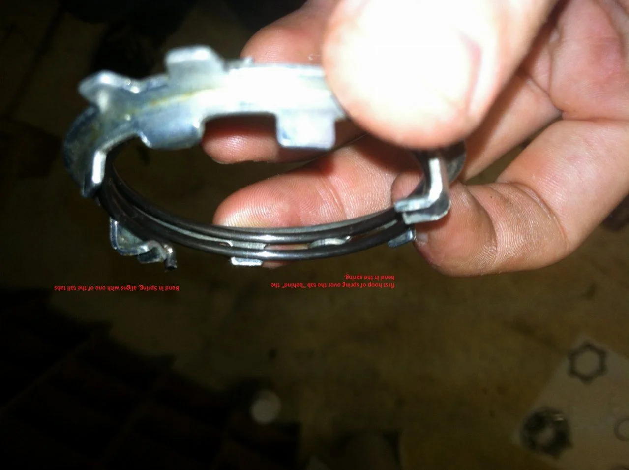

I also tried my hand at rebuilding an Aisin locking hub. I decided not to give these guys a fresh coat of paint, since they weren't in terrible shape to begin with.
The most difficult part of that, was getting the spring, pawl, and clutch gear assembly put back together. This is a tightly wound, heavy string that you have to wrap around a dozen different things.
First: the "bend" at the top of the spring catches one of the tabs in the pawl. Then, the first "twist" must go over the two flatter tabs on the pawl. the remaining spring goes under the tabs, through the center of the pawl. I messed around for about 20 minutes and found this to be the easiest way to assemble:
1. align the bend in the spring with one of the taller "tabs." Then, slide the top hoop of the spring over the tab farthest away from bend. Not sure why this picture loads upside down, but hopefully it gets the point across:
2. This was something of a "3 hand" operation. You have to get the other side of the first loop of the spring over the second tab (in the foreground of the picture above. To do so, I held the spring in place (so it wouldn't rotate) then grabbed the bend in the spring with my index finger, and pulled it toward the center of the pawl. Simultaneously, you push up with your other hand, until the portion of the spring you are bending AWAY from the tab clears the tab. Then you let go, and hopefully find the spring and pawl properly assembled:
3. To add to the frustration, the other (not bent) end of the spring now has to be threaded into the inside of the clutch gear:
No real trick here, you just keep slowly twisting the spring into the clutch gear, trying to keep it from getting stuck on the inner teeth, and pushing the bent end of the spring backward in the pawl. Takes some doing. I found that pushing down on the area of the spring right where it leaves the pawl, and enters the clutch, while twisting, helped to keep everything aligned.

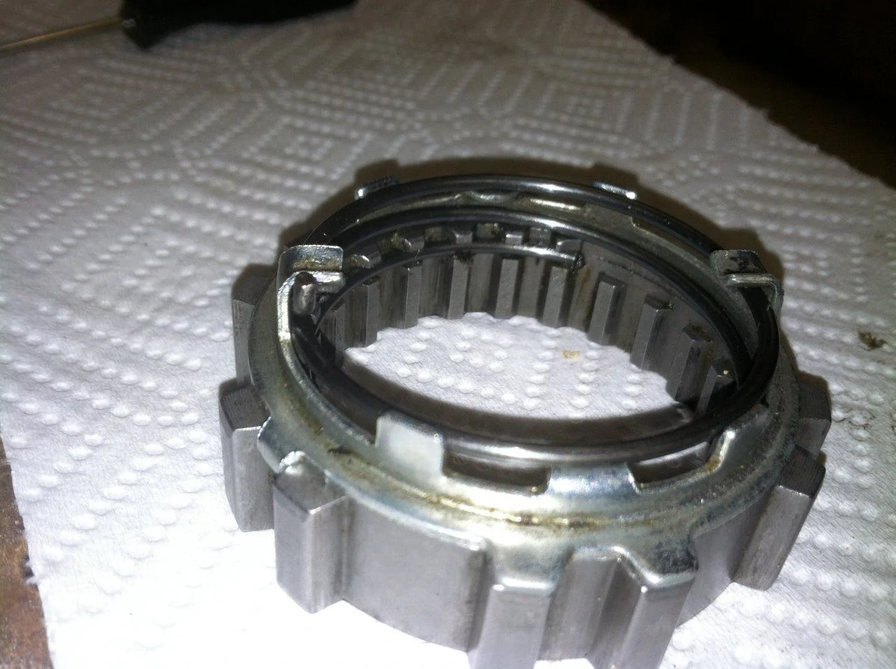

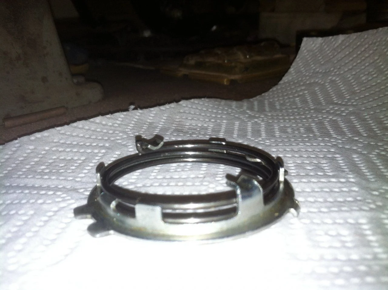

Assembled:
For the hub to work properly you need to make sure that:
1. The "bent" portion of the spring is flush with one of the "tall" tabs
2. The straight end of the pin makes one complete turn through the entire channel of the clutch gear. Note the orientation of the spring in the channel. Where the little "upper" teeth stop, is where the spring stops.
3. If both of the above are correct, the downward facing tab on the pawl should seat in the smaller gab between the outer gear teeth (See tab directly below the bent portion of the spring).
This was the toughest portion of the hub assembly, so I thought I'd outline it (again). There are plenty of additional resources available for the rest.

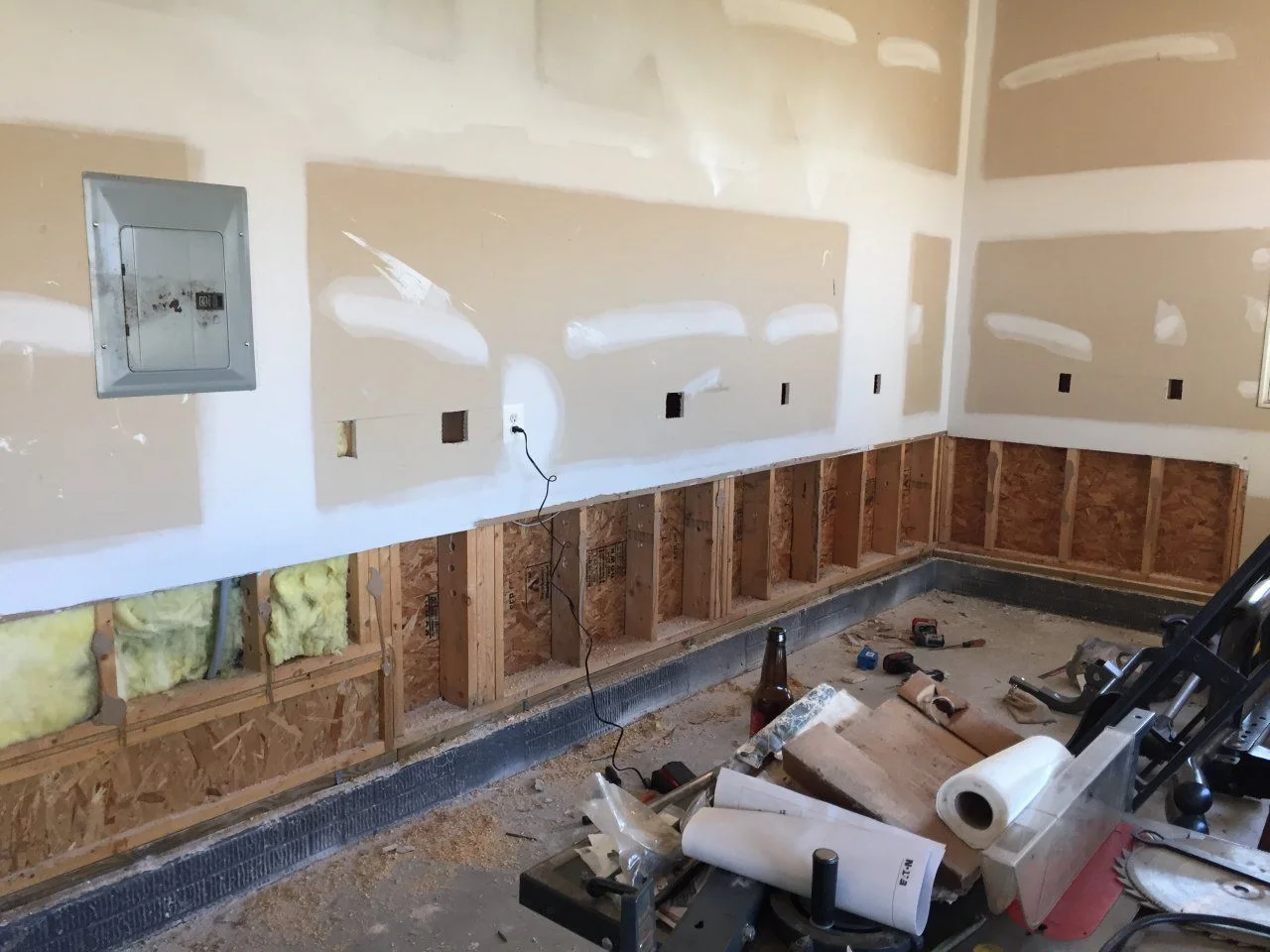

Haven't posted an update here in a while, and honestly, not a lot to report on the truck. I've shifted gears to the garage, prepping it for the next phase of work on the FJ40 - I NEED MORE POWER!
The garage was left bare drywall by the previous owners. I have no real intention of building my "dream garage" at this point, but I did decide to run 100A service to the garage. The new box will run a couple of 220 circuits for a future welder and compressed. I'm also putting in some more 20A circuits that will ultimately be behind a work bench.
Not really truck related, but a necessary step that needs to be taken to move forward.

Garage renovations are progressing. Nothing like a couple of 70-degree days off around Christmas to get things done! The wiring is in, the sheetrock is back up. On to spackling, sanding, and painting.
