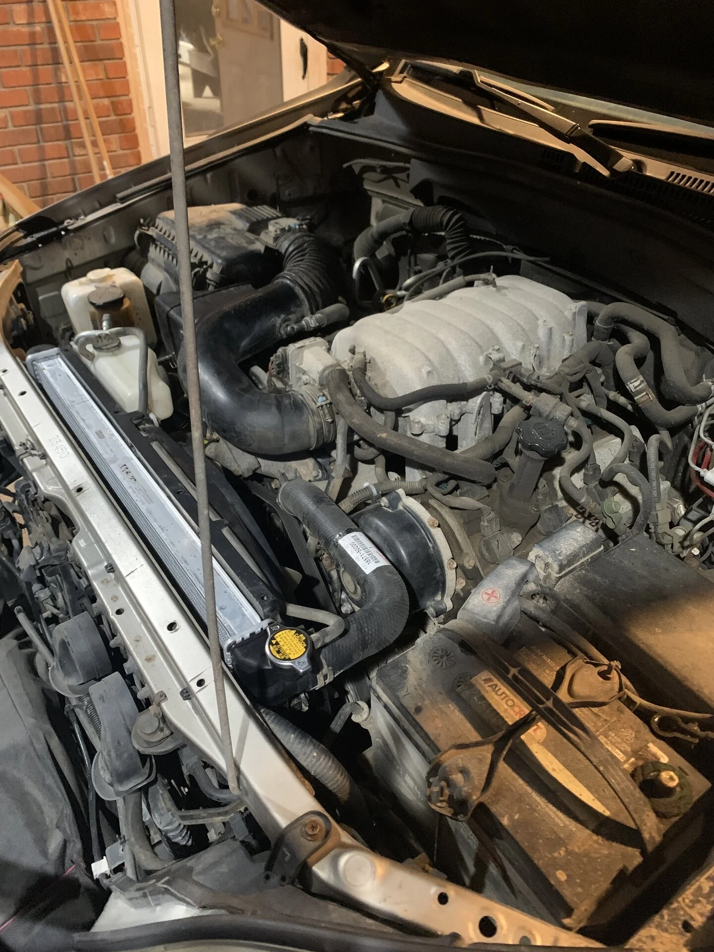

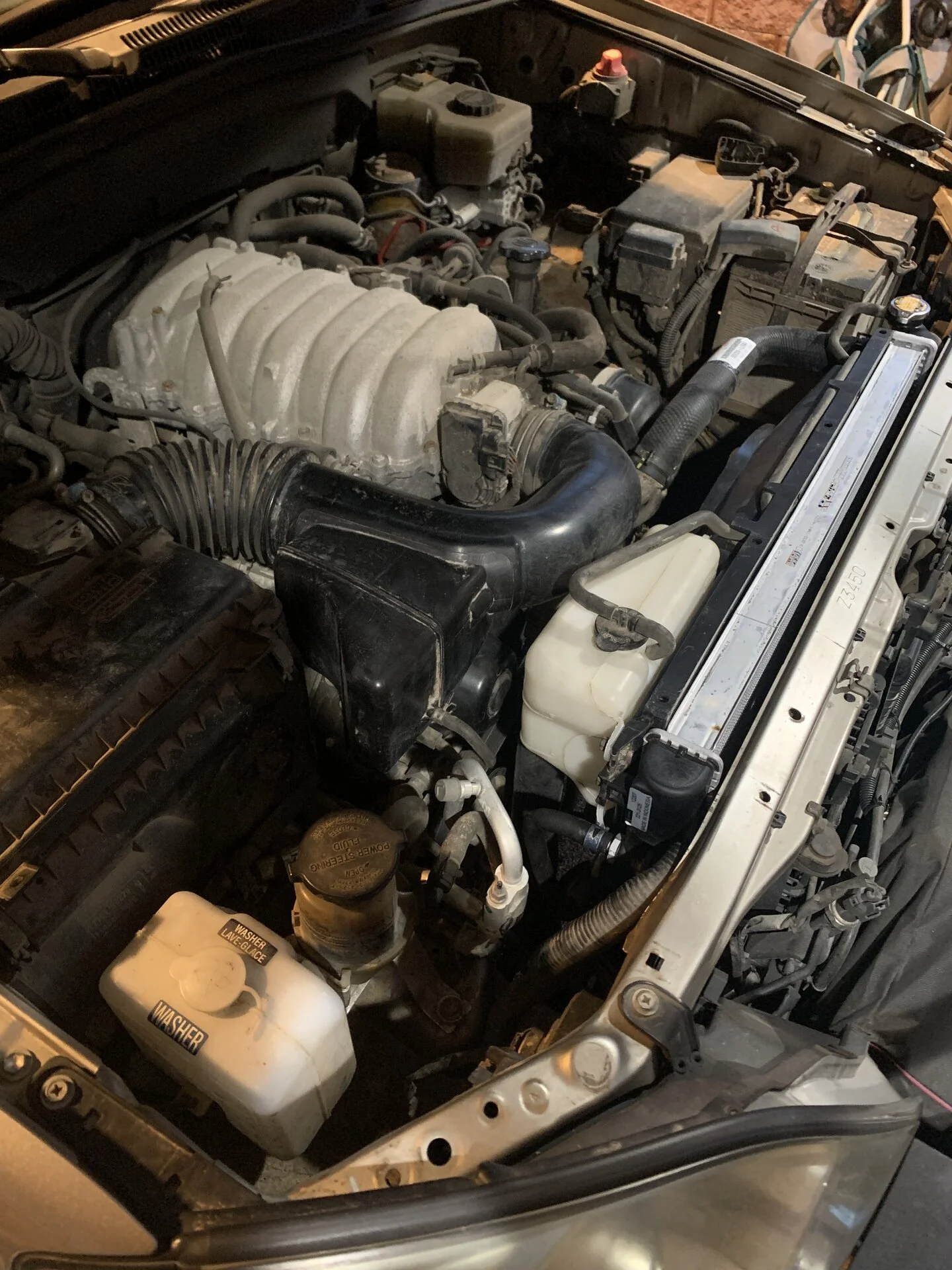

Funny, the last 2UZ timing belt I did was in an in-insulated garage where we burned through 40# of propane to stay warm :). Not a bad job at all really.
I assume it is still cold there...sucks! We are entering the warmer wet weather and the pollening has started in GA.
Yeah it’s chilly here but not cold, yesterday was the warmest day we’re going to have for a while, 45 degrees.
Plus I have a small event the 17th at good evening ranch, so pushing a little to get it done now.
Ready to fire it up in the morning.
