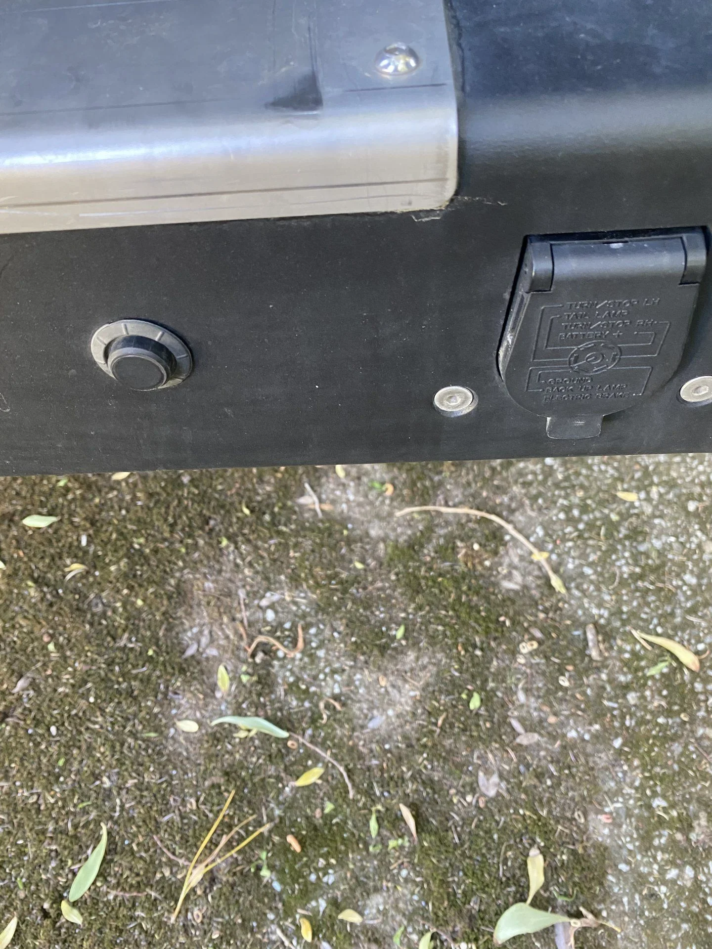

I used to be a firefighter, and we had power disconnects that would pop off if you drove off without unplugging them. I suspect there are home scale versions of the same thing.
Something like this I assume...
Hey @radman - I forget if you have the integrated trailer plug in yours, but it may not be a bad idea to consider either using that spot or going in right next to it. There is plenty of space in that cavity for what you are doing.
Winner winner chicken dinner! Looks like there’s enough room there...

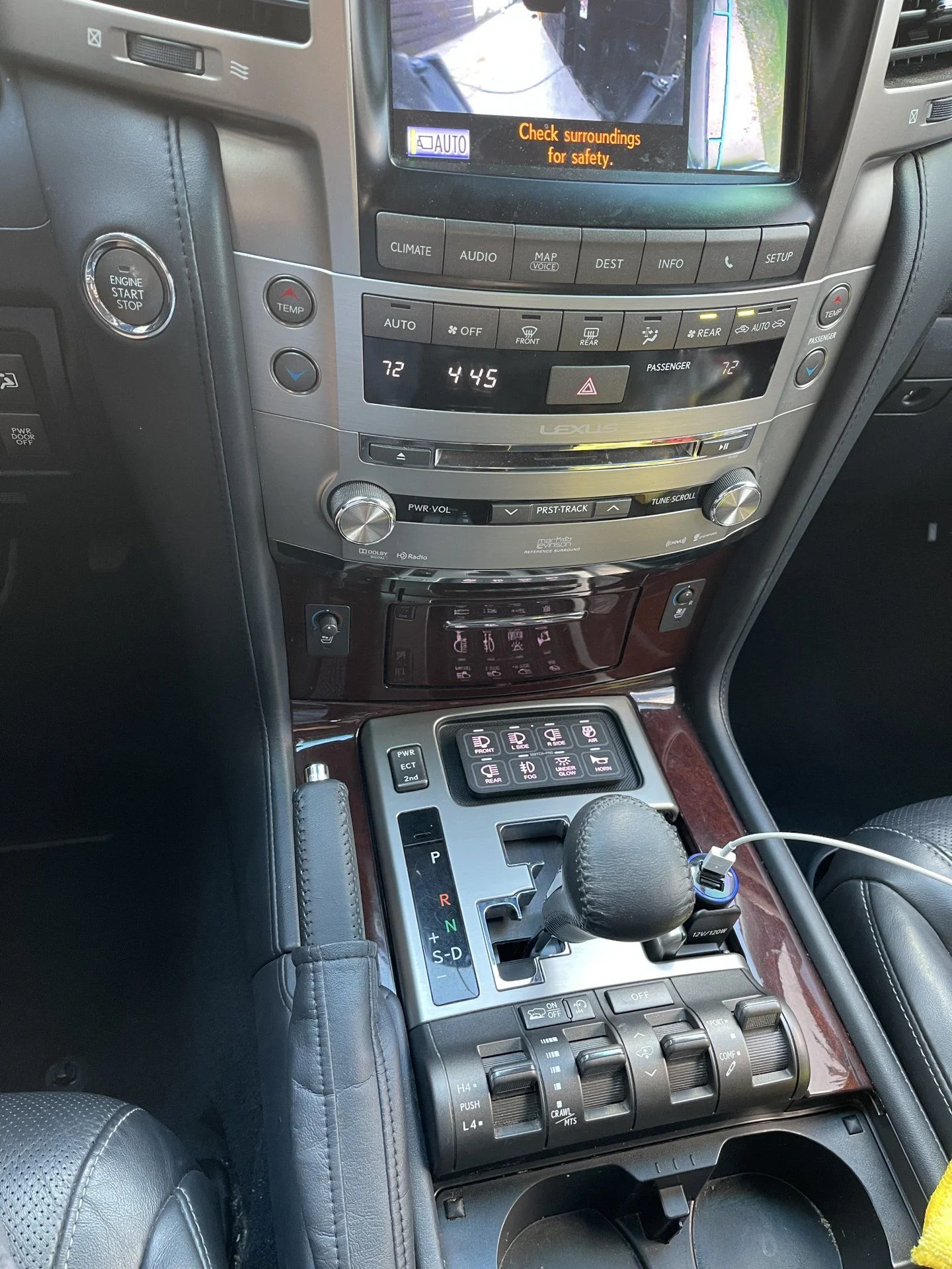

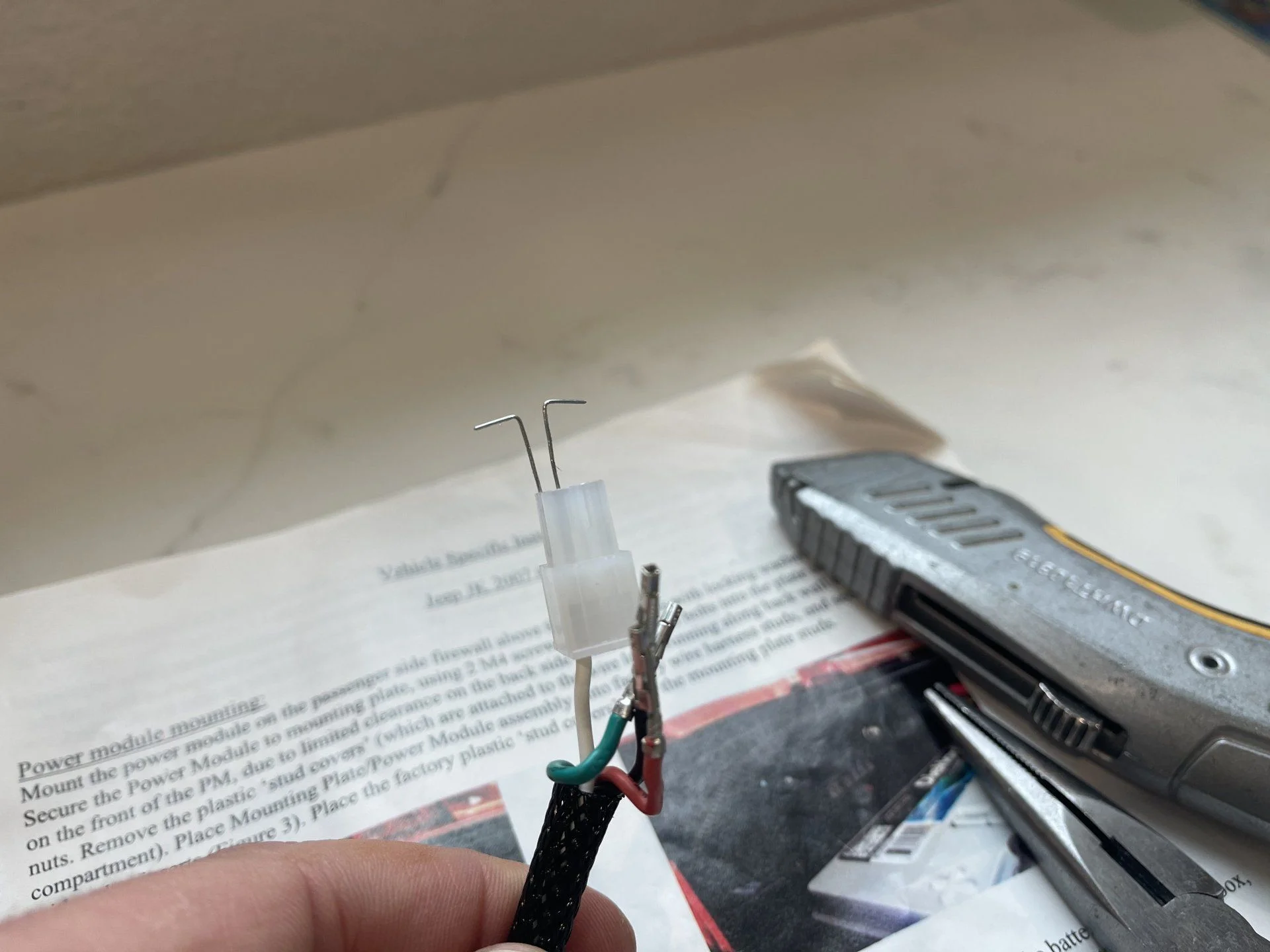

Got around to mounting the Switch pad and tidying up some of the wiring. Staples make for good molex release tools!
I cannot believe you are still running the stock cupholder... 😭
Haha, it’s never really bothered me but I have seen several options. What’s your favorite one?
@radman BH3D for the win.
I agree, recent BH3D convert here and the juice is worth the squeeze.

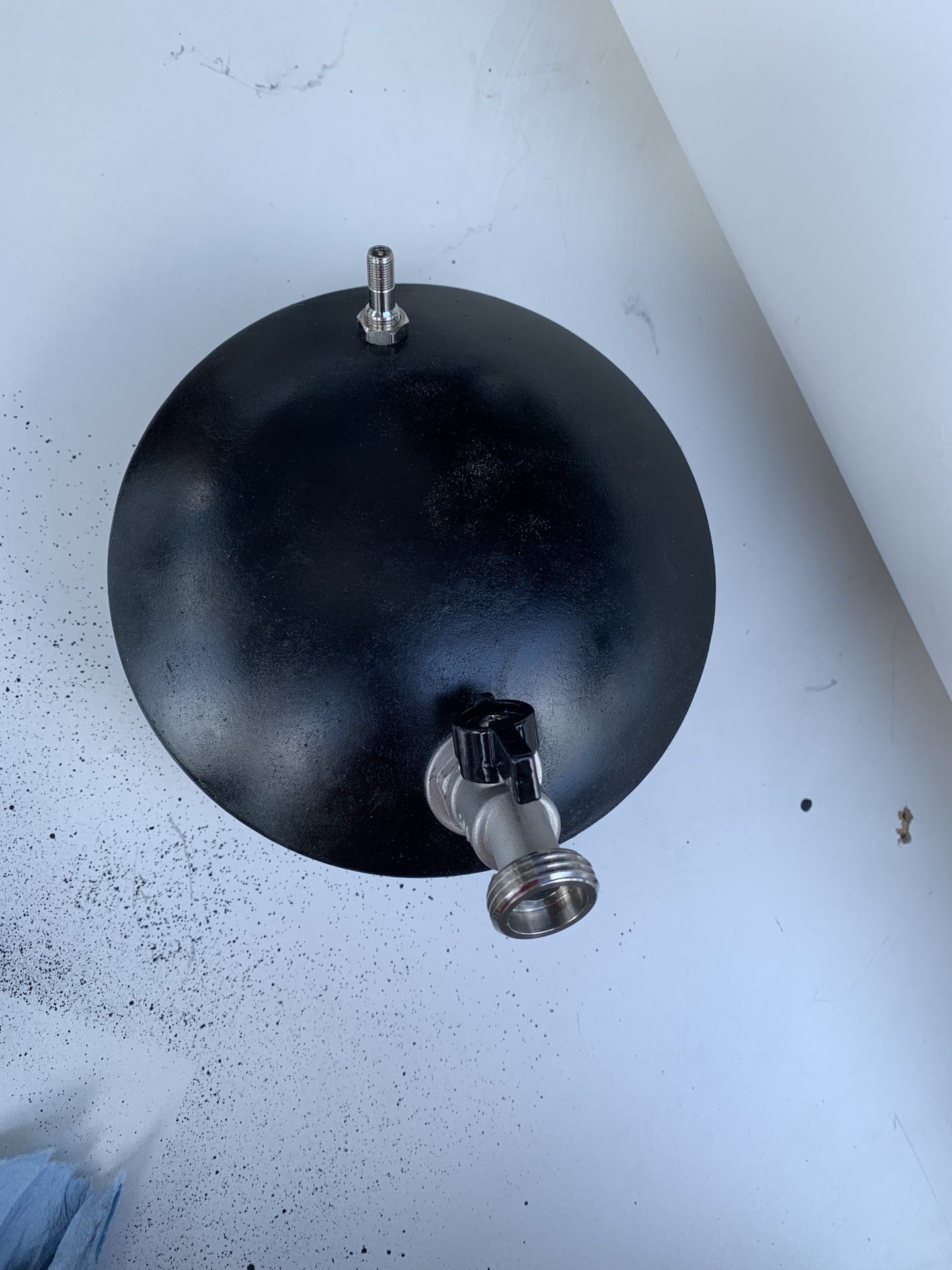

It's been 90+ degrees, and combining that with WFH, I've averaged about an hour a day outside working on the bumpers (zero on the weekends (family time)). Front is 100% and I decided to wrap up the water tank while I waited on the amazons to deliver me a 2 to 3 wire converter for the rear combo lights.
We live about an hour from the beach, so the plan for this thing was always just to wash the kids off before they got back into the rig. Honestly, I hadn't thought about all the sloshing, but now I'll make sure it's empty before we head back home.
Using a male to male adapter, I can use the hose bib to fill it up. City pressure gets it up to 49psi, or I can purge the air out to fill it to the brim. The water should be nice and warm from sitting in the sun all day, and hopefully the 100lbs rocket doesn't go flying off the roof 😬
