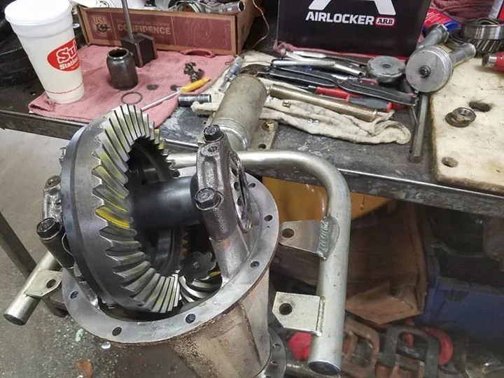

Willy, love your post build, build thread! I'm curious about your re-gear and air locker purchase/install. Often times when purchasing a locker, the casing will only fit a certain size of ring gears. I'm guessing that the 4.88's are substantially bigger than the factory 3.909's, but am curious to know it the lockers would have fit the factory gears as well as the new ones. If they would fit, then others could do the locker upgrade, and then later do the gears if they needed to.
Thank you. Without knowing all the details a mechanical minded person knows i can say this. The rear air locker was in for a year plus on the OE gears before i went 4:88's. Now whether my shop had to do anything to the lockers to get them to mate up with the 4:88's i do not know. It didnt come up in the conversation post install. Hope thats what you were asking

Thanks Willy! I didn't know you had the lockers before the re-gear. I thought it was something you added at the same time. Glad you're enjoying the new gears.
With the 9.5 on the 200 series rear, the ARB will fit all gear ratios:
ARBRD152
Upgrade away!
