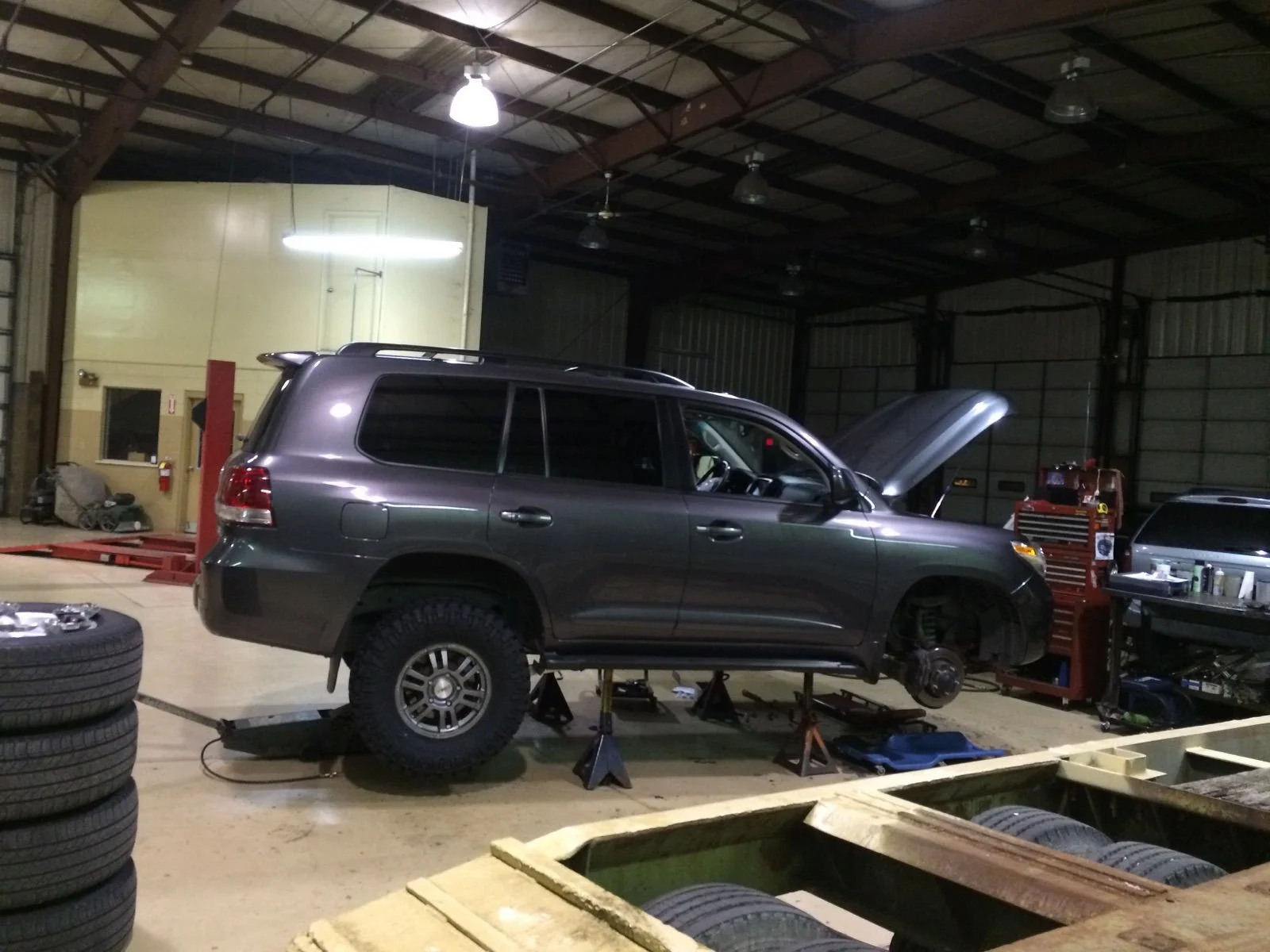

Next came finding a local shop to take on the challenge of making my dream rig come true. No cruiser shops in Louisville. My receptionists husband owns a great local shop that took me up on my request and so the venture began. when I pulled up to retrieve my truck my first thought was oh man gawd what did I do - that didn't last very long. As soon as I pulled away I was HOOKED. Besides Chirsto, and two other guys on Mud I had one of the very few 200's on 35's that I knew of. There are more now and for a good reason - It looks great!

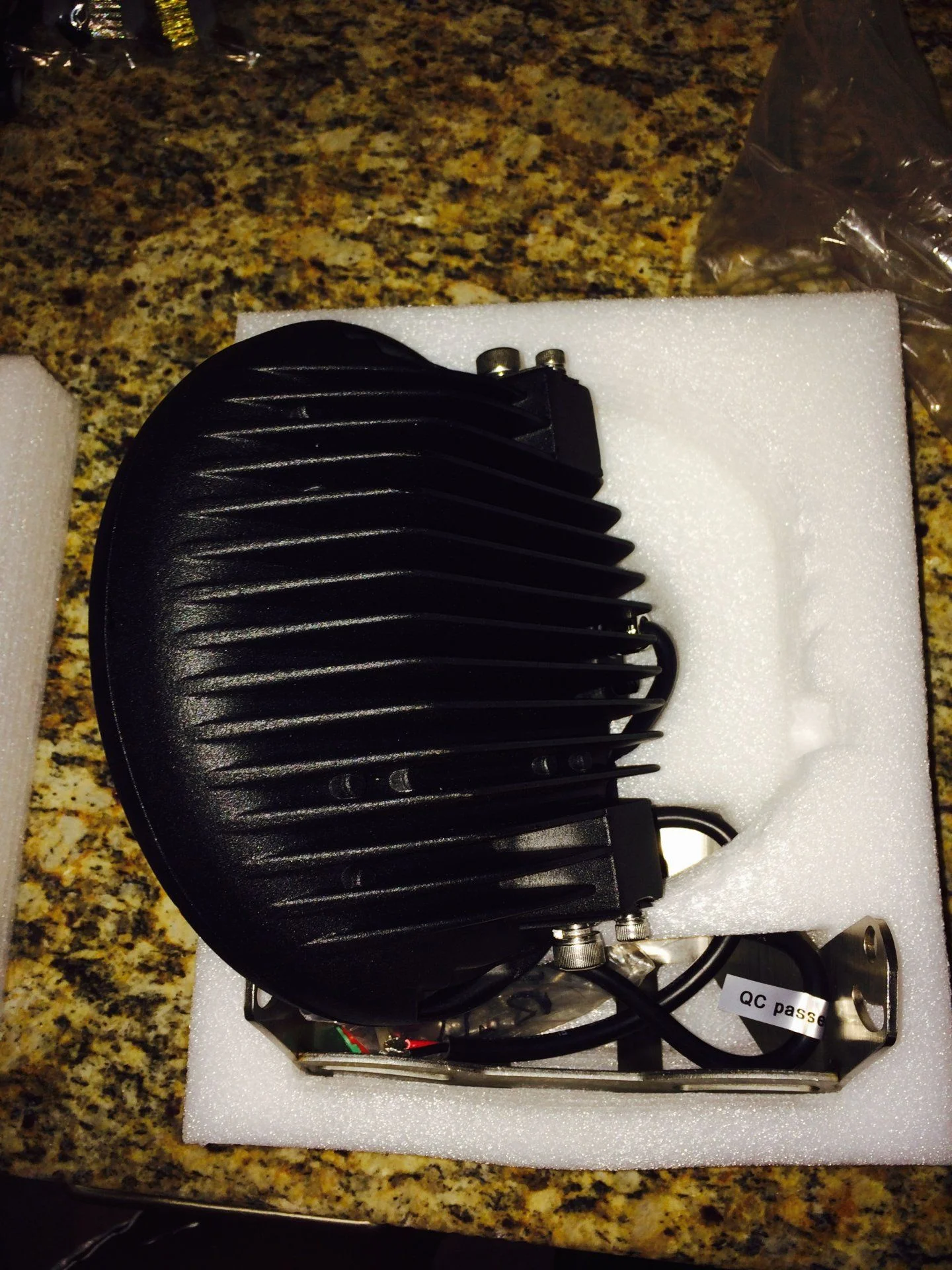

Next I wanted to try out the LED headlights so i went for the brand pictured below and they've work out great. Now, it was time - I talked my buddy in going with me out west and we hit the road. About three hours into the trip, somewhere in IL, my dash LIT up. I called my shop and they reduced it down to the speed sensor seeing how everything else was working properly. I love a diagnosis over the phone at 8:30pm. I said to hell with it lets go. I called Christo early the next morning and his said "you are 1000 miles away, if you make it here I'll try to fix it " I was good with that. We rolled in his direction and he did just that, fixed my issue which was a bad speed sensor. Christo said the shop that installed my rear air locker didn't disconnect the speed sensor before lower the axle and thus pulled the wire loose - rookies. Nothing ventured nothing gained. thats my buddy feeling about half dead - we drove straight through from Louisville - ha

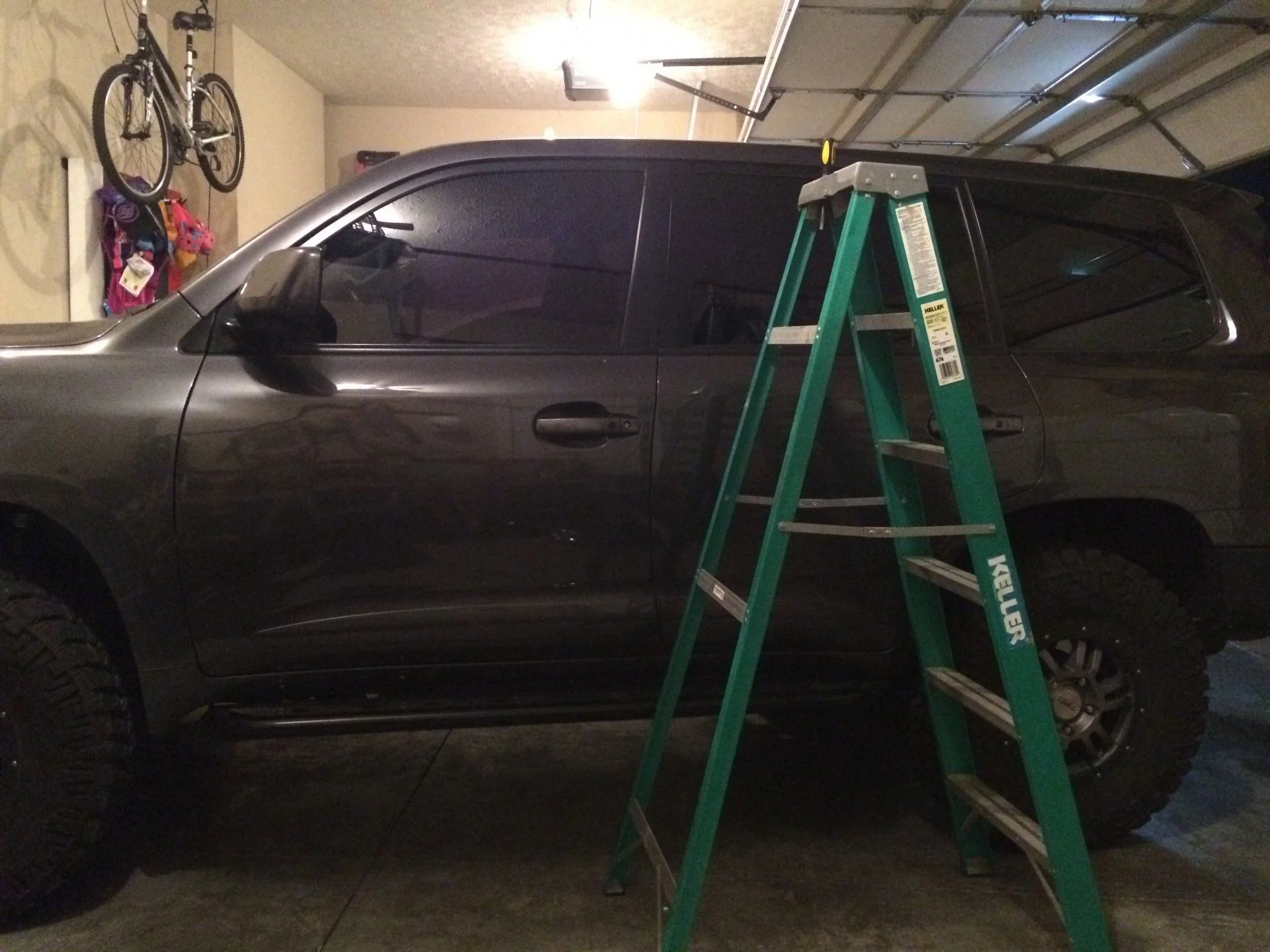

For the light bar I ran the power cable up the DS wind shield pillar theres a recess there and the cord tucks nicely. RVT to holds it in place, wire it up, ran the switch and boom - we got lights
40" LED light
