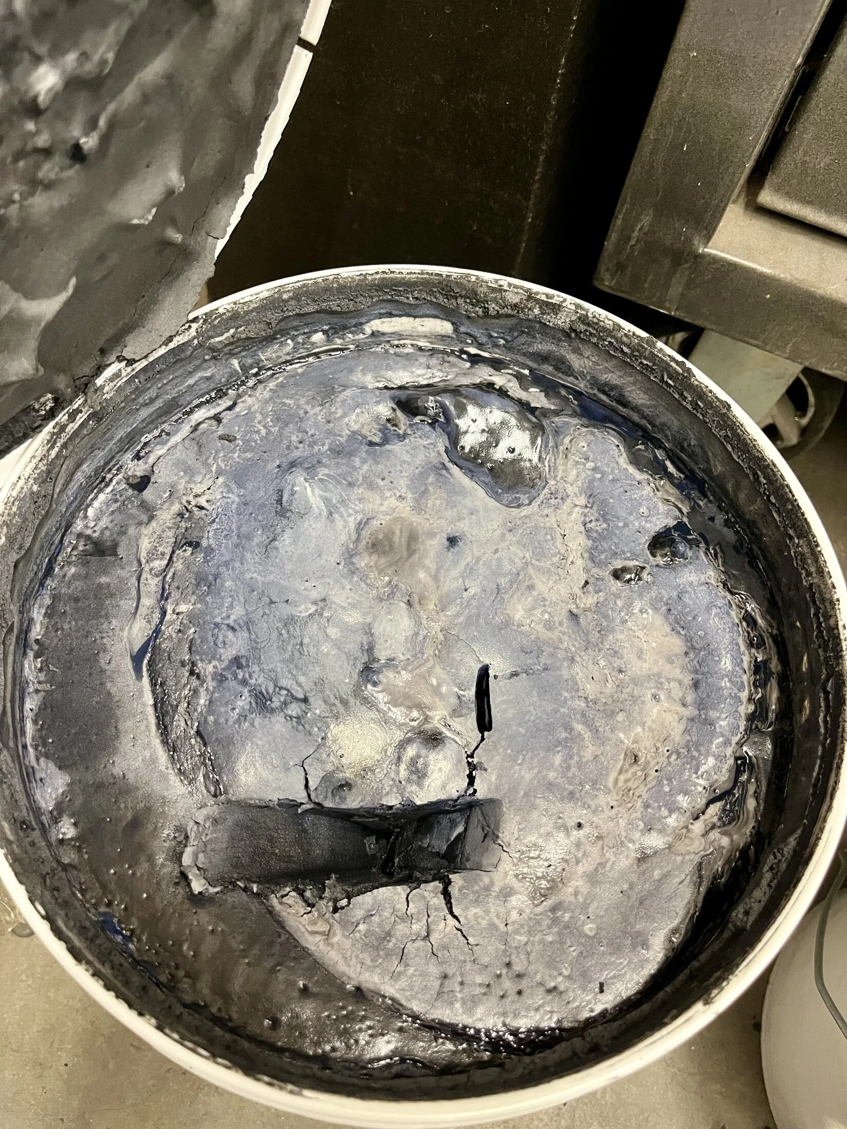

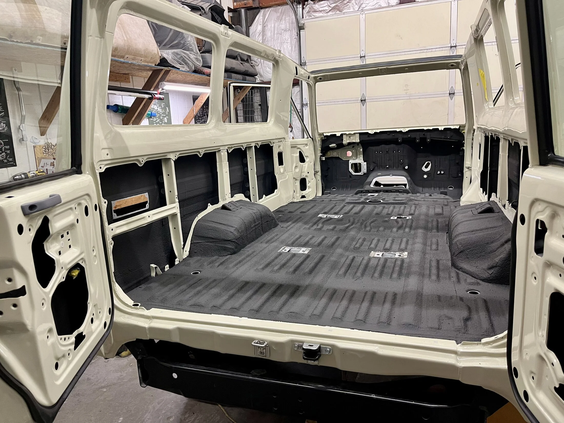

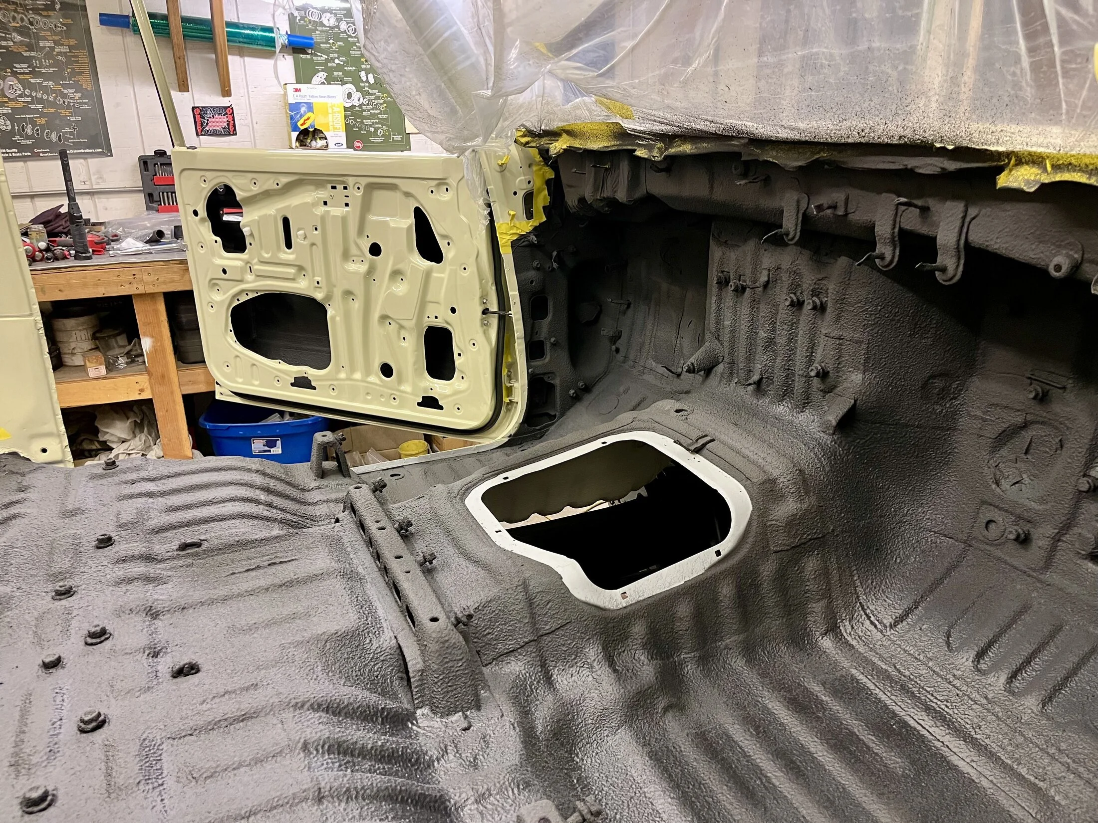

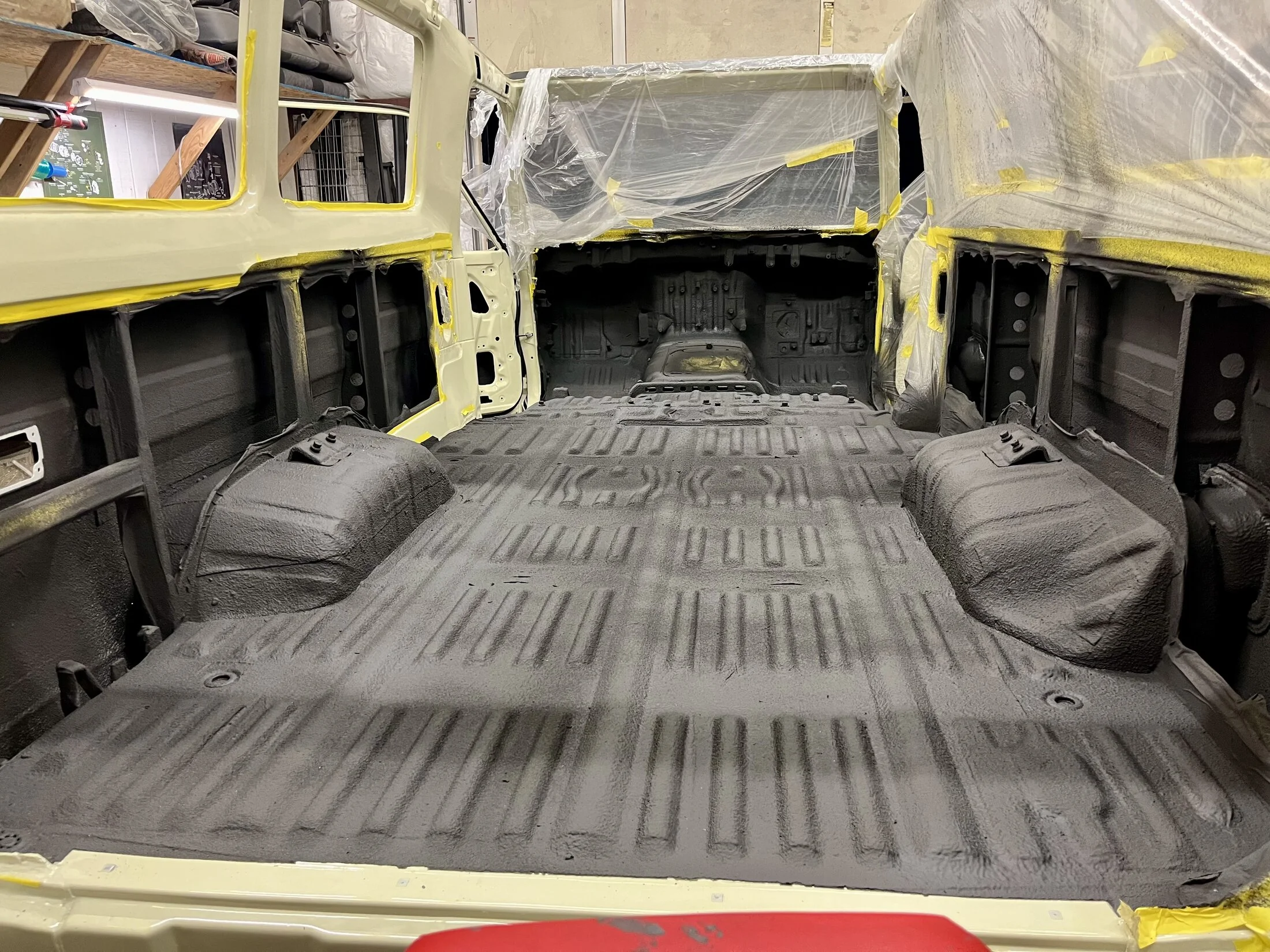

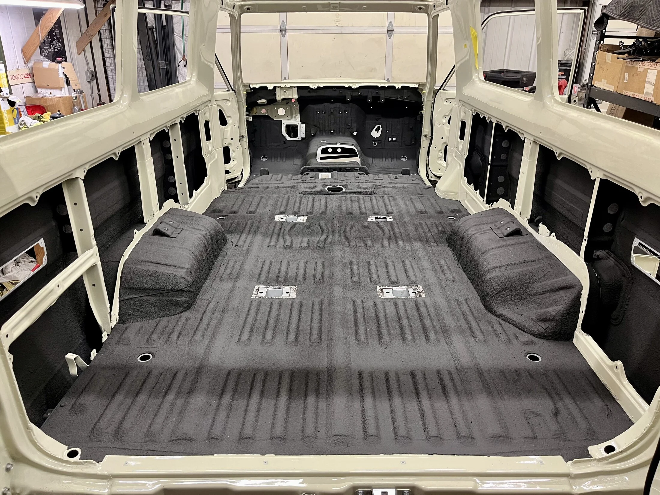

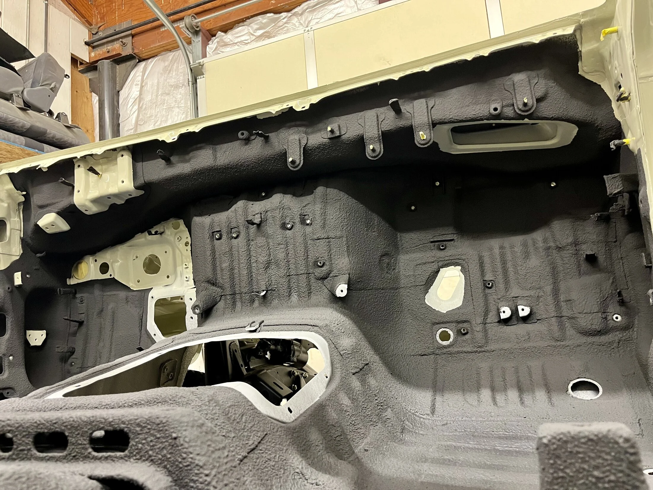

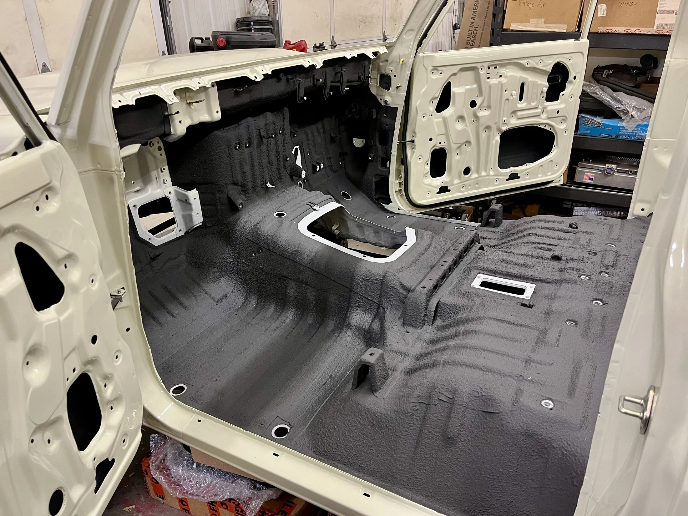

First coat of ceramic is down.
Unfortunately one of these tubs Tony bought awhile back is bad.
That’s alright though, we have four gallons and it should be enough.
Cheers

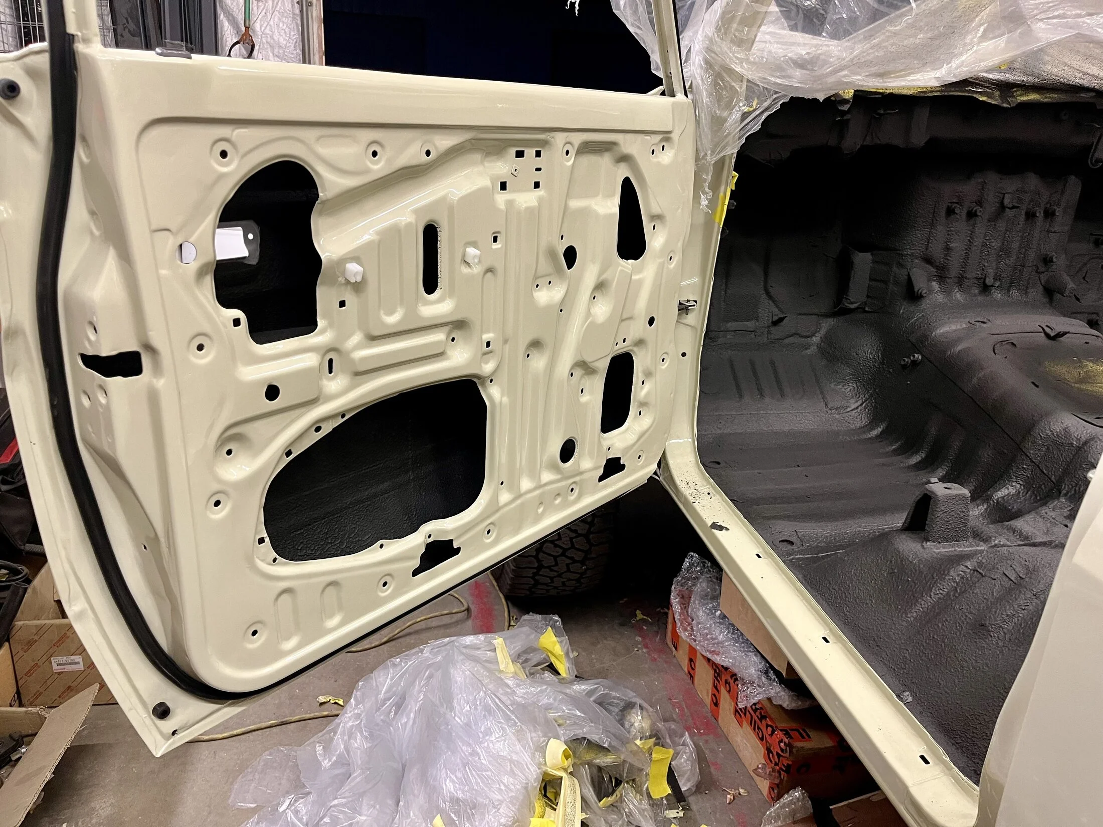

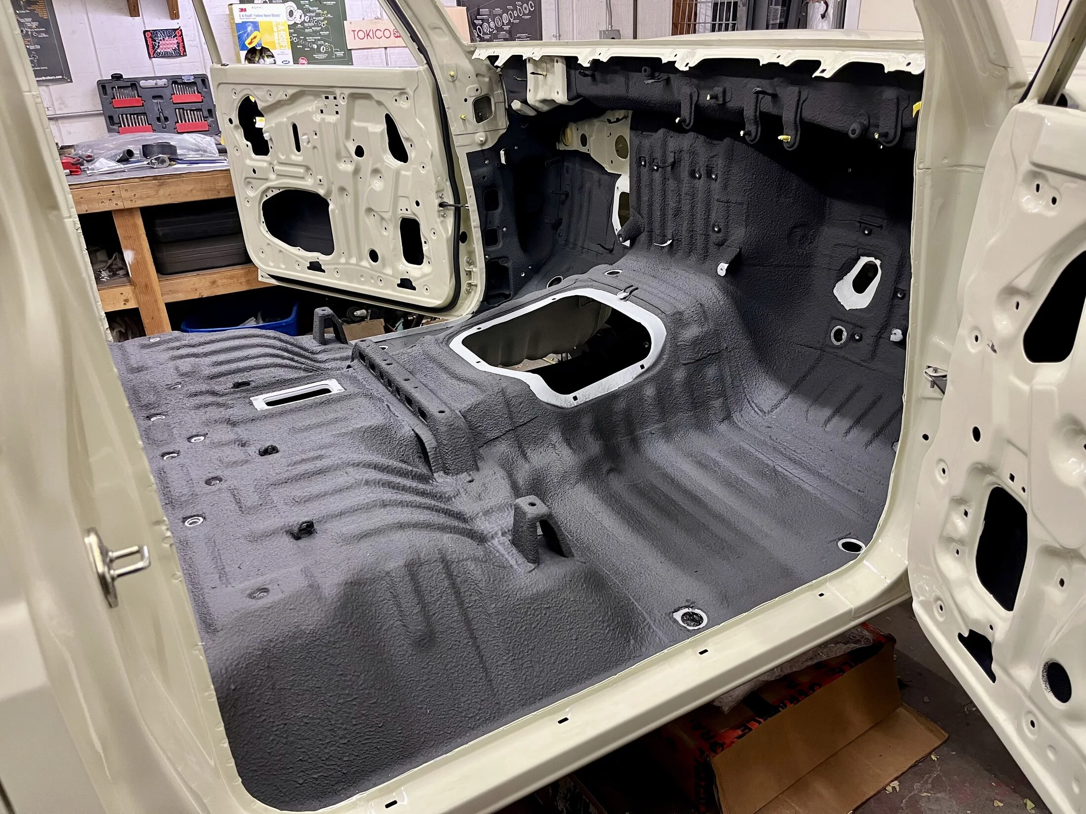

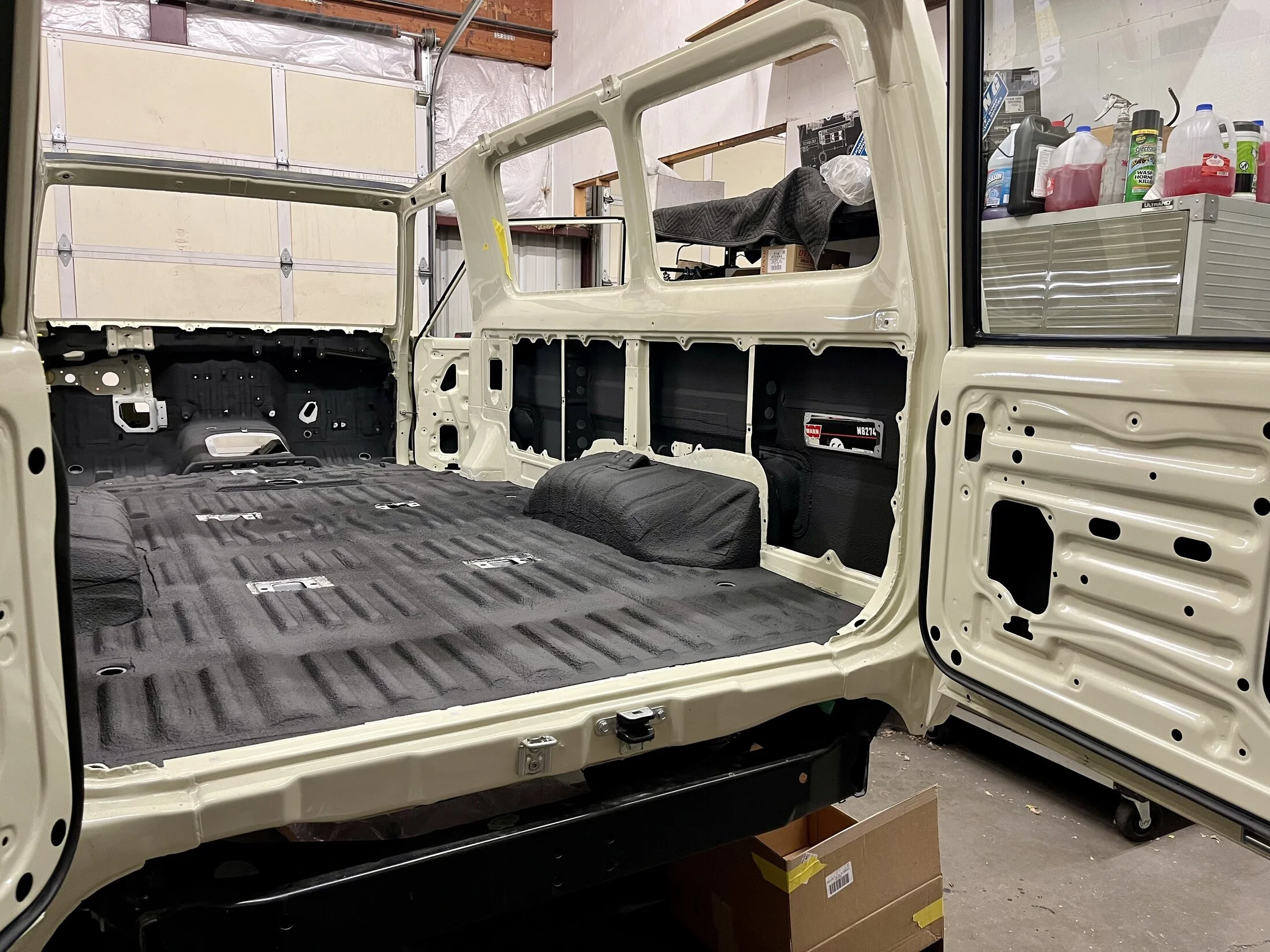

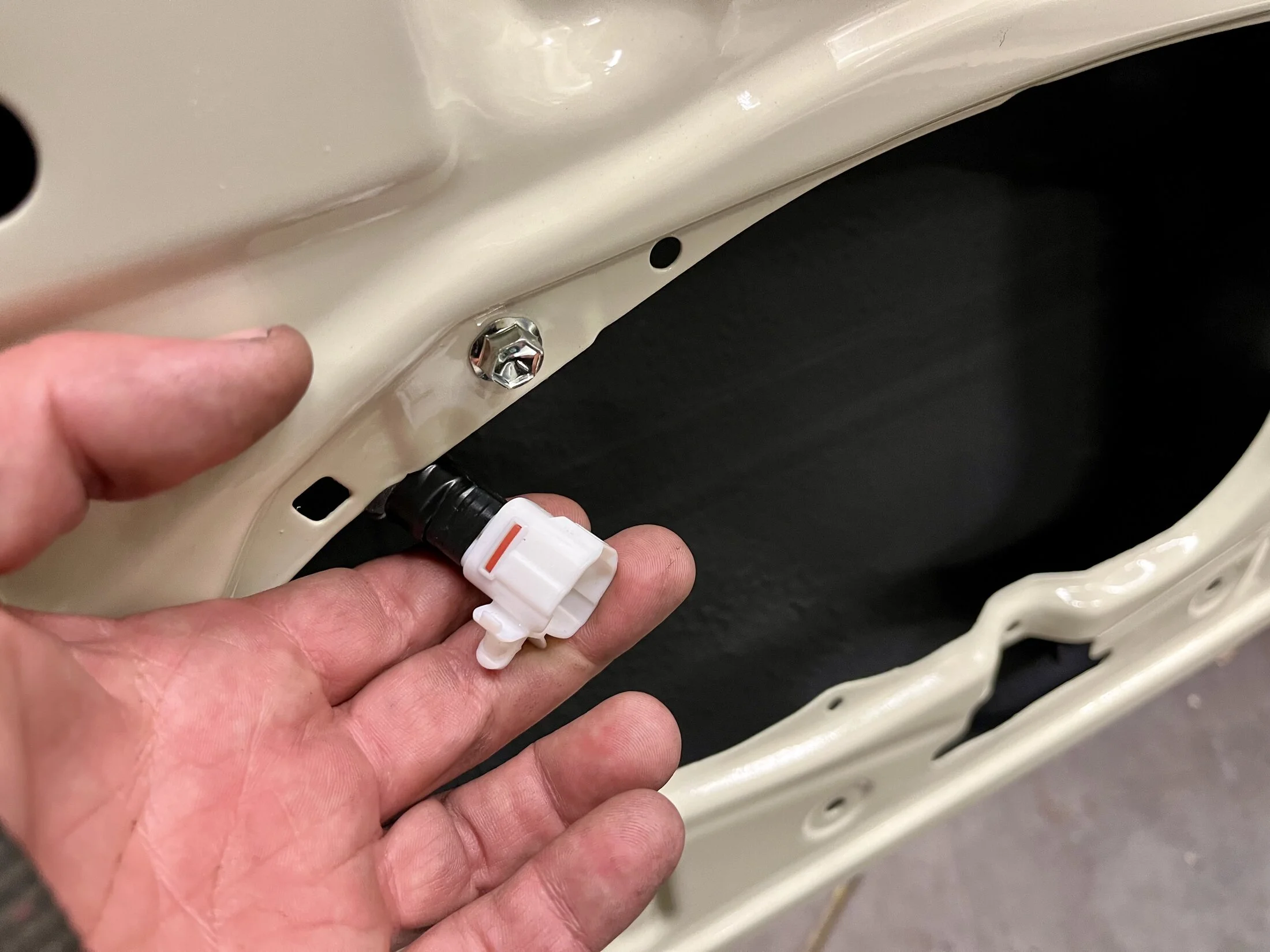

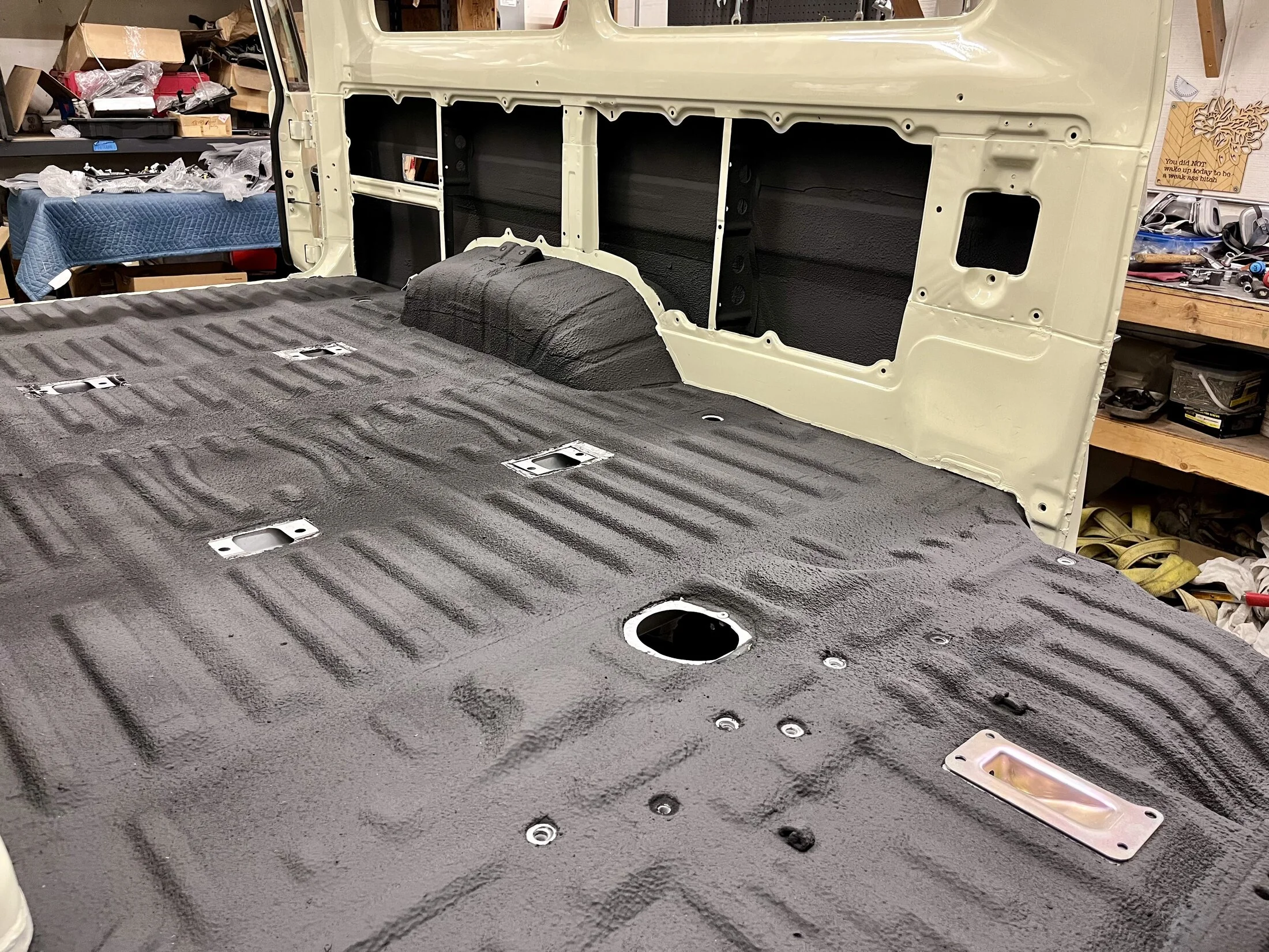

Now the fun begins!
Put the mats in quick style for my old knees.
Something this Troopy never had in its previous life.
OEM goodies!
Cheers

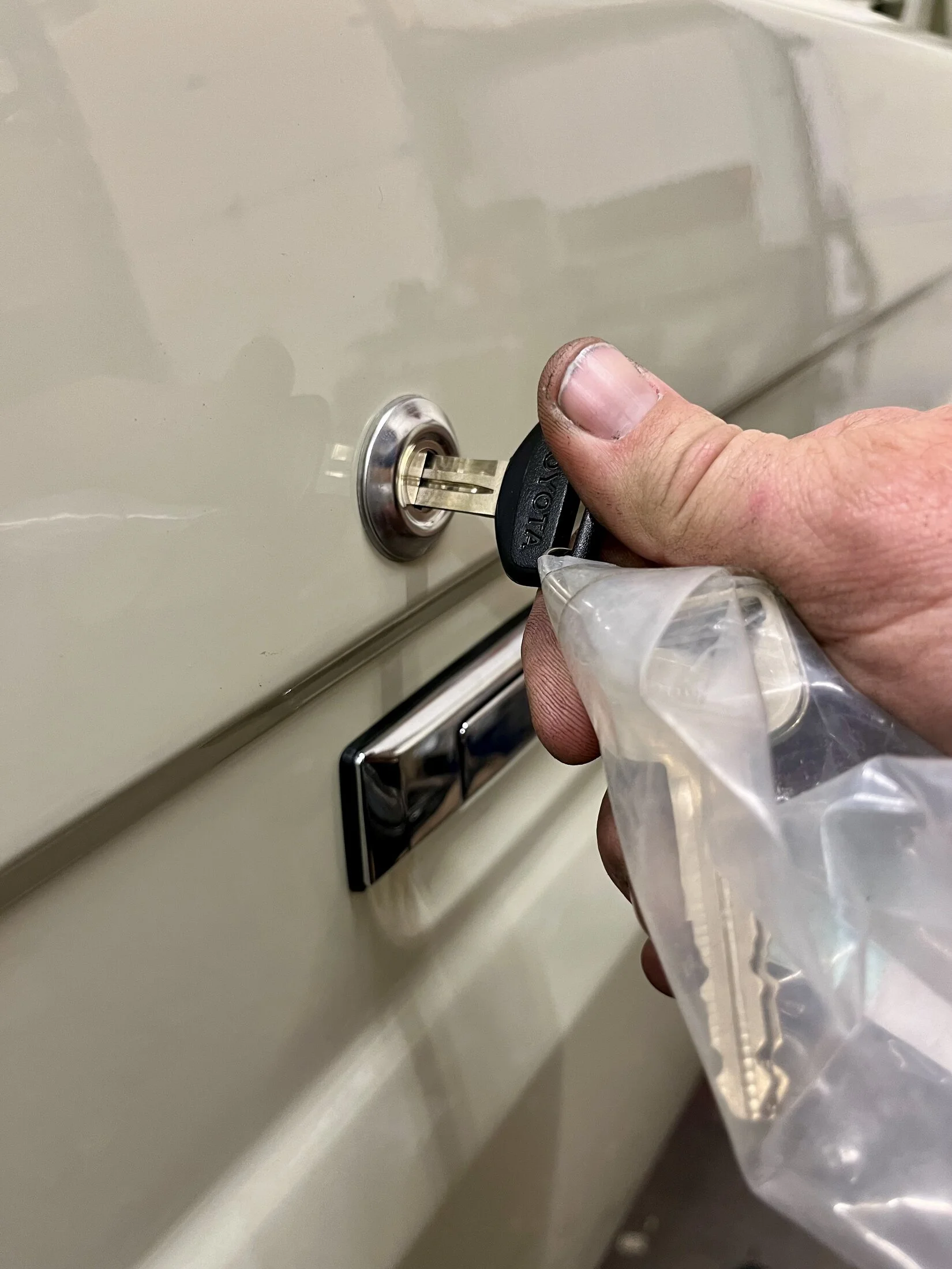

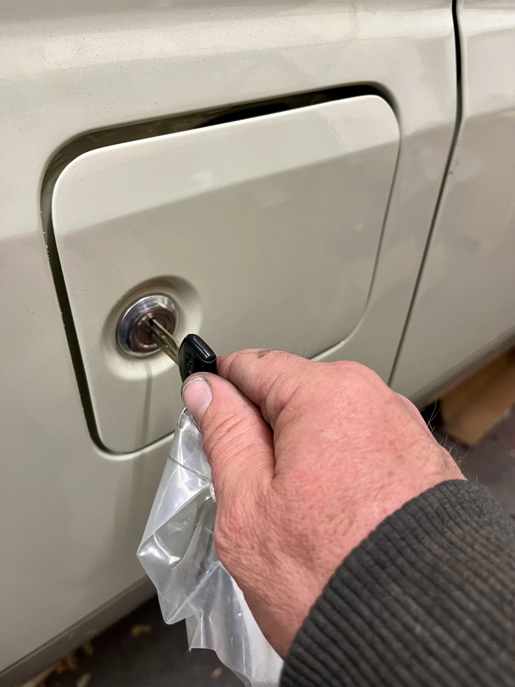

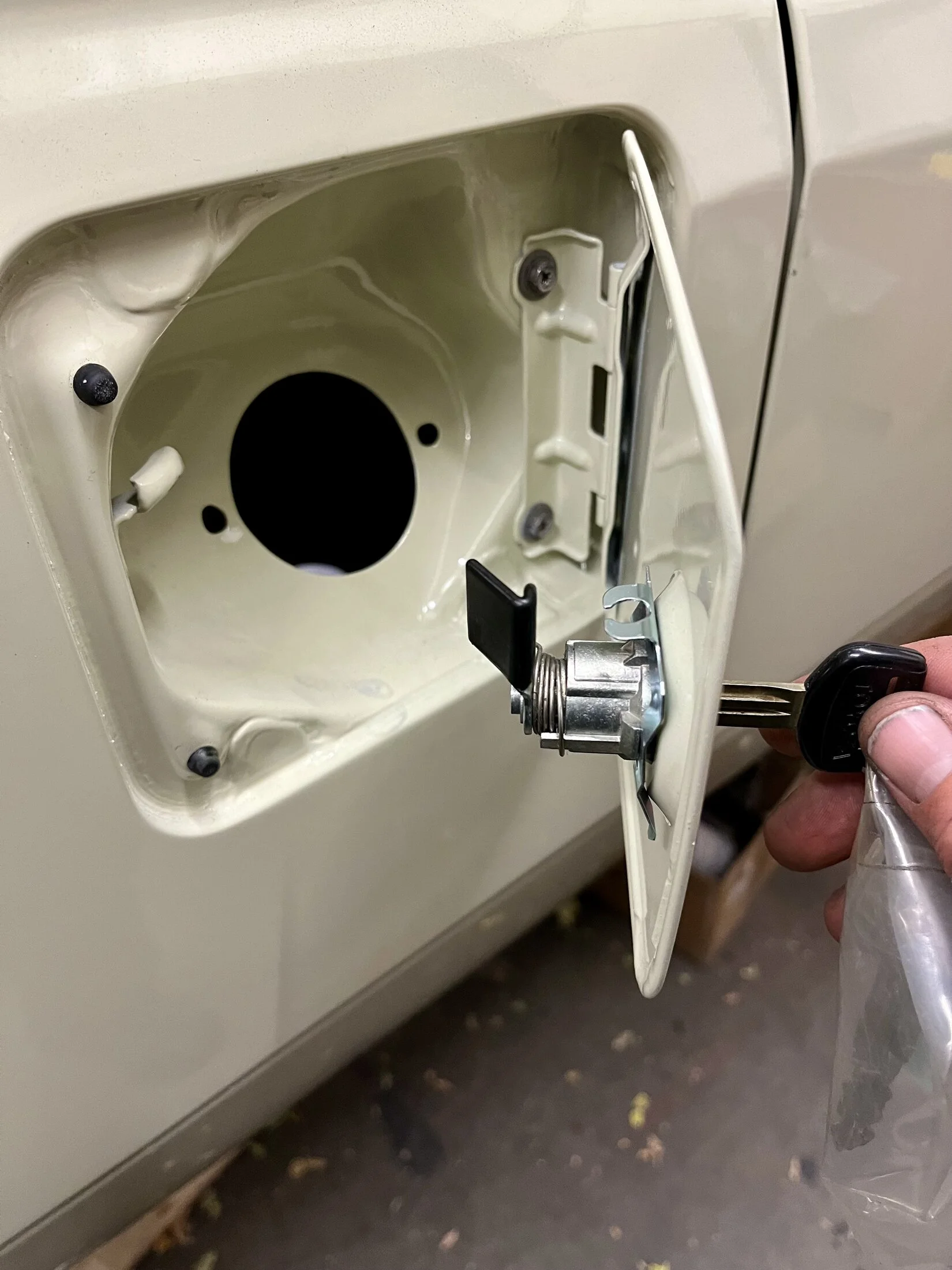

One key to rule them all! 😋
More OEM (micro) goodies.
My Shiba (he is Japanese) approves! 🐕

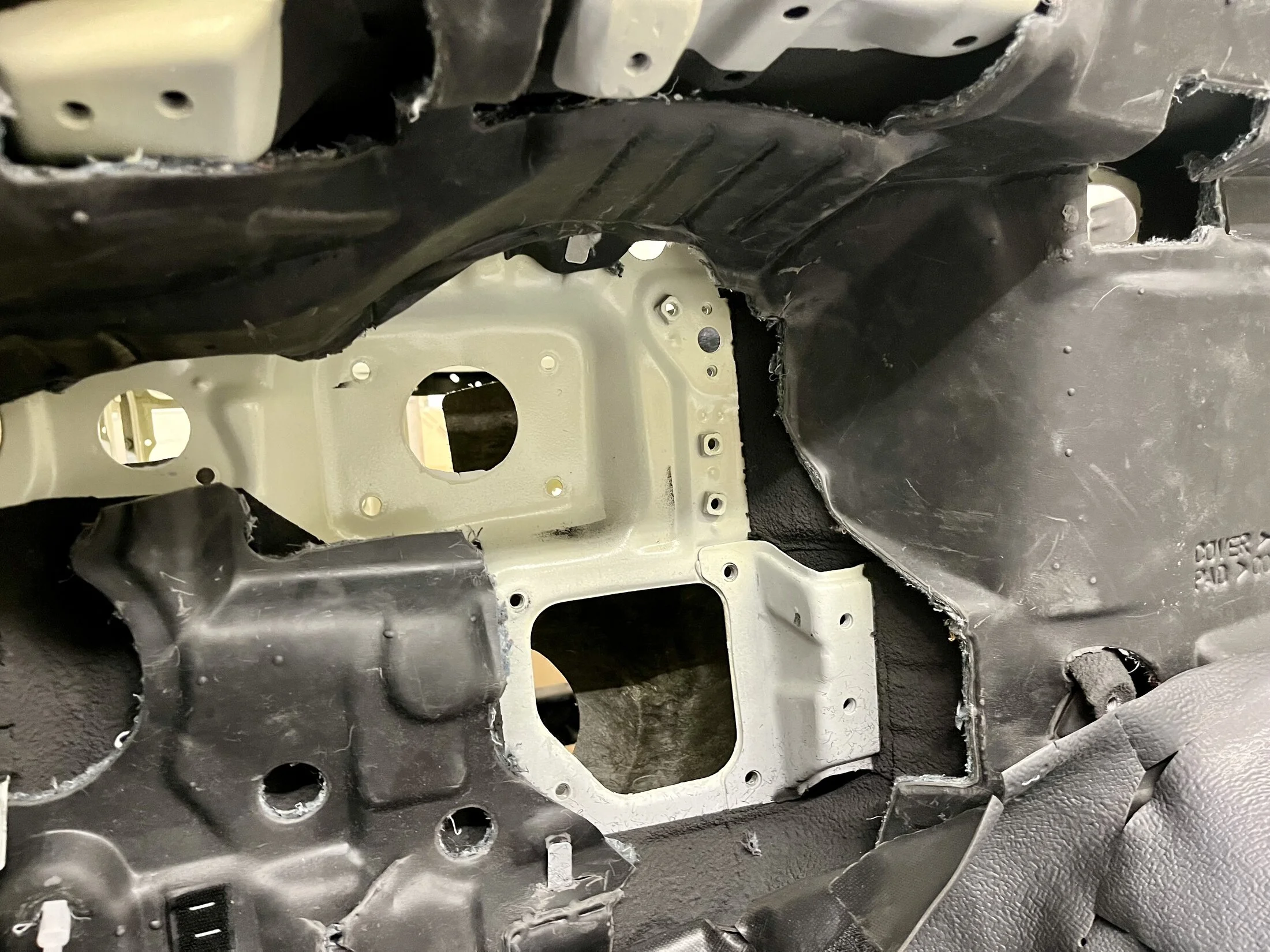

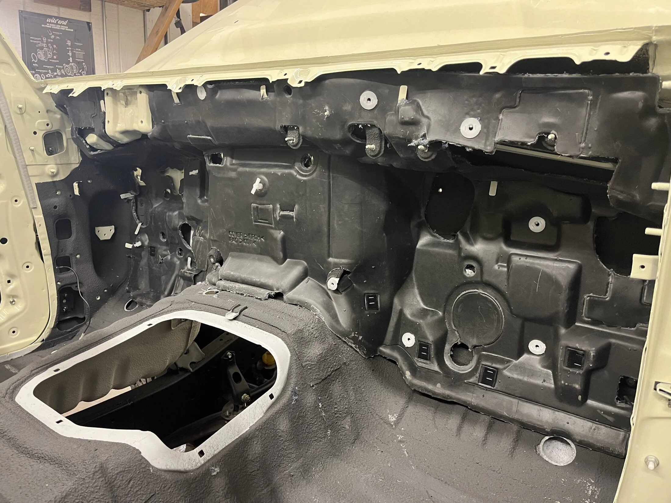

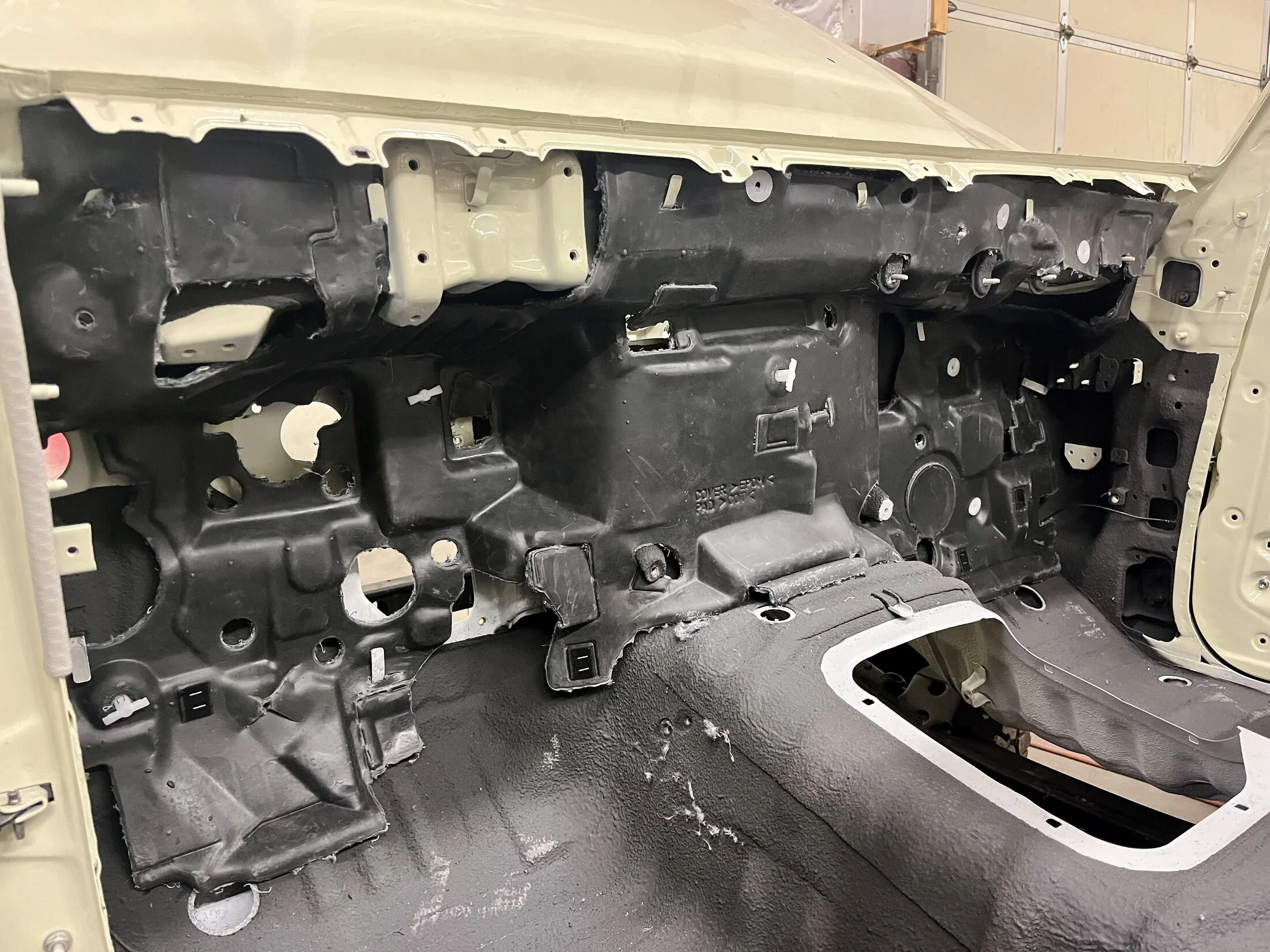

OEM firewall pad.
Now that is for a 2020-ish 78/79-series. The original 75-series is NLA. It will take a little bit of trimming but it fits reasonably well and is a nice finisher for the inside of the firewall.
Cheers

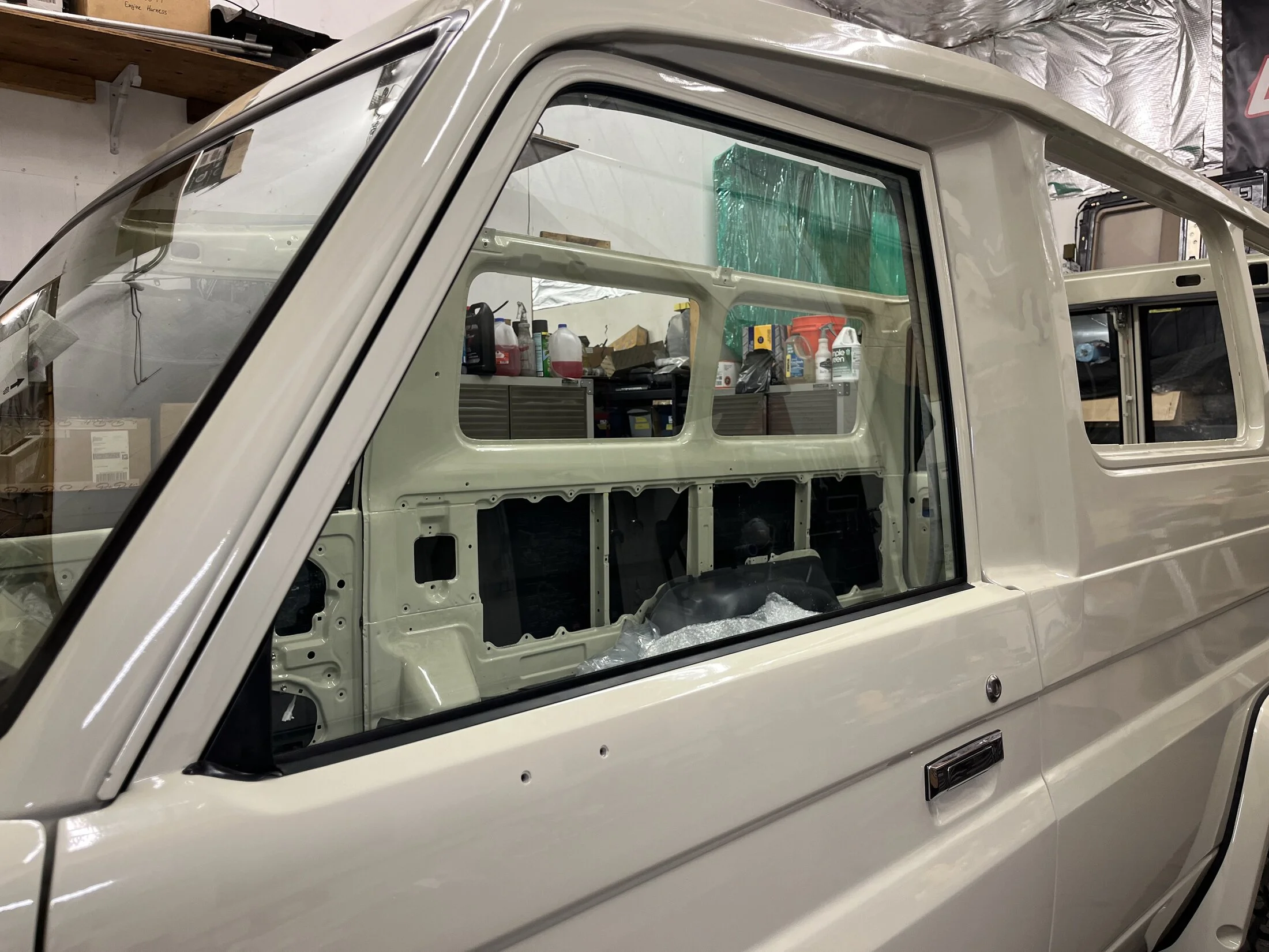

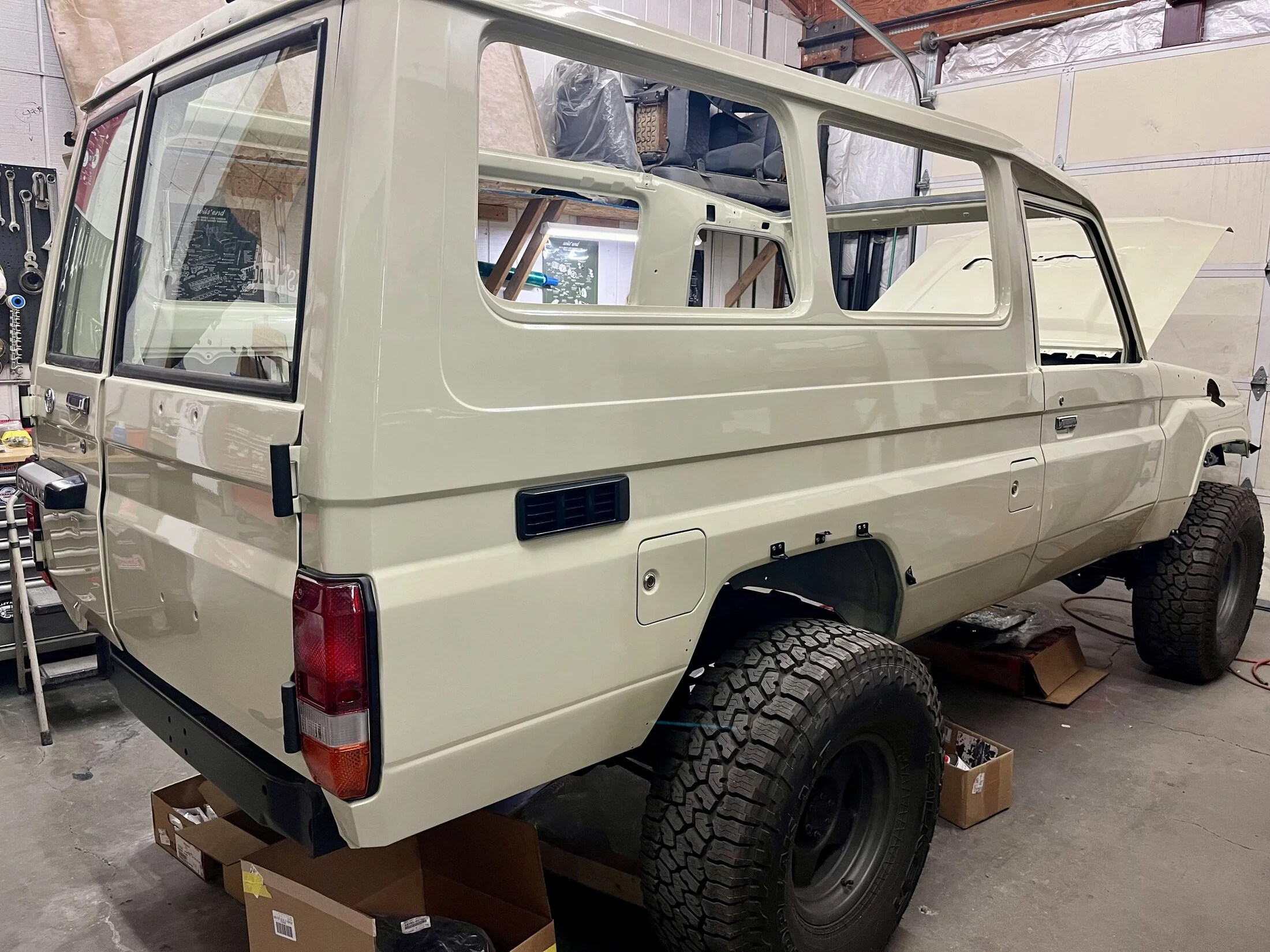

I ❤️ final assembly! 😋🤌

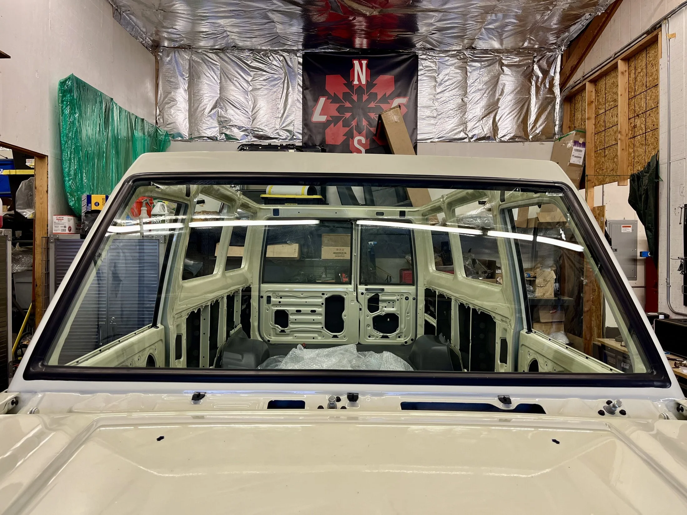

New OEM windshield going in tomorrow, going to try and get the Alu-Cab on by end of the week.

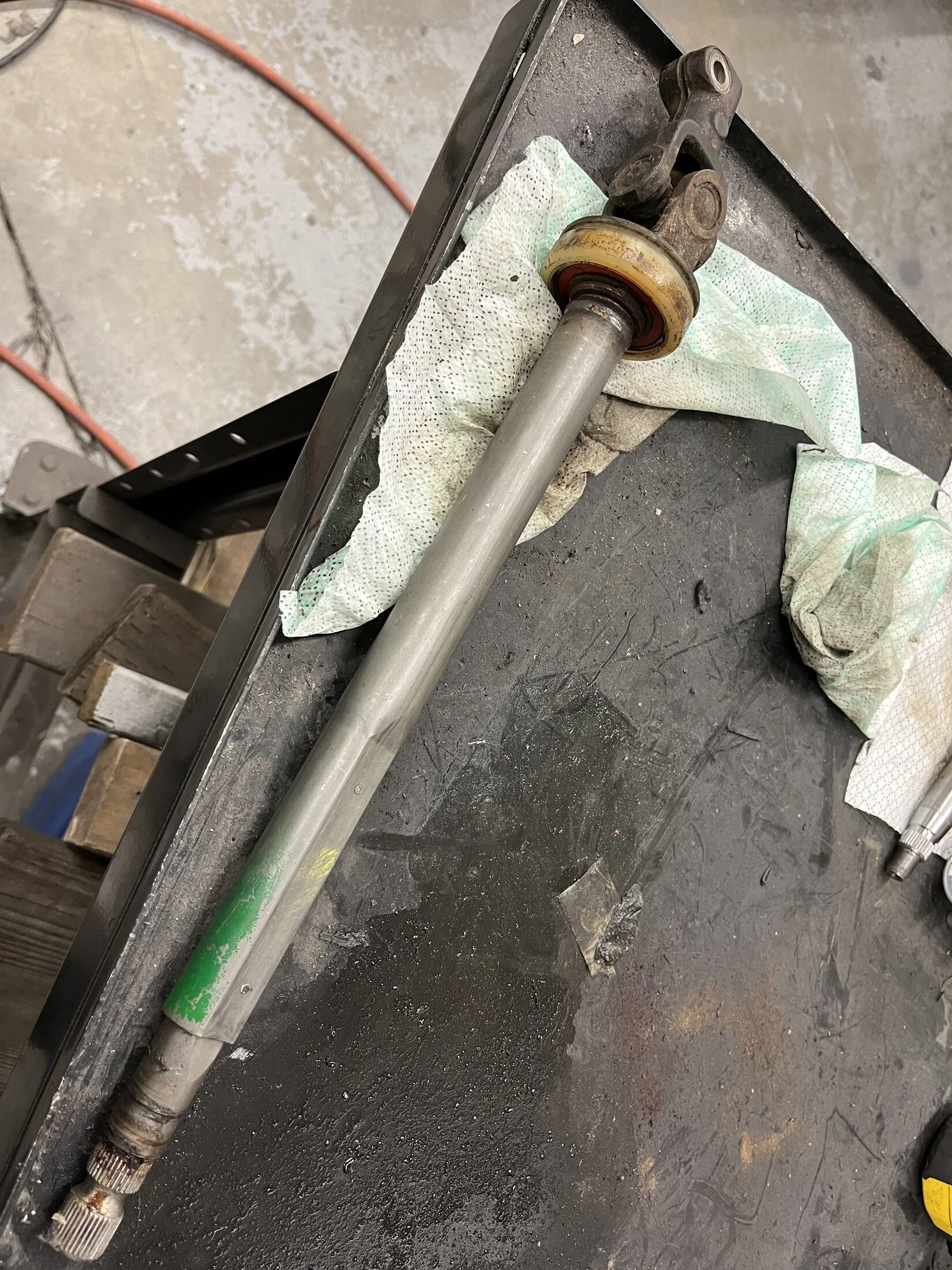

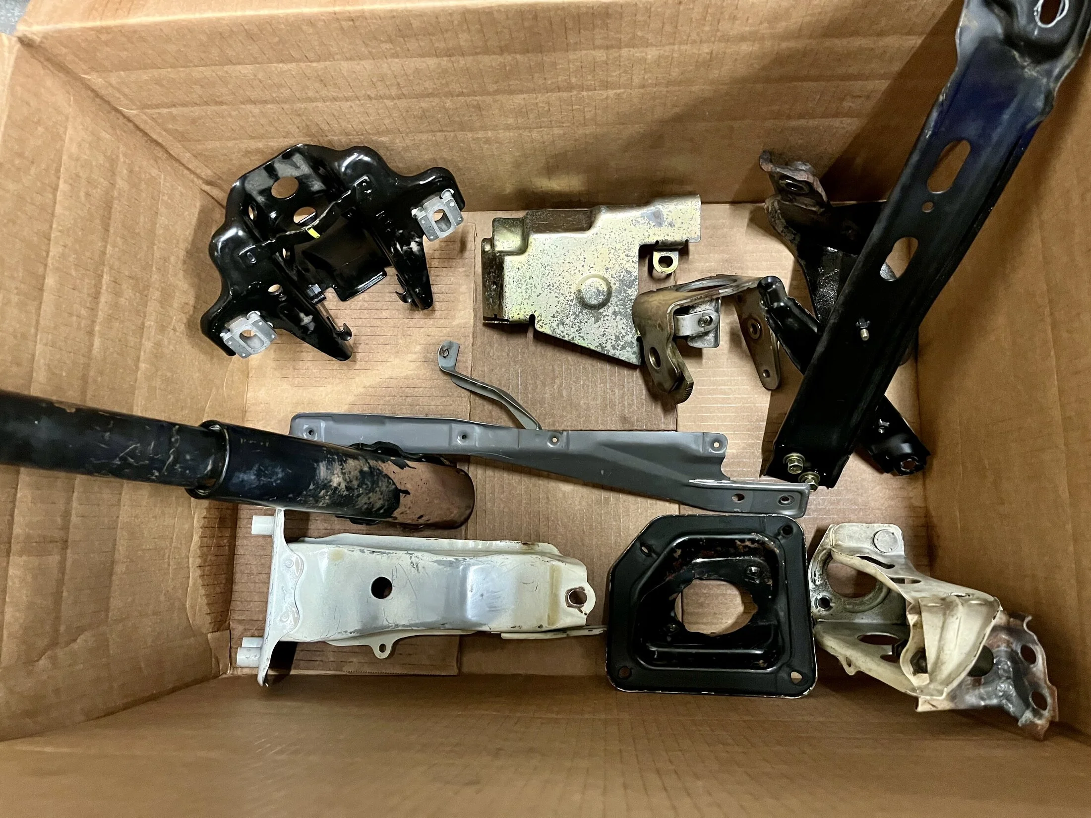

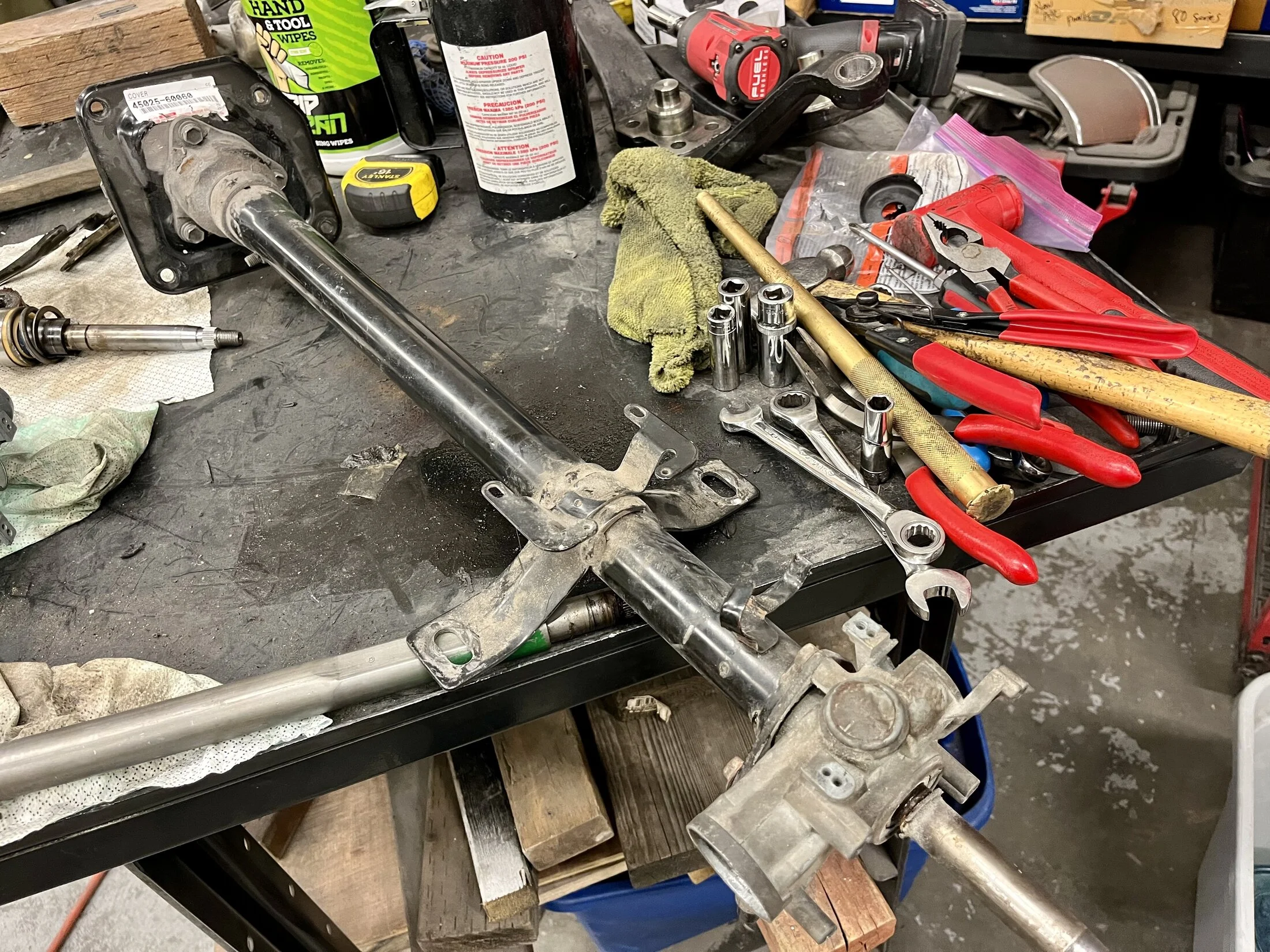

Not sure I mentioned it before but the Troopy originally had no tilt steering column.
We decided to upgrade to a tilt column so I got this one from @joekatana

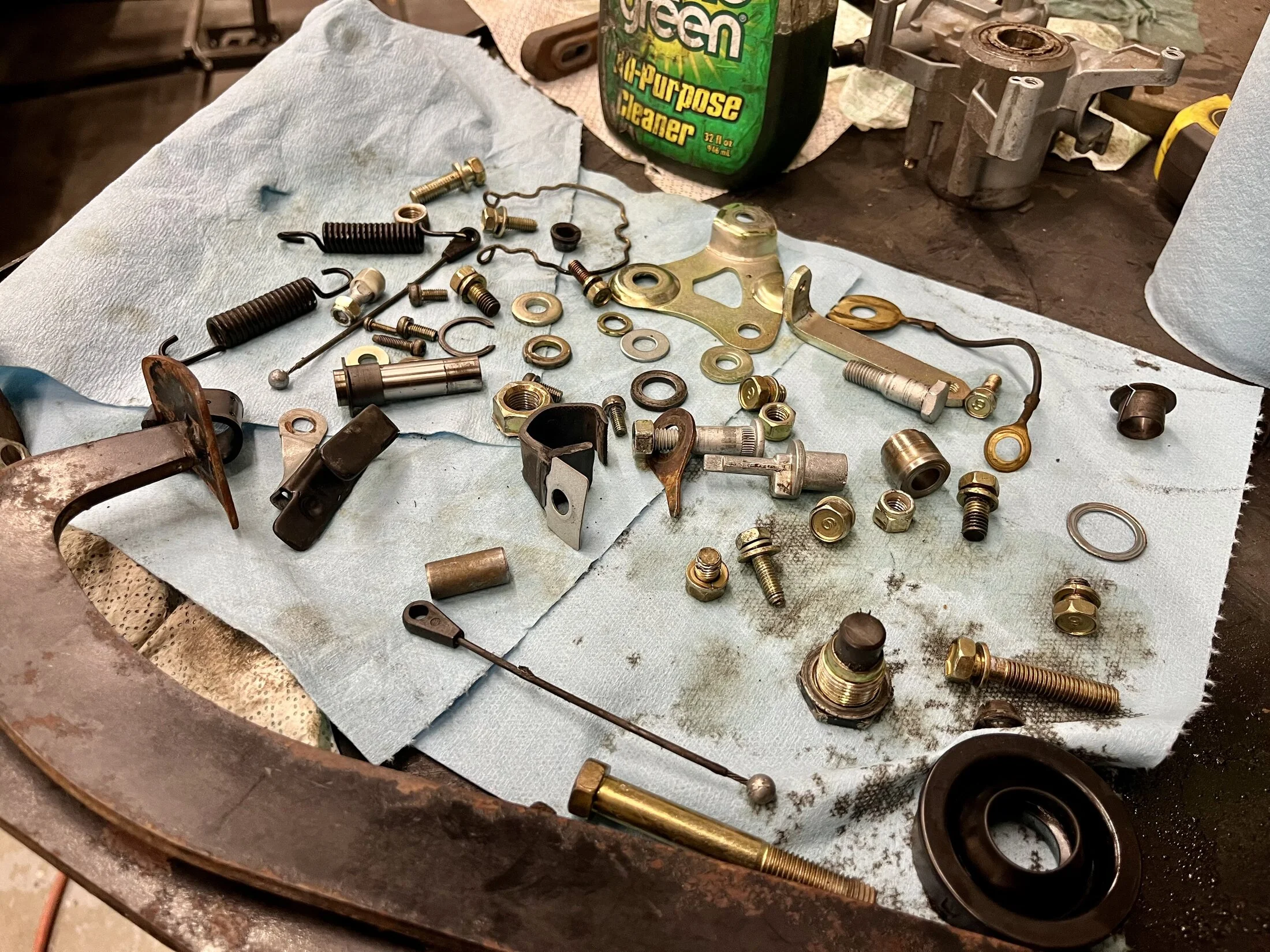

It is a good column but we want to refresh it so I tore it all down.
These parts are ready to go out for power coat.
Dash firewall pad got trimmed to suit the 75-series firewall, I think it came out good.
Cheers

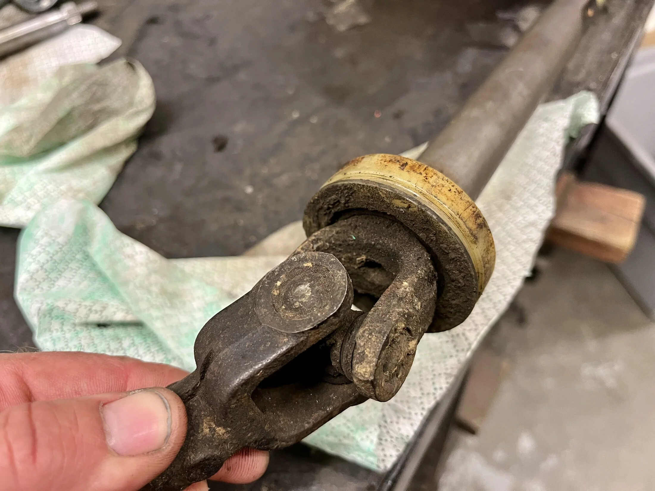

This joint and shaft (the u-joint is welded to the shaft) was the only one not in good shape. There is no play in the joint but it is real crunchy. So I ordered a new shaft that comes with the joint. A few bearings and some powder coat and the tilt column will be rebuilt and ready to go for decades.

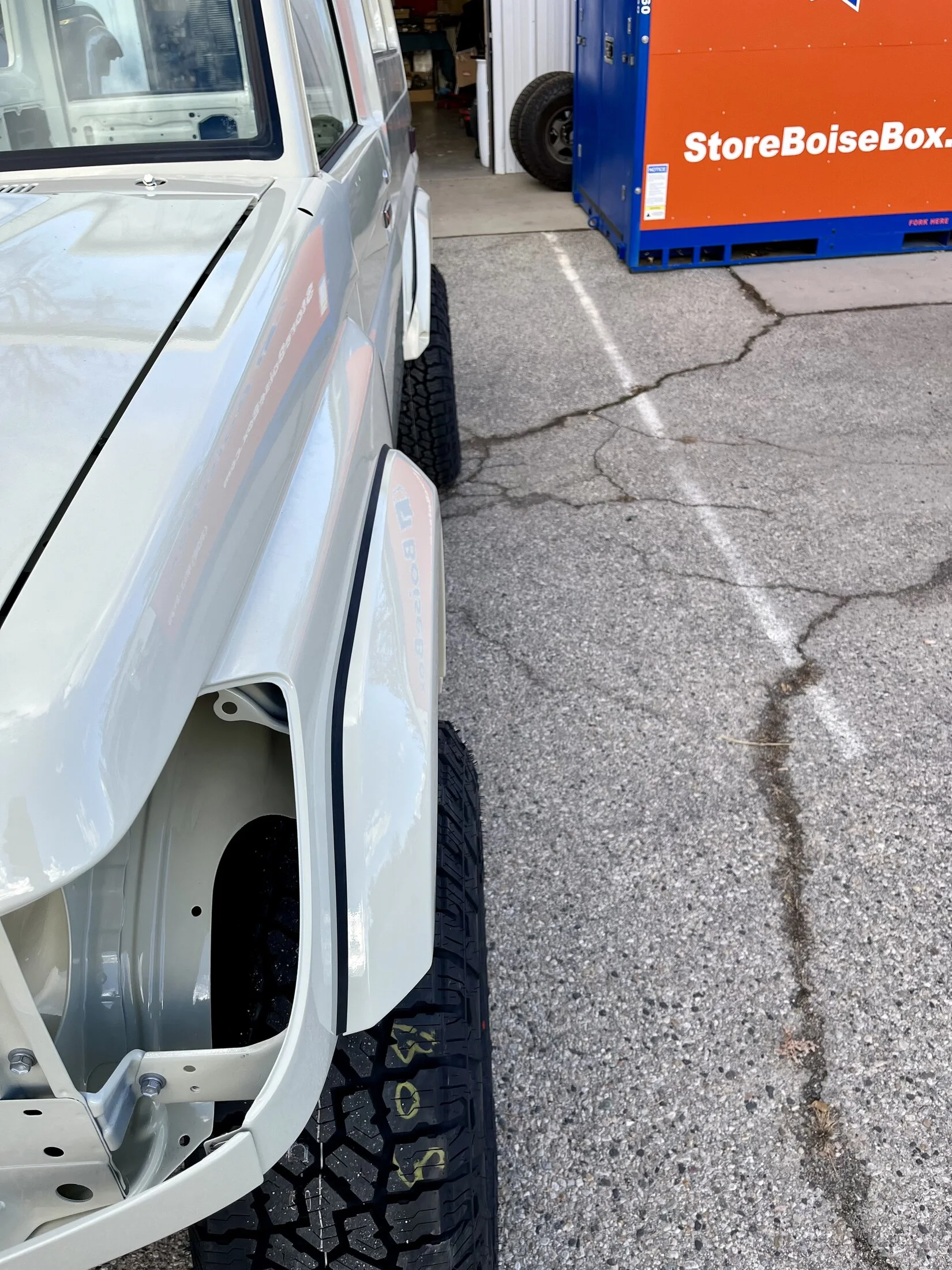

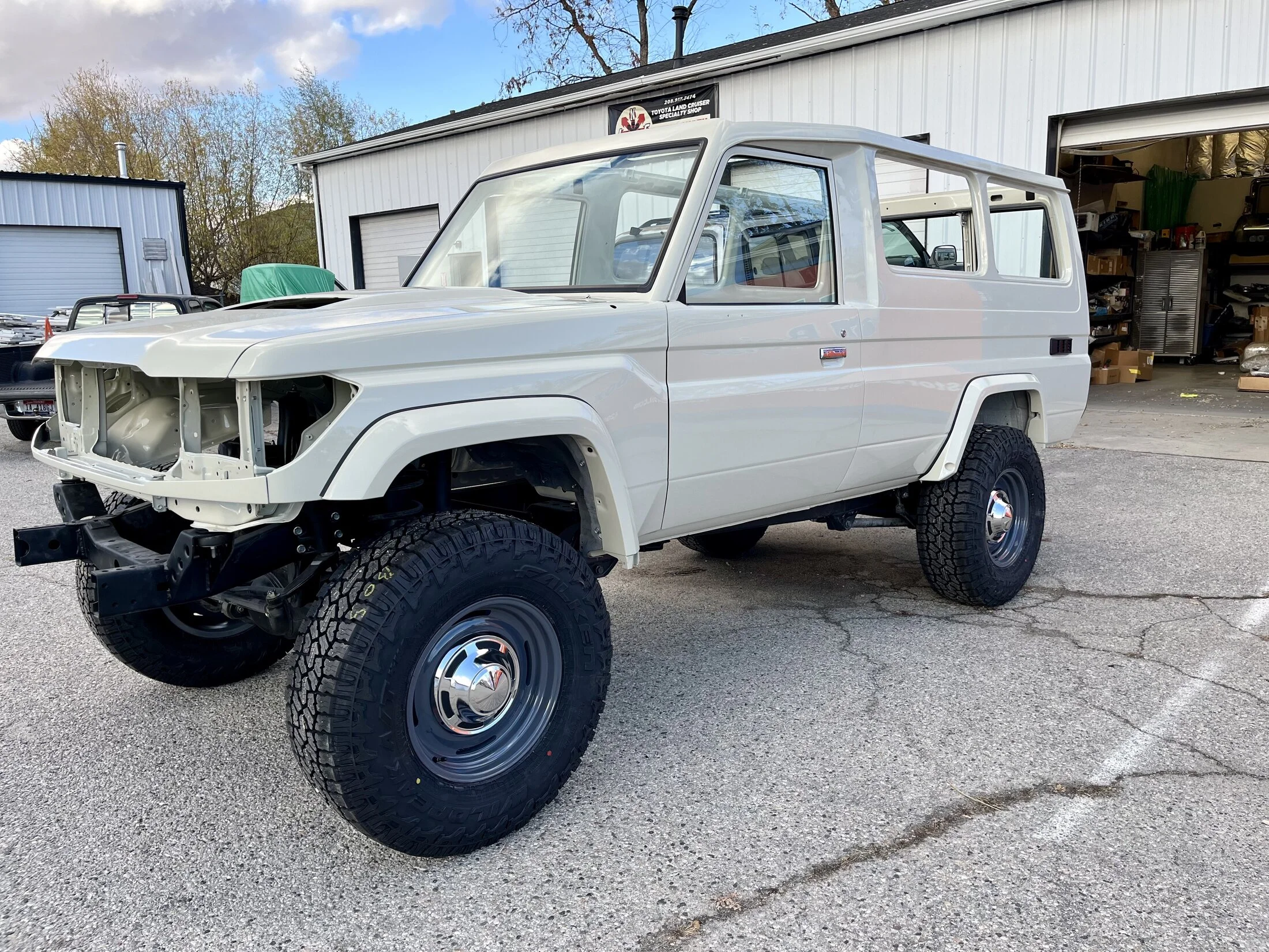

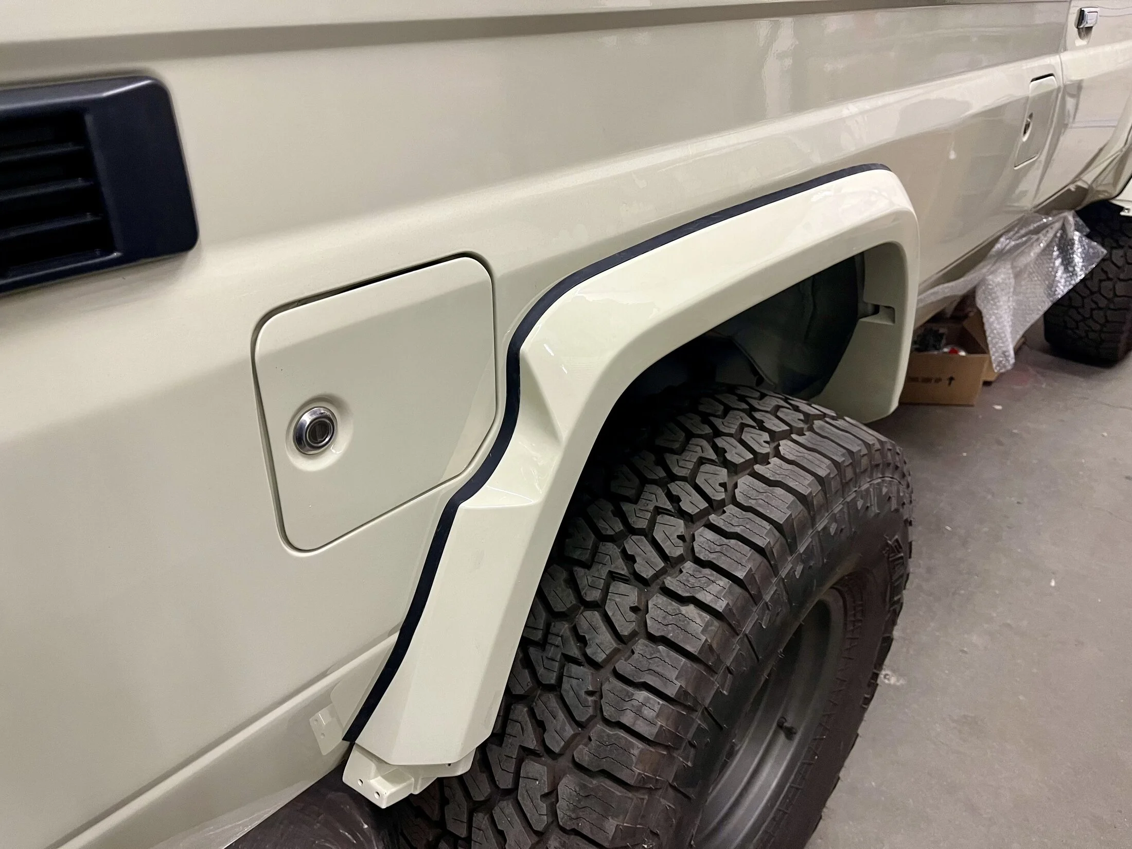

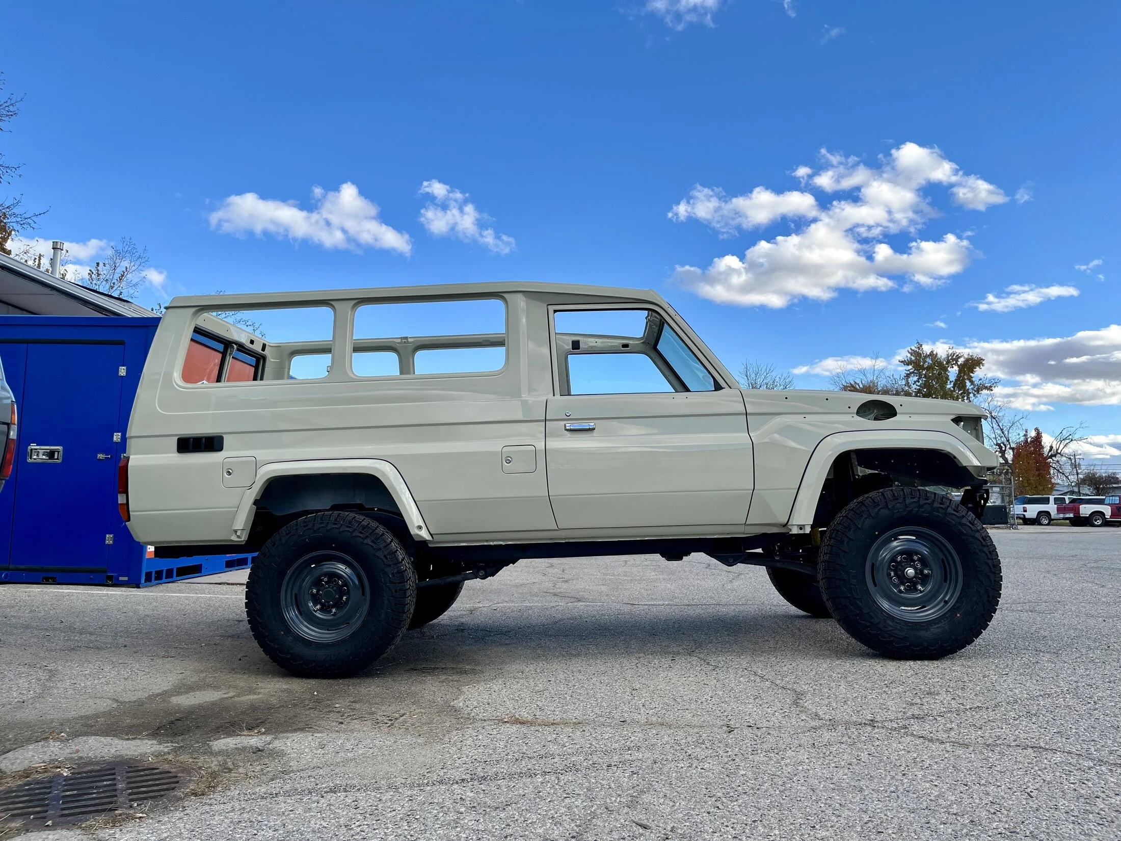

Fender flares!

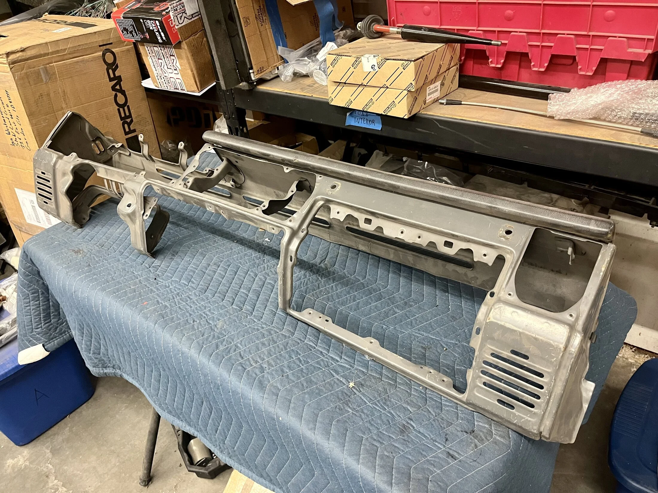

It was decided to do the main steel dash frame in satin black powder coat so cleaning it up and sending it out with the rest of our parts for powder.
Cheers

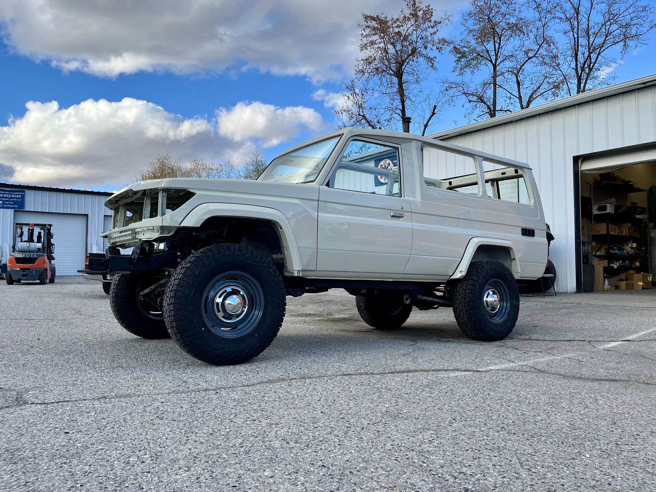

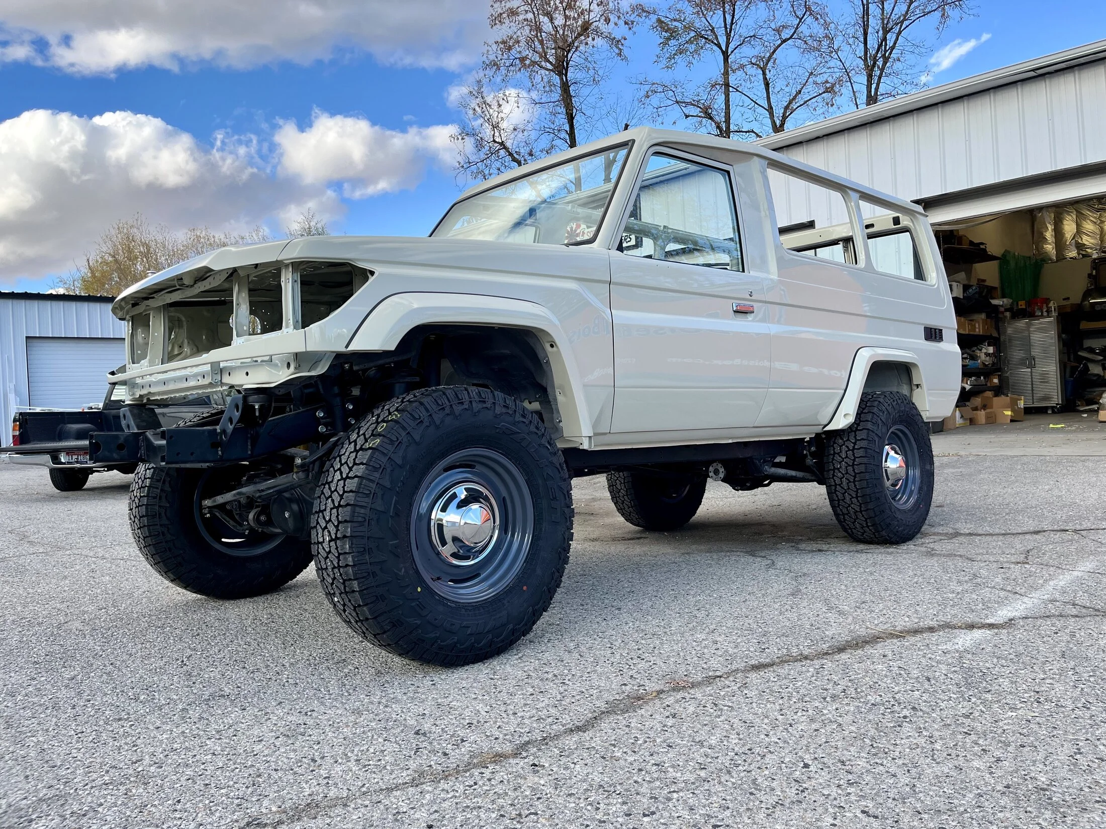

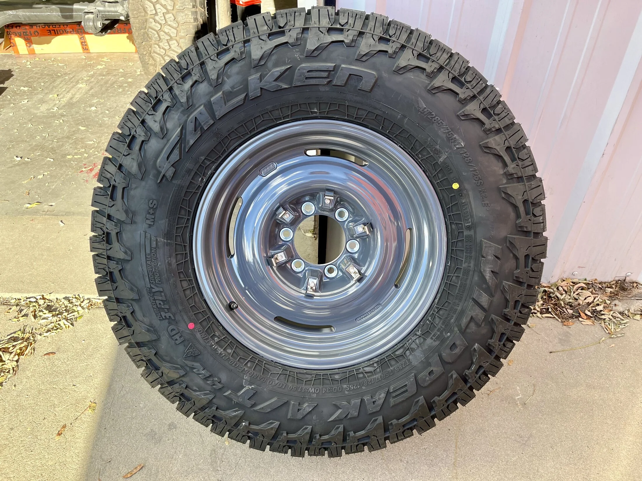

Wheels: FJ Company 4Runner/Tacoma 17” alloys with 4.75” of backspacing, 8.5” wide.
Tires: Falken Wildpeak AT in 285/75r17
