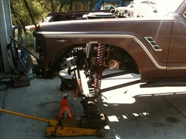

Version 1.0 served me well as a trail rig. I do a lot of work for the USFS so it is not an extreme wheeler. I have an FJ40 that I started to build into a buggy and it has been moth-balled for now. Life got in the way. This rig suits my needs better right now. Here's 1.0

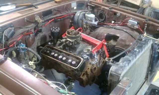

This build will use some parts I had collected from the 40 project and some new. I bought a 91 Caprice that was an old Sonora cop car for the V8, harness and trans. This is not an LT1 car. It should have a roller cam and a little hotter tune from what I hear. In either case it's complete runner and for $650 makes more sence than an LS based motor. Enough jibberish on with the pics.

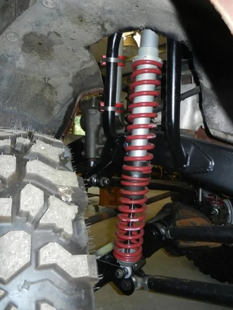

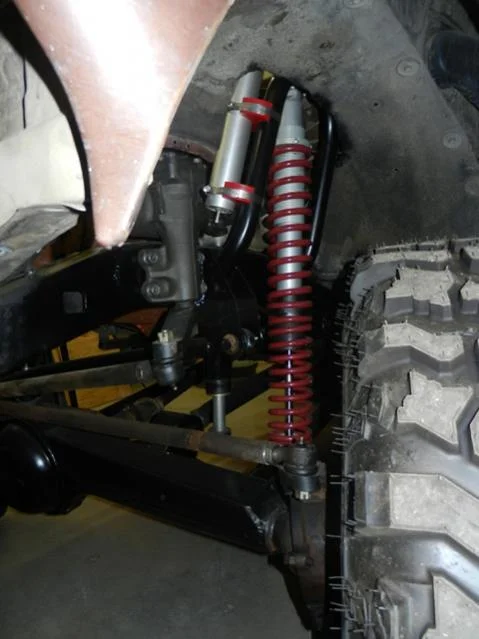

You going to support those shock towers more?
I think so. But I need to get the real engine in there with all the smog and accesories on first.
Leave it to you Mace to go right to the meat of it. :cheers:
I just know what it feels like to have a front upper coilover mount let go ;)
I'd also taper the lower frame side link mounts. It makes it easier to slide over rocks and distributes the forces over a wider area.
