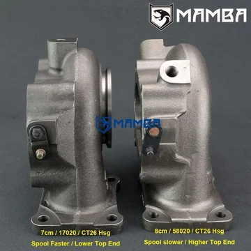

I thought some people would find this interesting. I have said in the past that i believe some manufacturers make errors for the correct casting numbers:
In the case of the Mamba turbos
7cm housing (.49 AR)
8cm housing (.64 AR)
The funny thing is the last few turbine housings I have bought from the one manufacturer definately used the 7cm housing if comparing to the mamba turbos and the factory 1hd-ft turbine housing. Though their numbers are backwards comparing to the two housings I have.
