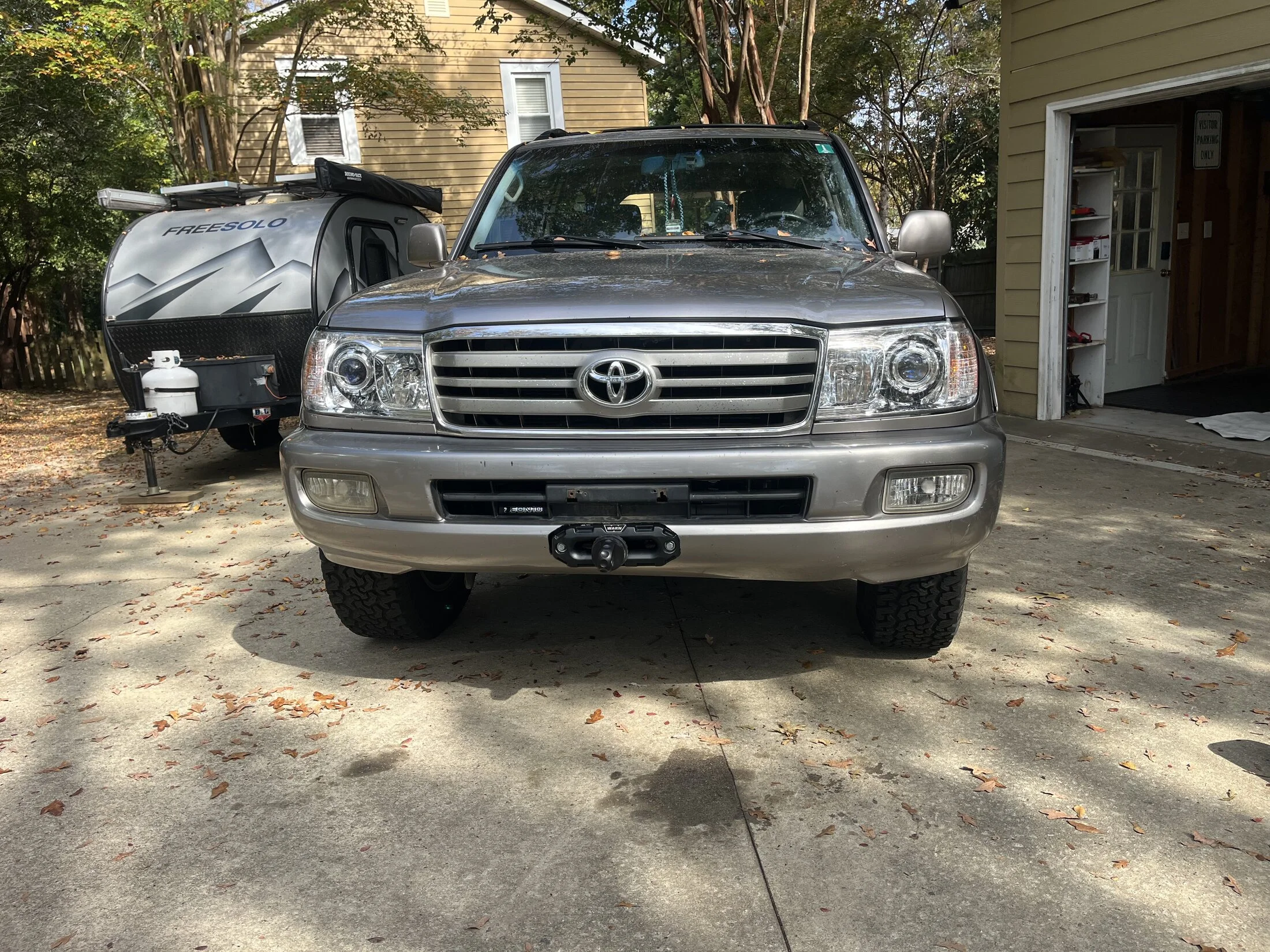

Through a connection got this warn winch for dirt cheap. As a result got a TJM winch mount inbound.
It’s steel cable though.
What’s folks running for synthetic winch line nowadays?
Don’t wanna mount it till I get it respooled up.
Update time
Got the TJM winch mount installed and some
3/8” synthetic line from TRE (tactical recovery equipment)
Everything mounted up easy and had to just cut the center out the crash bar mounts.
Got it wired up easy enough and everything fits like the same.
Next is some step sliders.

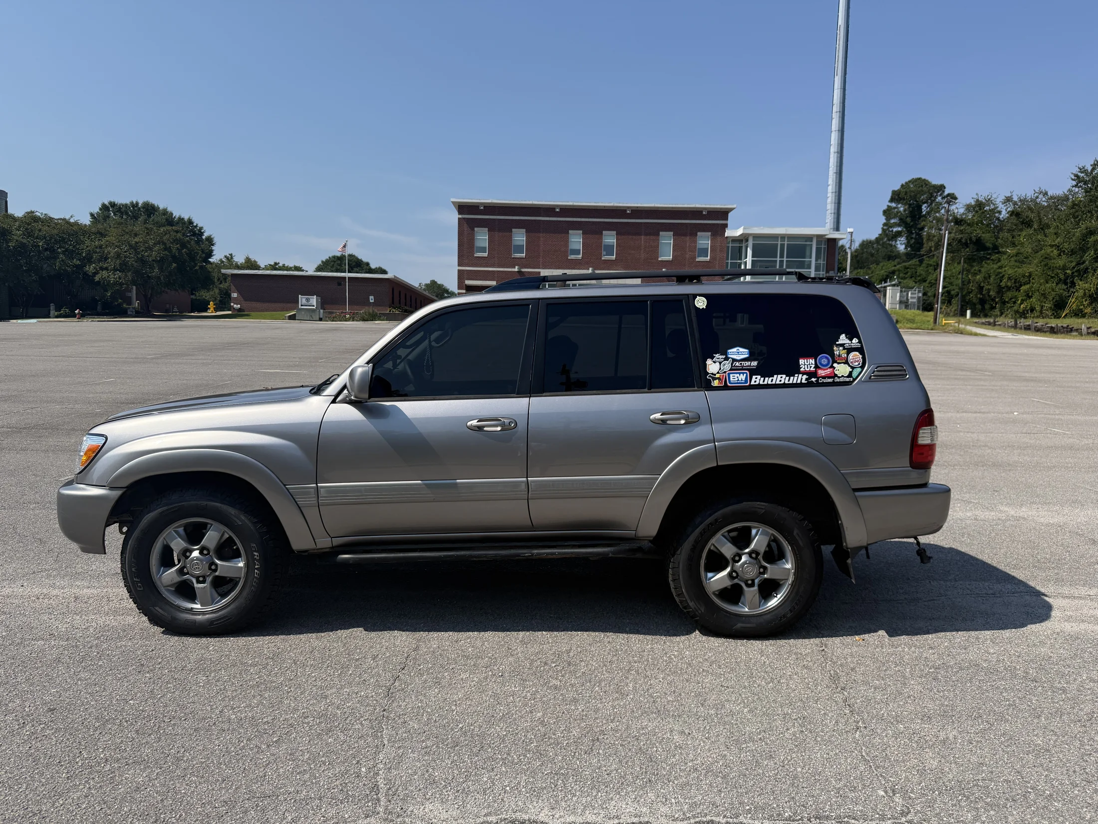

Got some budbuilt sliders installed. Beefy some bishes and didnt even use all 6 of the bolts on each side (5 was sufficient and didnt feel like drilling any more really lol)

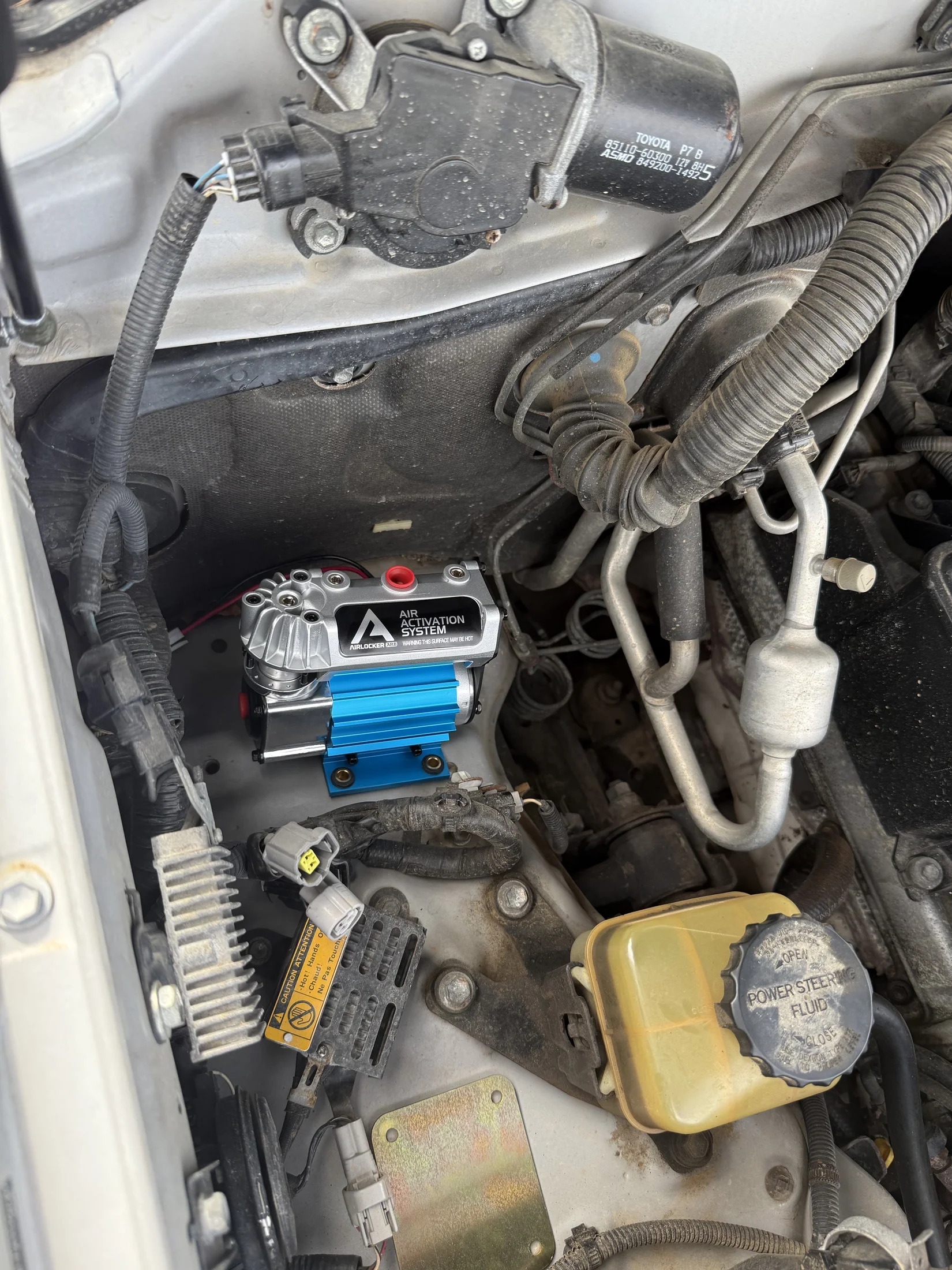

Went to East Coast Gear Supply yesterday to get them to install an ARB rear locker in the rear.
Didnt have them install the compressor or air lines as it was something i could do.
No issues driving back home and now gonna take next weekend to install the compressor/airlines / and the OEM locker switch from the 80.
2400$ out the door. Super fair and knowing i'll have a 5 year warranty/tech support makes it even better.
Only advice I have is to use nutcerts rather than bolt through the fender. Also, where your compressor sits is a common location for a second battery so if that's in your long term plans, you might want to mount that compressor somewhere else from the get go. Slee makes a pricey but elegant second battery mount that had a location for the compressor on one side, I've always thought it a well conceived and well executed solution.
Yeah I’ve got a tear drop camper I tow to camp and such so I have no need for any accessories on the truck.
It’s a good spot then? 😂
I’m def gonna drill some holes tomorrow and test fit.
Nutcert? What’s that
Its a tool that will insert a permanent threaded fitting in the metal. Its basically a threaded rivet

Overall the experience was good and wheeling the 100 on the east coast was comfortable. Almost don’t want to wheel my Tacoma anymore haha
Tore a sidewall on one of the blues on the last day so the gluetread was whipped out and got me to camp so I could put the spare on. Took that as an opportunity to cash in my free set of Firestones
Opted for destination mT2s in 275/70/18.
Fit like a glove, no super noticeable performance losses.
Don’t want to cut anything on this build as it would go against the OEM+ vibes I’m going for.
Should be a noticeable improvement when I go wheeling next year but for now that’ll do it for now.
