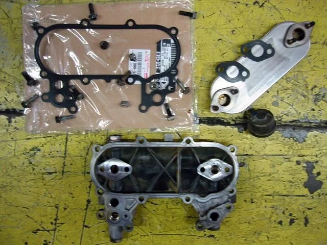

Here are some shots of Ali's favorite part of the block: the oil cooler. Behind mine I found some nasty. Not sure what happened in there but I do know that it won't happen again. The upsetting part is that is what my coolant passages look like :o

The color is interesting...sorta orangeish? The oil cooler section is often overlooked by HG workers, glad you took the time to clean it. Otherwise, I'd have to give you some grief!!!
