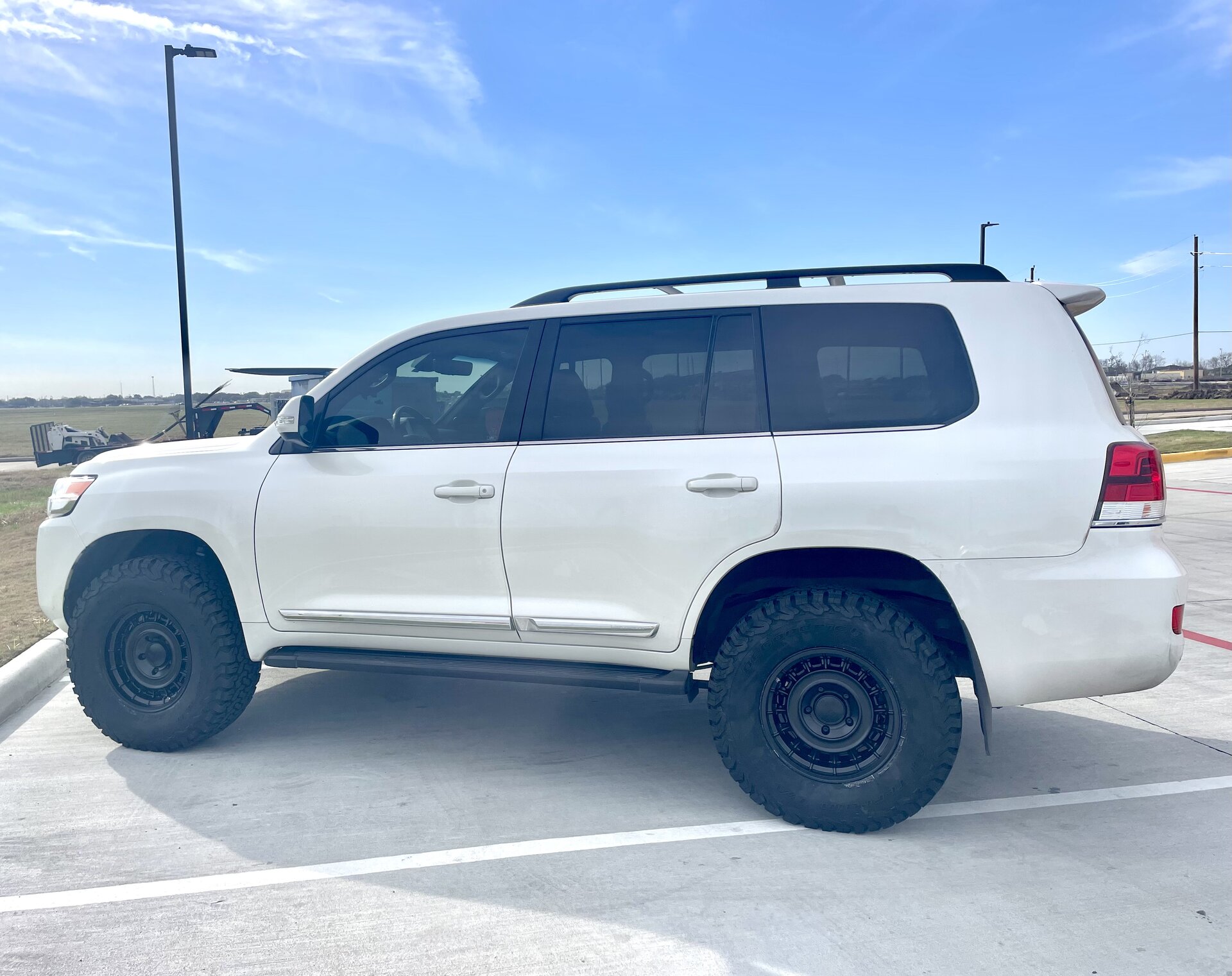

A few adjustments still need to be made but here’s a quick parking lot snap shot post wheel/tire install. 285/75/17 KO2’s on Nomad Arvo 502’s.
Post lift.
Man I really like the look of those wheels, but zero offset with that much rubber doesn't seem like a recipe for success. Have you had a chance to flex the suspension with those yet? Any rubbing?
Fully stuffed with the wheel turned halfway I can get it to barely touch the body mount on the passenger side with the edge of the outer lugs. Lots of guys running 0 offset these days with 34’s.
