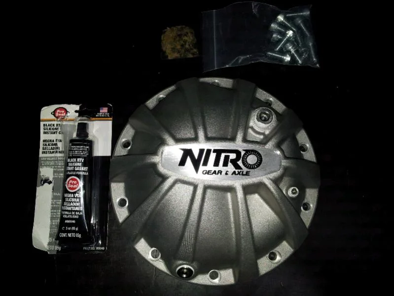

What a sweet thing I have as late Christmas gift for my lovely Tencha
Thanks Carl this is a real solid alum cover..

Cool! Ive been thinking about getting one of those.
Won't work on Land Cruiser axles, seems to be for a domestic axle...
I would report back when installed .. and honestly my first though when see the price was " pricey " but dude .. gotta admit .. having it in my hands must tell it worth every penny ..
https://forum.ih8mud.com/jts-parts-...treme-diff-covers-semi-float-landcruiser.html
Yeah it looks beefy as HELL. i may get one for my locker install, just so i can look at something new and shiny and pretty...
Nice David. I like that it has an upper fill and a check hole too. Hopefully you won't have too much run out at the check hole when filling. I figure they thought about that already and designed accordingly.

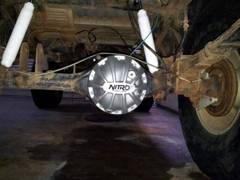

J
Despite my pinion angle and trying to keep pinion bearings well hydrated I need to be quite precise at my oil level .. or I'll have a mess coming out of your pinion splines .. I believe Mr. T never though in some dumb guy over filling the rear 3rd :D
Installed one :banana: job the kinda pita ( time consuming) pull all studs.. Did kinda mess I did.. ;-)
Sent from my big phone using IH8MUD
