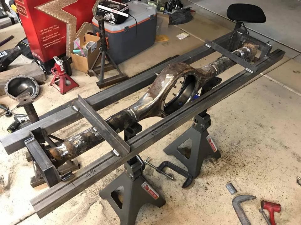

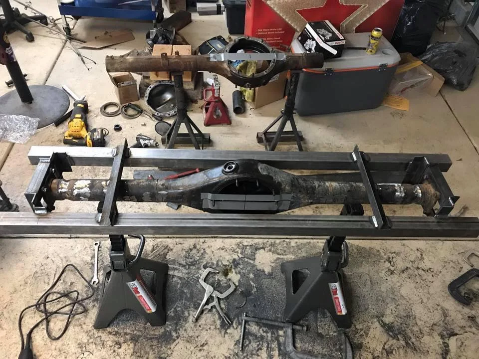

stolen from Facebook. I think it needs a plate to keep the diff mounting face square to everything else but a pretty good axle jig for cheap
That axle jig makes no sense. The cruiser pumpkin is bigger, therefore the axles tubes need to be pushed out wider to accommodate the difference between the two. Am I missing something does it slide out wider when you put the bigger third housing in? You don't need a jig to make a centered rear cruiser axle. I have done quite a few with and without an alignment bar. So long as you measure lots and tack evenly until its solid then weld it out slowly adjusting weld areas to avoid warping. Better to start with a first gen toyota housing as the tubes slide right inside the cruiser housing and use the shafts from an IFS rear axle. Woody used to have a good writeup on here.
I’m not super familiar with the 8” stuff but I can’t imagine the distance between the side gears being THAT much different between the 8” and 9.5” thirds. The jig seems pretty logical to me.
Also I’m pretty sure the guy that made it was just using stuff he had lying around.
Sorry but you are wrong. If you have a center block or Locker of some sort, the axles will not fully seat where the retainers are. The depth of the axles into the side gears needs to be set when the new third is married to the housing tubes.
Good to know. Thank you for correcting me on that. Makes me wonder what the builder of that axle in the pics I posted did. Or if he’s in for a surprise.
