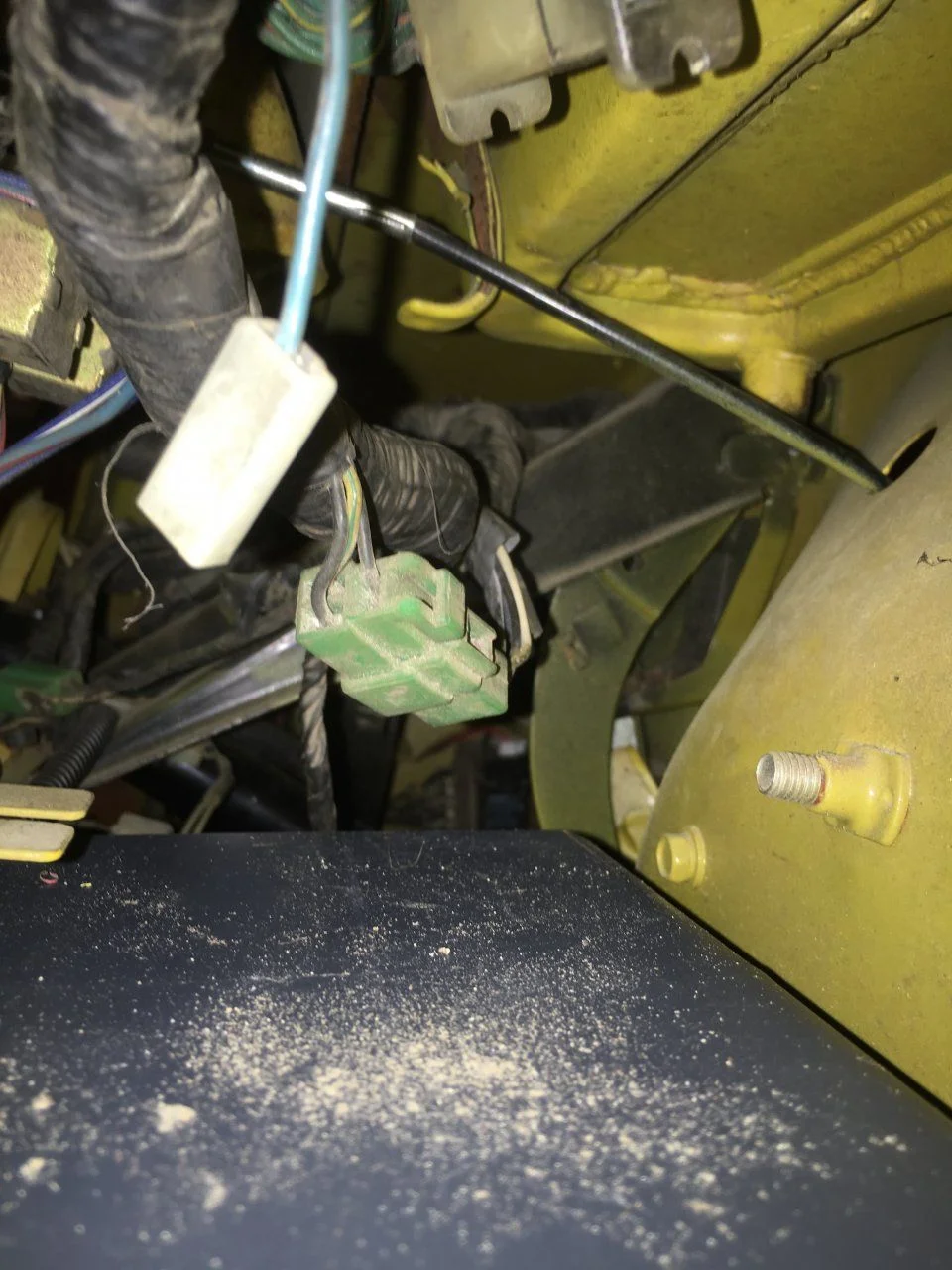

I think I found it Thanks...so much guys....Coolerman thanks for that piece of the puzzle....looks like it goes into a three way with two other black wires and 1 white wire. See picture If you look into the background you will see where it terminates look at the plug in the back ground that is the plug is fried where the white wire inters....this plug needs to routed out to the temp sensor.....but what are the two black wires for?

On my 77 I don't think I have a large green plug like your picture, behind the dash, except the one that goes to the steering column. I cant tell from your picture where that plug is in the harness. What number is the green plug you pictured in the diagram?

Interesting and yet puzzling guys...I see no other wires that could be the sending wire other than this three way plug......I do know that this is not my original harness as the original was all butchered.....What I do not remember is what year the harness was from as I replaced in 14 years ago.
Coolerman and Gcrump01....thanks for your input on this.....I guess and this point I can test this yellow/green wire and see if it moves the temp gauge. The wire is about 10 inches in length.....the other reason I think this could be it is the 10 inch lead turns to a a white solid wire as Coleman indicates.....it as has a nice burn mark on the plug which leads me to believe it was in the engine bay unplugged and it melted not he headers.
