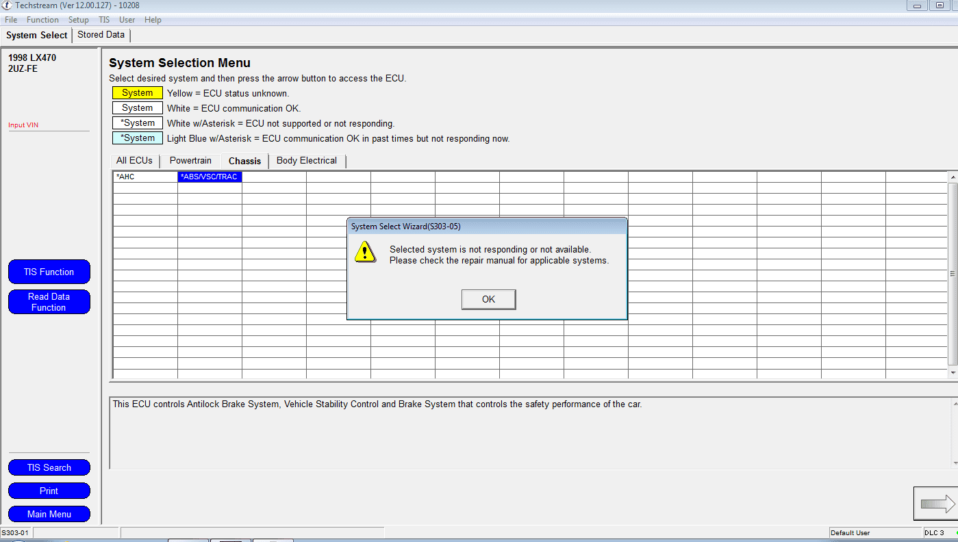

Hi there. I am trying to read my AHC pressure on my 1998 LX470 but I am getting the following message for any system (including the AHC) that I select.
Selected system is not responding or not available. Please check the repair manual for applicable systems.
It also changes the box from yellow to white; From ECU Status unknown to ECU not supported or not responding
I am plugging the cable into the OBD port under the dash in case that matters.
Any suggestions on what might be going on?
