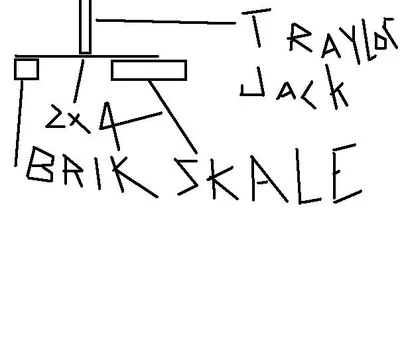

Side note on the bathroom scale thing. if you take a 2x4, and a couple bricks you can measure more than the scale can actually hold.
[ I have to apologize for the drawing. I started off goofing around making it intentionally bad to get a laugh out of my co worker, then after that was to lazy to actually turn around a do a real one... should get the job done though. ]
Basically, if the trailer is centered on the 2x4, the weight read on the scale is 1/2 of the tongue weight. if you say had a 4 foot 2x4, and were 1 foot from the brick, and three from the scale, the scale would be reading 1/4 of the tongue weight. so if you have a scale that reads up to 250 pounds you could measure up to a 1000 pound tongue weight.
