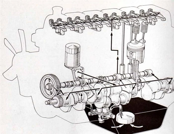

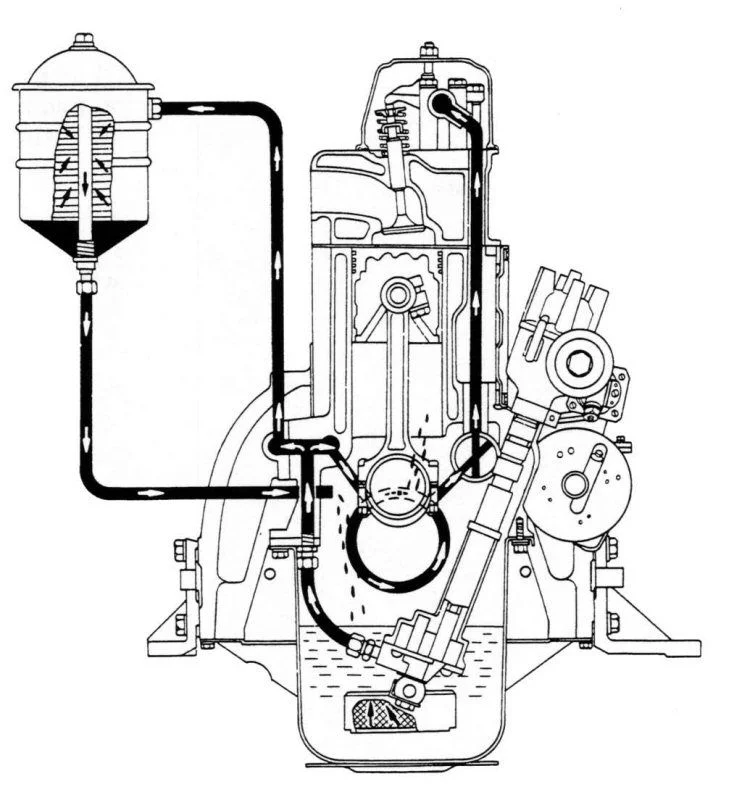

Howdy guys,
So I just picked up an F155 from Shane (Ruthless)... i thought I was getting a 2F but didnt find out until I got there to pick it up. Regardless, its a running motor that I can swap in.
My questions are what are the variations between the 2F and F155? Is the F155 considered an "F" motor when looking for parts??? Any sort of problems that a common with the F155 that I should be aware of?
I did find the info where the intakes are different.
Thanks for ya'lls help!
Scott
Think I remember this being the "transition" and the oiling is different. Read bout this in the past.
attachment.php
2F
attachment.php
https://forum.ih8mud.com/40-55-series-tech/163406-f-engine-oiling-question.html

Both are good engines, some folks are not fans of the 155 because of the oil design but if you put good stainless lines or comparable they are just as dependable. I was happy with both of mine. :)
