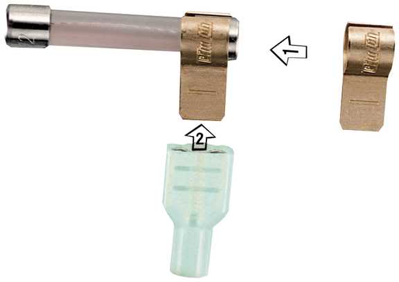

This is one way. I think my 77 had a spare circuit somewhere on the fusebox.

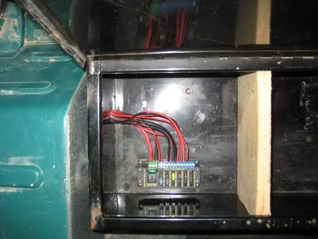

Here's how I did mine: I purchased an aftermarket fuse block with a relay built in, so that every position can be run either switched on and off with ignition, or always hot. I put the auxiliary fuse block in one end of my Con-Ferr tool box that sits right behind the front seats. The main power (the heavier wires on the left) goes straight to the battery, under the driver's seat and floor mat, through an existing hole/grommet in the firewall, along the top of the fender, to the battery.
^^^Yeah, something like that.
Learned something new. Still like my way better. ;)
