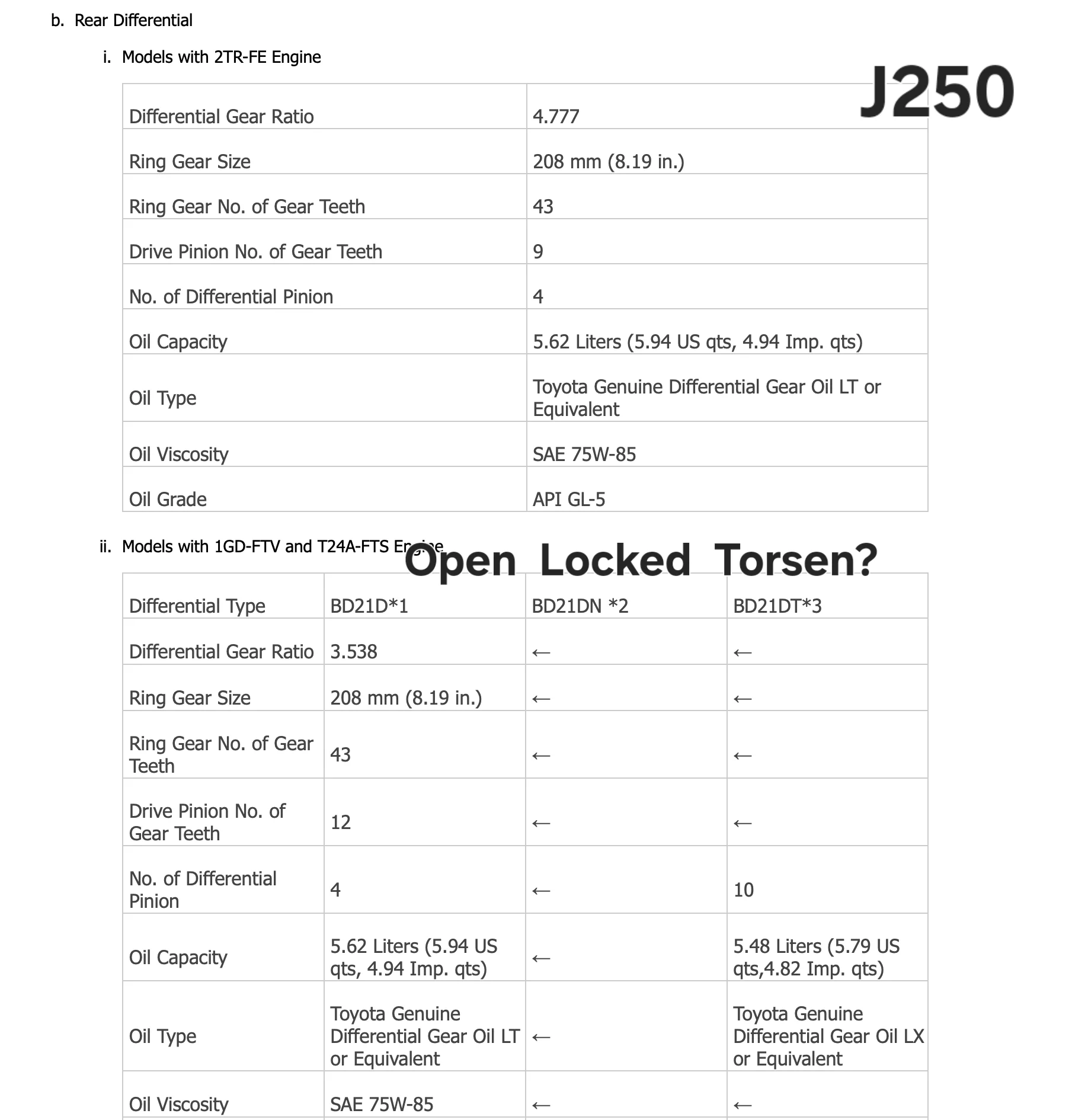

Do we know if the 1958 version with 245/70 tires has the same differential gear ratio as the models that come with 265/70 tires? Or does it have higher gearing?
Won't know until we see axle codes, I presume it's a slightly different ratio. I think LT275/70R18s are the ideal size for these as there is a ton of options in that size
Based from this all 8 speed 4 cylinder got 3.538 gear.

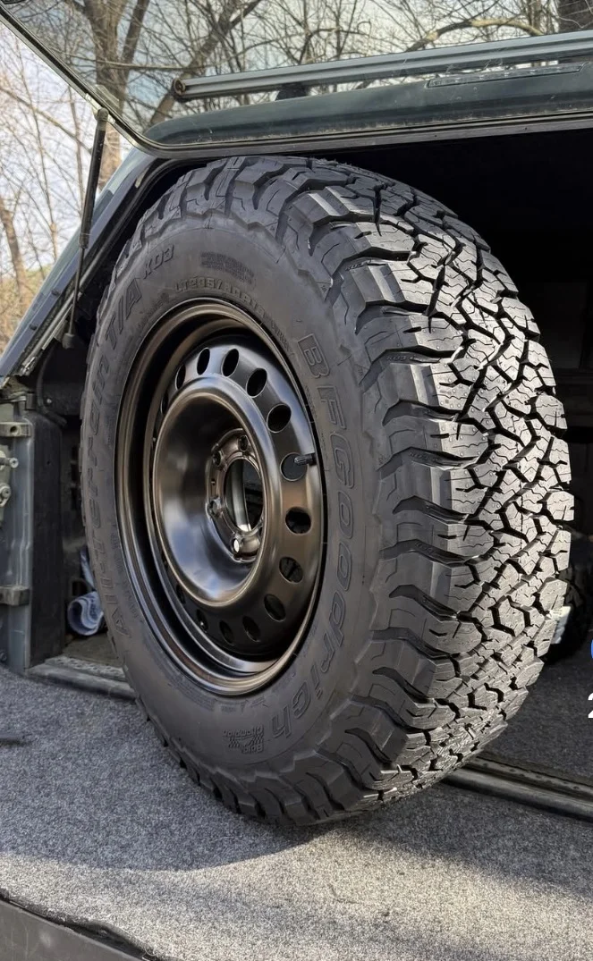

Noticed there’s another size available now for skinny 33s being 235/80R18.

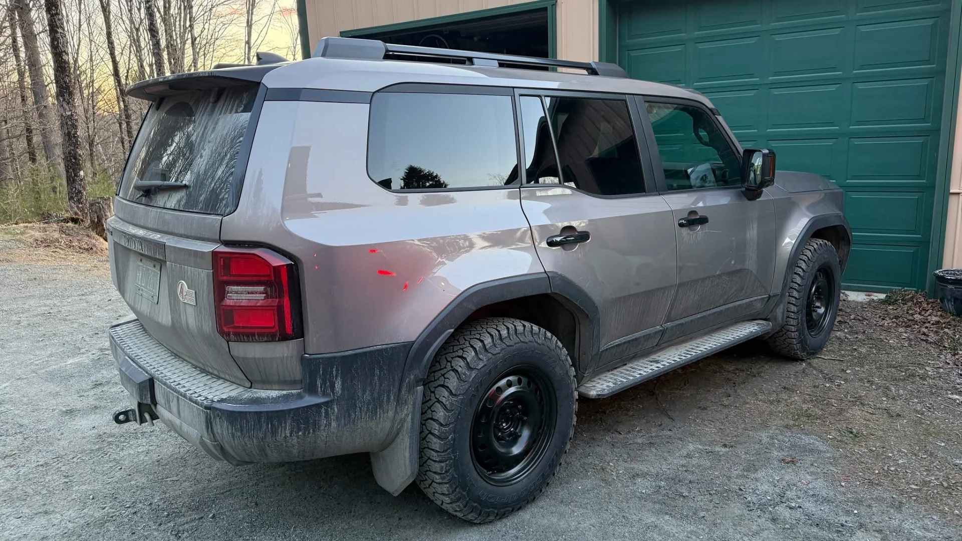

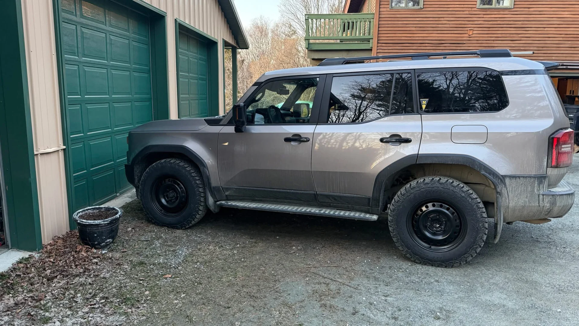

I found these photos on the internet of a 250 on steelies with the 235/80R18 BFGs. This size looks well suited to the 250. Too bad it’s E. I wonder how mileage fares.
I pulled the trigger on some pizza cutters for my 2025 1958 this morning. Put my full post here on this thread:
