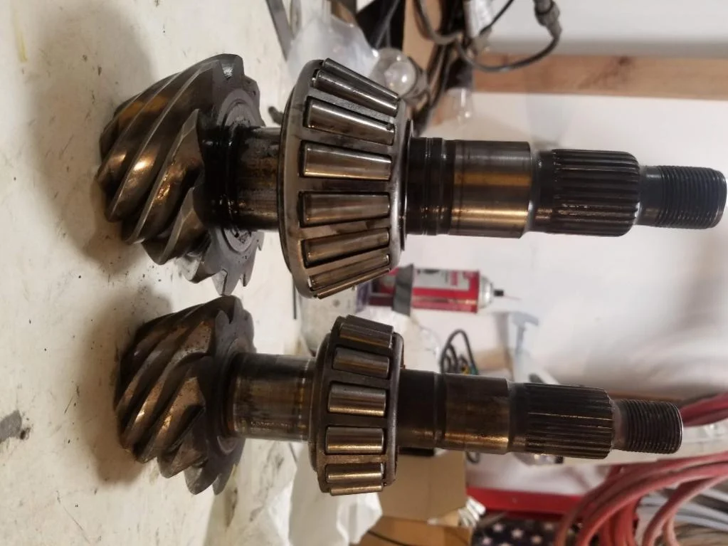

I do think the 8.2 would probably hold up okay, but I'd rather have bigger rear axle. 8.2 does seem to be fine with a supercharged 1GR and 35s. Should be stronger than the older LC 9.5s. The bearings and internals are certainly a lot bigger than the older 9.5s and 8" stuff. Below is a picture side by side on my bench of the 8.2 pinion left vs 8" right.
Do you think that the 8.2" vs 9.5" would result in a payload difference?
I have no idea other than just a guess. I don't think the axle is likely to be the limiting factor for payload. I think the payload on these is limited by tire pressure. As odd as that is - I think that's the factor Toyota uses. But it also at times is seemingly random. The Tundra hybrids with the 10.5" rear axle don't get a meaningfully increased payload vs the 9.5 (it's about 200lbs difference).
The axle rating on the door sticker for the 10.5 is 4150lbs vs 3860lbs for the 9.5 vs 3,450lbs for the 8.2 on the current 4Runner. But none of those seem to be very closely related to the payload or GVWR numbers. And the new 8.2 looks like a totally different axle. It's not a single formed sheet but at least 3 or 4 different parts welded together. It's possible (maybe even likely) that Toyota decided to change how they make the axle housings so they can vary the wall thickness depending on application. With the new design they could have 2 identical looking 8.2 axles with one being stronger than the other.
It's also possible that the new axles all share the same outer components like wheel bearings, axle shafts, etc. If that is the case, they might all end up with the same real world weight capacity and the only differences are in the differential its self as it's selected for torque rating.
The outlier here that I don't know how to explain is some years of the 5th gen 4Runner the rear locker models had payload cut in half to around 800lbs. But that was only the case for maybe 5 out of the 15 years of production. The rest had the same payload as all the others. Why? I have no idea. They all have the same parts other than the locker and all models have ATRAC, so the max torque on the rear axle should be roughly the same. And the Tacoma with the 8.75" rear axle has a lower rating than the 8.2 despite being a larger rear axle and a platform designed better for hauling weight. Stuff like that keeps the payload and GVWR numbers opaque to me.
