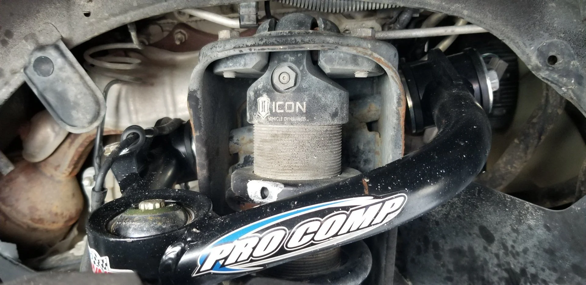

What's a quality lift for the FJ? What brand should I look for/look out for?
new uca.
icon suspension, traction control light is on....dealer said it's because of the 4 " lift?
Sounds like a dubious explanation. Pull the codes and see what it says. Dealer should have that capability in the service center somewhere.
apparently someone with bad credit tried to buy it (couldn't get financing) and had Toyota dealer inspect it. They told them the stored transmission codes were from running 315 tires on stock gearing, and that's why the traction control light was on. I do have a reader so I'll hook it up.
it actually drives really good, other than those loud ass tires. I crawled around all under and couldn't find any leaks. It has skid plates as well
A 4" lift without lowering the transaxle is supposed to cause issues, like a failing transaxle and CV joints. Also, didn't Icon have some issues with that specific UCA? Might be why it has new ones. You may want to ask if they are the upgraded version that doesn't wear out in 20,000 miles. And then there's the weird wear on the front tires: the lift didn't do the needed mod to move the lowers for making the alignment sane.
looks like a 2" lift. part of the deal was losing the 315s and putting on 285s. They are offering to get me 5 new falken wildpeaks in 285/75.
I crawled all under the truck and everything looks pretty good. No leaks or rust. CV angles seem pretty good so it must have a diff drop, boots looked good.
*ProComp UCAs
are the procomps ok or do I need to plan to swap them?
Those are good. I expected a spacer lift and stock UCAs. That FJ has a nice suspension setup (even if its old or needs rebuilt - may not). Point is, the owner put some money in the right place to get it to where it is and I would take that as more of a green flag. I bet the new tires will totally transform it and it will be a nicely equipped truck youll get your moneys worth from it.
The light is on likely because whoever replaced the UCAs maybe stretched or broke the little sensor wire that goes to the wheel sensor. I have had mine come on after working on the suspension, but I just unhooked the battery and it reset and never came back.
If it is JUST the trac control light, maybe it is just off? I think you can turn it off on those newer FJs?
