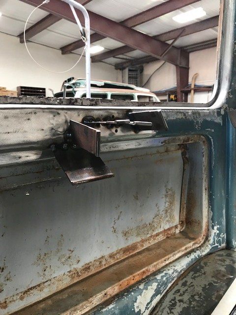

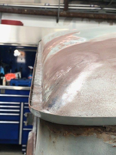

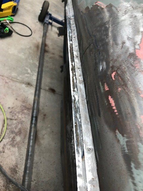

Wrapping up the last of the metal, approaching blast and epoxy.

I agree with Tancruiser; 3M Self-Leveling Seam Sealer (part#: 08307) works great. Primer any bare metal first, then scuff/sand the primer, and finally apply the seam sealer. That way it will look great and last a long time.
