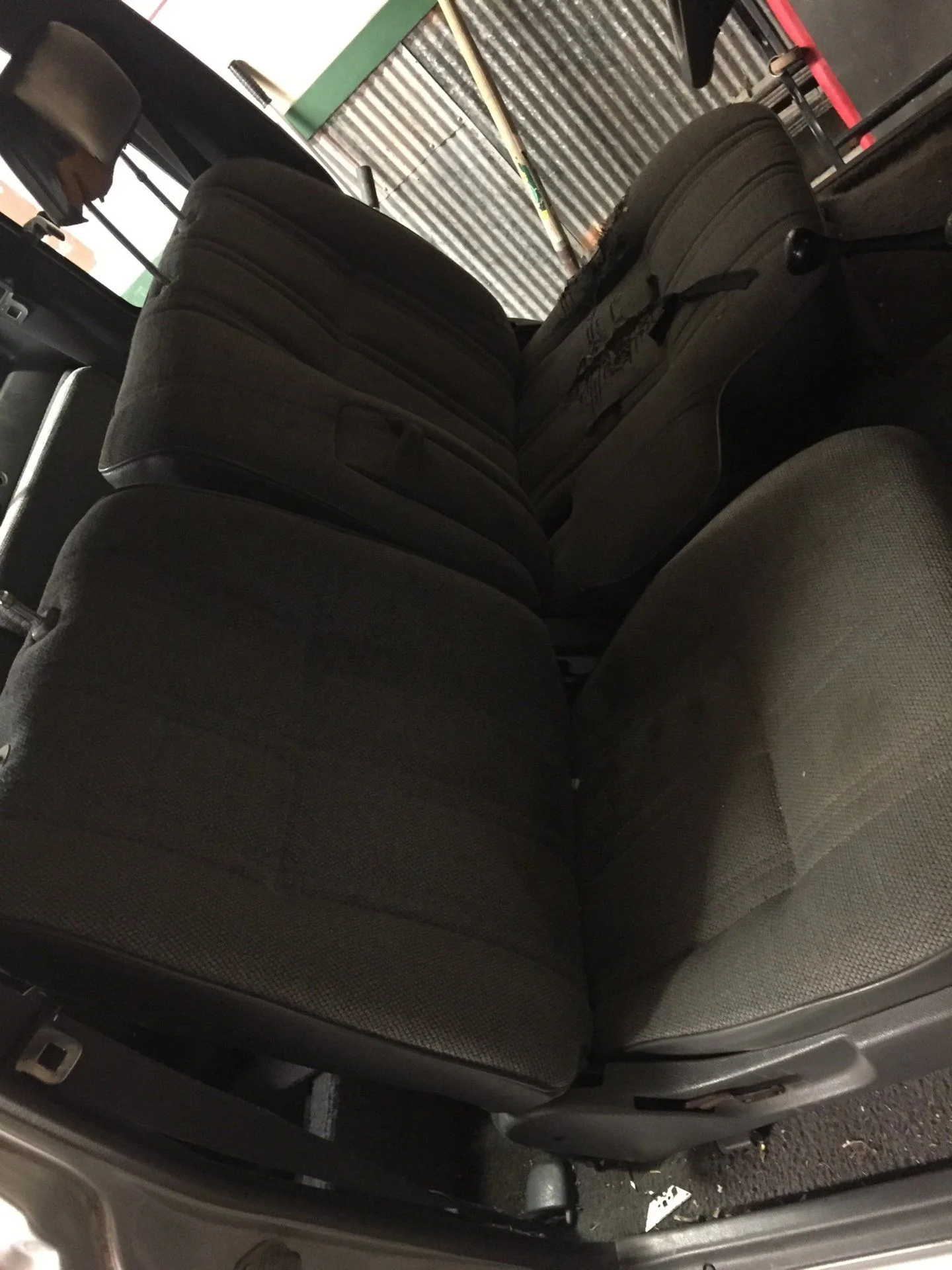

I was wondering if anyone has tried swapping an T100 bench or a similar bench seat into an fj60. The interior dimensions are very close, although I’m sure the rails would need to be modified. My bucket seats are in great shape but I’ve got a fetish for bench seats and the womenz seem to like them sooooo. :hmm: I am aware that you could get a split beach elsewhere in the world but I’d like to go with a solid front beach. Thanks!

I need find a t100 or tundra and take measurements. Unfortunately they’re aren’t many Toyota’s in junkyards, at least around here. I just went off dimensions I found online.
I am doing this same thing but I am going to use a 93 Pickup seat. The total width seat to seat on a 60 series is 53 inches. The total width of the 93 pickup seat is 49 inches. So 2 inches less on each side. I have not yet put it in there to check. One thing to think about is the parking brake lever. The pickup seat actually has a little cut out so I am hoping that lines up nice. I am having twins in August and in my current wheeler project I was I planning on having three kids in the back but plans change. Now I am hoping to buckle my oldest kid in up front. It may be too tight will see.

If you have an '86 or '87 60 and the dimensions work, it would not be too hard to make some kind of adapter. Earlier 60s have different seat mounts on the floor and you'd probably have to cut them out.

I am reviving this one in the hopes there is some updated info. I also have a front bench fedish. I tore the console out of the 80 before my last trip so my son could sleep across the front (in camp). I'm going to try and put a truck bench in, but I'm not sure the parking brake can be relocated... Maybe the 60/40 has a gap?
