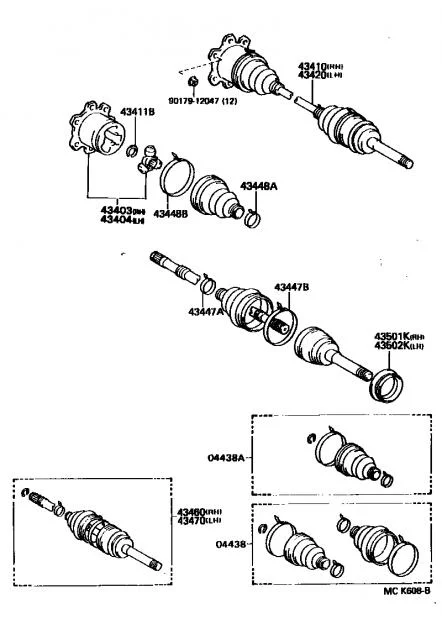

Huh? It seems to me that the term the FSM uses is indeed driveshaft as evidenced by this page I'll include a scan of. So much in fact that if you go into ToyotaTechDocs the page is called "FrontDriveShaft.jpg" !
