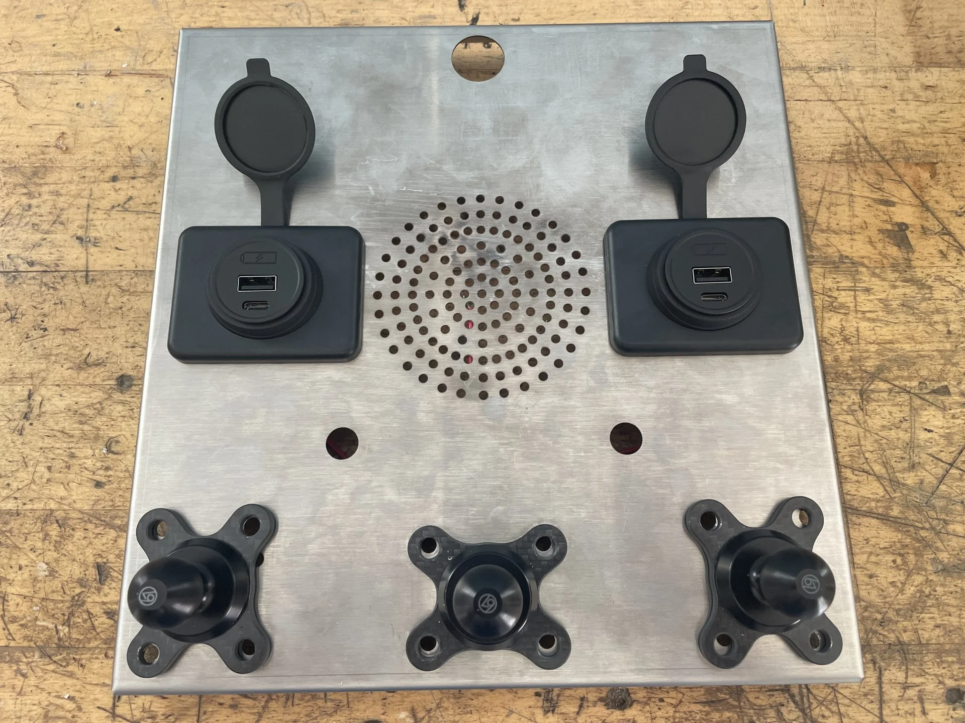

hopefully today - I can dig into the FSM and wiring diagrams to come up with a good target. I am trying not to run a million wire into the cab but may end up with a separate circuit for the dash area from a dedicated fuse box.
Right now I am only adding 2 USB's to power dash top devices mounted on the gamiviti panel, but that can always expand. but I will have 4 ports as long as the sockets are ok (I am iffy on the amazon socket quality.... but we will see)
Mockup of the panel before I powder coat it
