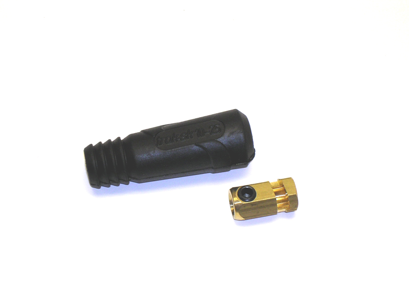

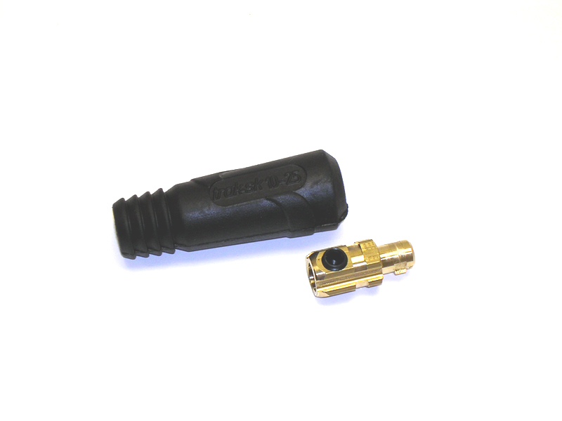

use a solenoid in between the battery and the winch with a low volt line into the cab to a toggle and a relay. That is how the old cable control winches work and solves all your problems.
Usually a cam-lock connection. Picture connecting two runs of say #4 cable together via a male and female twist-lock connection.
See the following:
http://www.perfectswitch.com/images/accessories/femaledinse.jpg
http://www.perfectswitch.com/images/accessories/maledinse.jpg
I would use two males and two females.
From winch run #4 cable and terminate with female.
From battery positive, run #4 cable and terminate with female.
As the females are insulated, no way to short.
Use a "patch" cable, terminate both ends with males and shove in your winch accessory bag. When you want to winch, insert patch cable to bridge the battery to the winch.
We use an Italian manufacturer called Trafimet. MUUUUCH better quality than Tweco and engineered so that as the connectors cam twist into position, it draws the connector faces into contact so you get the benefit of tremendously more surface area contact. More contact = more efficient and less power being dissipated as heat.
You can find this kind of connector from your local welding shop, though they probably don't carry Traffimet.
Food for thought.
Sounds like a good idea-- but I don't know "welding quick-disconnect" is-- can you tell me more?
