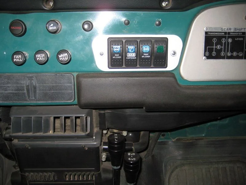

anyone know who’s this is, or know anything about the bracket for mounting switches in the radio hole in the dash?
I found this pic in the expedition threads, unknown owner in the thread, pic was saved for reference.
It is a pretty clean install.
You bet man glad i could help. i saved many pics from his build he does some awesome work.
Definitely some of the most detailed work I’ve seen here from a private build.
Just FYI, Proffitt's used to make one of these for the ash tray space; not sure if the new company still does or not. I bought mine before they went tits up. Of course, you'd have to give up your smoking habit.

1. These are their modular mounts for making your own bracket. They have an end bracket, and a middle bracket that you put together to create your preferred sized opening. I think 2 ends and 3 middle's fit the Radio-sized FJ40 hole pretty well (may need a zip tie behind to stop the wiggle - see #2 below, I can't remember which one I read about but someone had either #1 or #2 and used a zip tie to make it "good"). This setup pictured above looks like it is a Carling V series bracket.
- https://www.carlingtech.com/sites/default/files/documents/V-Series_Details_&_COS_111213.pdf (see page 23 for the brackets).
- Currently, in Nov 2022, WaytekWire.com has the brackets and switches: P: Search: carling vm - https://www.waytekwire.com/products?pSearch=carling%20vm (I searched for "Carling" and "vm"). They also have a cover plate for blanks, and the switches to add to these.

@Vae Victus …these are modular. I bought two of them. Added a single switch holder to the panel of 6 to make a total of 7. It fits perfect. Needed a little massaging to get it to fit. The edges tuck nicely under the dash pads.
In my situation I would only use the middle 5.
